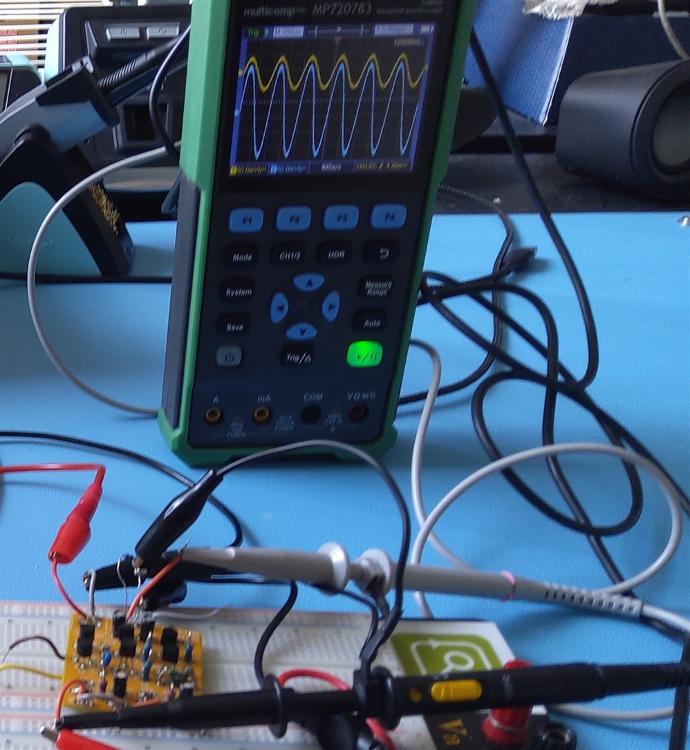

With the shopping cart I won in a project14 month, I ordered a handheld oscilloscope. In this post: my first impressions.
I 'll focus on using the instrument the very first time as a handheld test instrument. I will not review software, specs, competition.
If you have an Owon HDS200 series instrument, you can follow along. It's the same.
3 instruments in one
I have an MP720783 . A 70 MHz 2 channel oscilloscope, a DMM and function generator in a package that has the size and weight of a DMM. The 3 instruments can operate at the same time, but only one has the screen and buttons active at a time. You can use the function generator to serve an input test signal for your design, then use the oscilloscope and DMM to probe your design.
Overall look-and-feel is good. The buttons feel good and the display readability / clarity is good. Connections (except USB) are easy to get at. And there's a stable stand (if you dare to open it beyond the scary click position). I prefer to use the stand, because the reading angle is mediocre.
Overall first impressions are good, for all 3 modes. Using the instrument as a basic scope, generator or DMM is easy and intuitive. You can learn this in minutes, if you have previous experience.
Beyond that point, the interface gets more complex. The options are logical, not annoying and comparable to what other advanced instruments do. But at this point, the instrument is not as intuitive as a well designed bench instrument.
Being handheld, the instrument has an options that some bench instrument don't offer: (safe) isolation. The DMM is fully isolated, as expected. But also the oscilloscope and function generator aren't ground referenced. This can be an asset.
Be aware though, that the generator output and oscilloscope channel 1 + 2 grounds are common. And that both are also common with the USB connector shield. The instrument gives you safe options (CAT II) to do isolated probing. But you have to bring your brains to the party.

Oscilloscope
This is the only relevant section you should care about. You'd get this instrument for its oscilloscope functions.
Two channel, 70 MHz in my case - there is a 40 MHz version too. The usual channel options are available:
  • probe x1 -> x10000
  • AC / DC coupled, GND
  • bandwidth 20 MHz / full
  • time base from 10 ns to 500 s
  • 10 mV to 10 V / div
  • Sample and Peak Detect mode
  • X/Y
Measure
  • 7 measures (6 visible at a time across 2 channels), and a hardware counter
  • cursors (CH1 or CH2 vertical, or time)
Trigger
  • auto, normal, manual triggering and force
  • rising / falling edge
  • AC / DC coupled
Varia
  • sample depth (4K / 8K)
  • store wave form or screen print
  • auto
Overall look, feel and use is easy. You get a common signal on the display as fast as you would with a bench instrument. Scaling and moving X and Y are a bit more involved.
It gets harder (compared to a bench instrument) when you want to zoom in to a part of a captured wave, or trigger on more advanced scenarios (there's no hold/delay or external trigger). The functions I use in my day-to-day probing are available.
Signals are clear on the display. The annotations on the screen are easy to read. Refresh rate OK.
