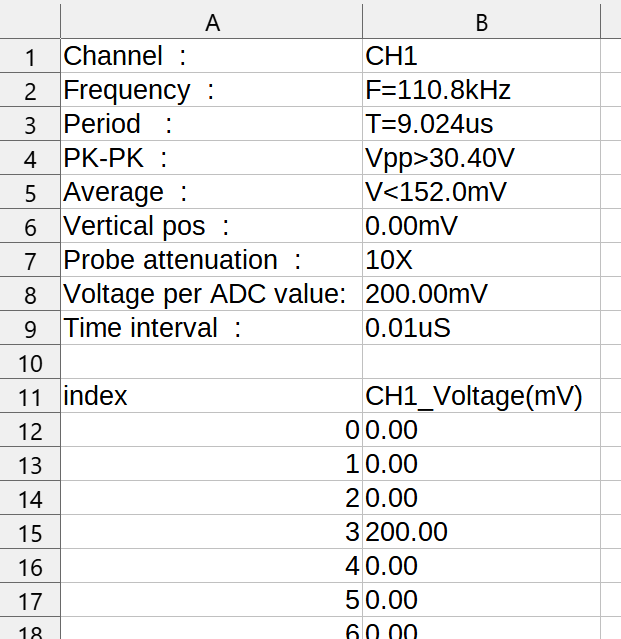

CSV
The waveform of the selected channel is stored, with the settings in the first 10 rows, and - in my case with the acquisition set to 8K -8000 data points.
The image at the top of the post shows a graph made with the data of a stored waveform.
