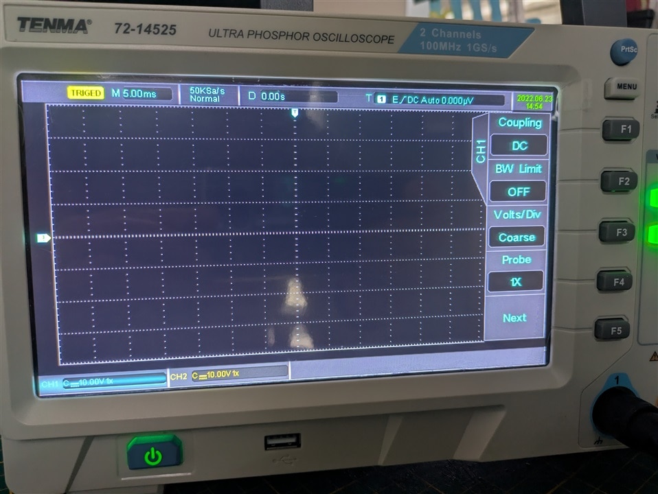

Hi everyone,
On my Tenma oscilloscope, i have no trace for both channel.
The probe works fine, but nothing on the screen
Can someone help me?
Where can i find the lastest firmware for the oscilloscope 72-14525
Contact technical support of Farnell, he can't help me...
Thanks,

  • duquep
    0 duquep over 1 year ago in reply to kmikemoo
    Hi,
    Thanks for your reply :-)
    I have no sound at startup.
    When i said that there is a black screen, it means that the display is ok, but i don't see ani curve on the display.
    The run/stop button almways stay in green mode. Not red mode :-(
    If you can the procedure to make a Hard Reset, i will be happy.
    Tanks for your help
    Philippe
    0 shabaz over 1 year ago in reply to duquep
    This might need some photos if not a quick video just to see if anything can be spotted just to eliminate operator error. Could you record with your mobile phone, a photo of the display of the device? A video would help (showing how you're setting to default, and how you're applying a test signal using the built-in probe compensation test point).

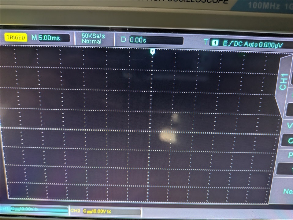

  • duquep
    0 duquep over 1 year ago in reply to shabaz
  • duquep
    Hi,
    Nothing change :-( I posted somes pictures and a video, maybe can help-meN
    0 Jan Cumps over 1 year ago in reply to duquep
    Are your probes on x1 position?
    (Set trigger to auto)
    Turn intensity to max .
  • duquep
    0 duquep over 1 year ago in reply to Jan Cumps
    Yes, probe on x1 position, trigger auto, intensity to max, but nothing on the display :-(
  • Anthocyanina
    0 Anthocyanina over 1 year ago in reply to duquep
    have you tried to get data off the scope? to see if acquisition is happening but not display. i see in some photos you shared that it says "triged". so maybe if you stop acquisition while it says that, and try to save to a usb, you could confirm if acquisition is really running and just not displaying the data
