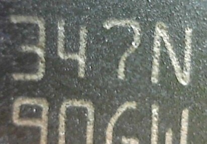

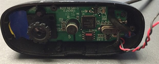

    rsc over 10 years ago
    My phone takes a good pic, but when i need a good close-up, I use a Logitech webcam that i removed the cover so i can adjust the lens down to microscope levels.
    I added connections to the USB 5V so I can add LEDs for extra lighting around the lens if needed
    Here's a close up of the lettering on a 14-pin LM347N DIP
    Scott

    jw0752 over 10 years ago in reply to rsc
    Hi Scott,
    Pretty good quality and a nice inexpensive solution for closups.
