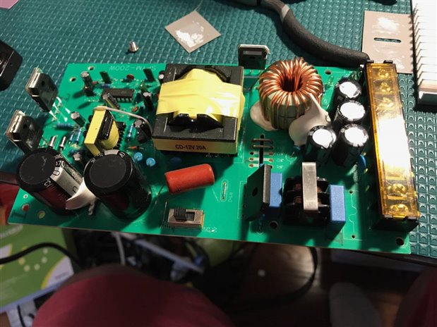

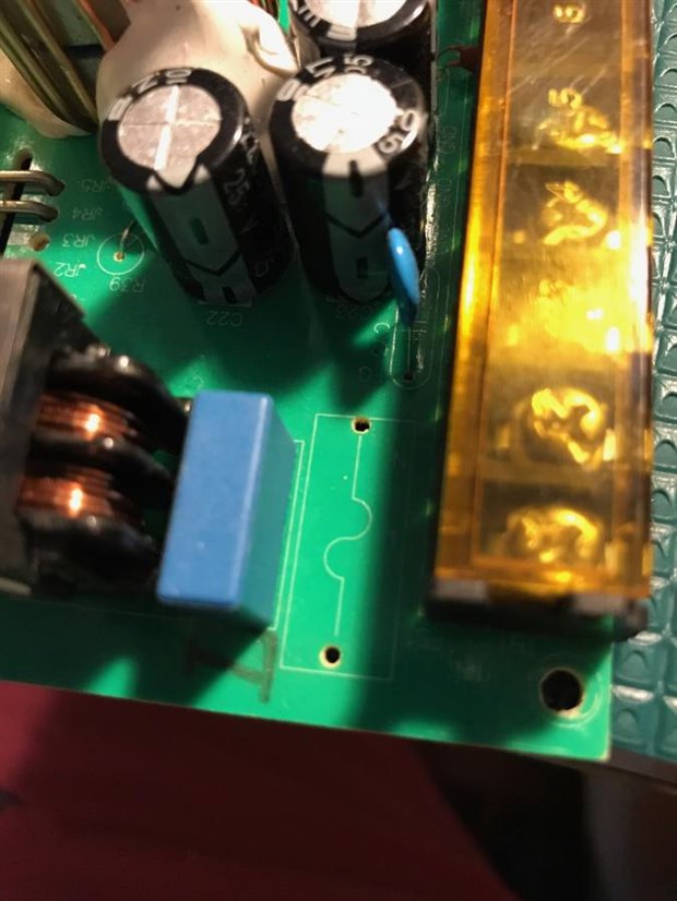

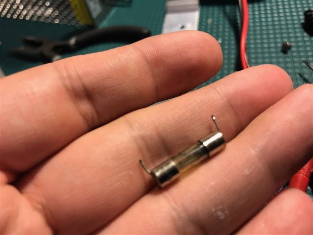

My friend at work built a 3d printer from a kit and his power supply went out. He said it made a pop noise and got no power from it. He ordered a new one already and gave me the old one and I would like to try and fix it.
Once I took it apart the first thing i saw was a fuse that looked blown. I got no continuity on the fuse from my multimeter. I unsoldered the fuse and the writing on it looks to be P5AL 250v or F5AL 250v.
1) is there anything else you guys can recommend me testing or looking for.
2) I found this on amazon it looks to be the right fuse but can I solder leads to it.
https://www.amazon.com/BUSHIBU-F5AL-Fast-Blow-Glass-Fuses/dp/B01NAQH2TB/ref=sr_1_2?s=industrial&ie=UTF8&qid=1496014763&sr=1-2&keywords=F5AL+250v
3) do you think I can put a holder on the PCB incase it blows again it would be easier to change. I attached a picture of where it was on the PCB.
    jw0752 over 9 years ago +5
    Hi Giovanni, If you want to solder leads on the new fuse here is a procedure that I have used. File each end of the new fuse so you can see brass. This makes the solder adhere better. Use a hot iron and…
    mcb1 over 9 years ago +5
    The supply pictured is a switchmode supply, and the fuse has definately gone bang. As jw0752 said it has lethal voltages and the first stage they rectify the mains voltage, filter it and then chop it to…
    As jw0752 said it has lethal voltages and the first stage they rectify the mains voltage, filter it and then chop it to arrive at the final voltage, or voltages.
    Replacing the fuse is the least of your problems, you'll need to test some other parts to find died and took out the fuse.
    I was shown a really good trick for testing switch mode supplies.
    if you wire the mains through a 100-150W lamp, if there is a short, it will light the lamp, rather than creating minature explosions and causing more damage.
    Obviously some care is required, but the idea is the lamp is in series with the phase and can be achieved using a simple box with a lead and plug at one end, and cord socket on the other end.

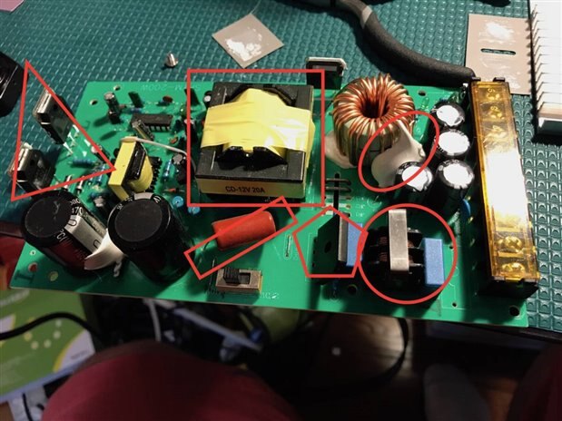

    gio_dude over 9 years ago in reply to mcb1
    Ok so not as simple as I would have liked it.
    Thank you everyone for you advise. I not sure I'm going to use this power supply again because I still don't trust my self yet with lethal voltages. I am in the USA so its 120v but still kind of scary.
    I would like to continue testing it even if I don't plan to power it up since I have already learned some much from just the one post. Sorry I'm very new.
    from what I'm reading I need to test most of the parts out of circuit. So before I start desoldering and getting confused I would like help identify parts because I'm still struggling with that a little.
    Triangle = spym 13009 mx38 is written on it. google says its a switch mode transistor is that how you guys are able to identify that the power supply is a switch mode one.
    square= ? not sure what this is.
    rectangle= says cv 400 b275jq on it
    oval= what is this goo its also near the caps on the left
    pentagon= has four pins + AC - is this the bridge rectifier?
    circle = not sure.

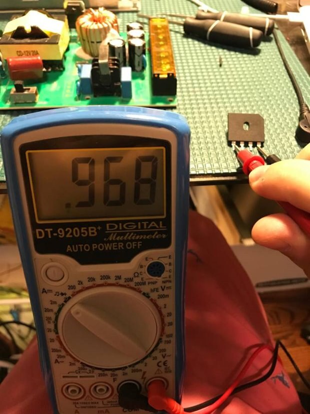

    gio_dude over 9 years ago in reply to jw0752
    Dab I agree probably easier to scrap it and buy a new one from all the post here and knowing my skill level I probably won't be able to fix it. this is more a learning thing at this point and boy have I learned a lot from these post.
    John thank you so much for the explanation of the parts that helps me put proper names for me to do more research and learn more about those components. I have a digital multimeter still learning how to use it.

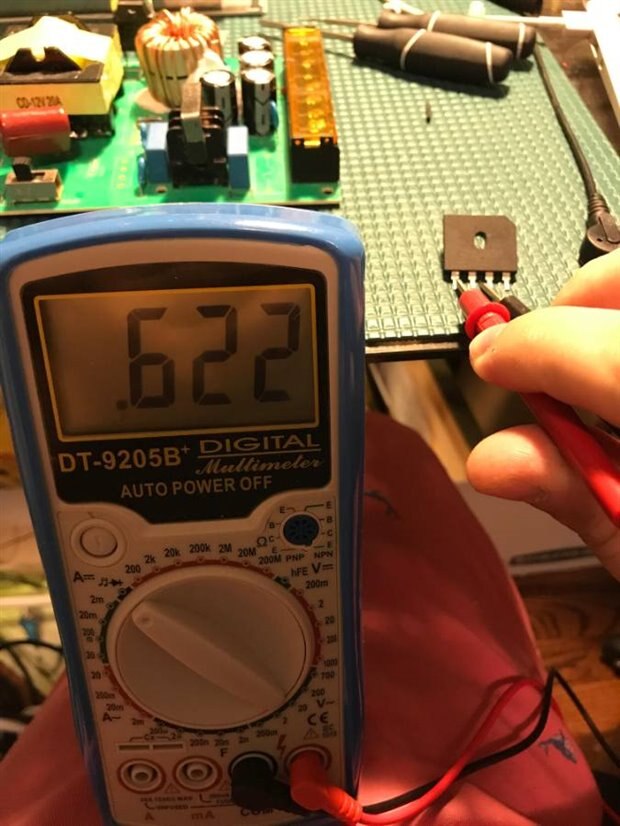

    I removed the bridge rectifier and tested it in diode mode with the black probe on the minus pin i get nothing touching the red probe to each pin. when I put the red probe on the minus pin I get around .63 and .62 on the middle ac pins and .97 on the plus pin.
    the part behind the transformer says spym 30100 the it has a picture of two arrows going into each other with parallel lines in the middle.
    all this power supply has been sitting for about two months unplugged and unused I understand there is a risk to what I'm doing and i'm trying tot red lightly. I don't plan to power this unit unless I feel extremely safe.
    Thank you
    Giovanni
    jw0752 over 9 years ago in reply to gio_dude
    A little follow up.
    The white glue is just for stabilizing components that do not have good mechanical attachments. The power supply may be used in an environment with lots of vibration and this keeps the heavy components from breaking loose.
    The Triangle components SPYM 13009 are not MOSFETs as I said before but switching NPN transistors as you mentioned. Incidentally these are similar transistors to the ones that are commonly used in the switching driver circuits of the common CFL (compact Florescent lights). The configuration of their leads from left to right are likely: Base - Collector - Emitter. Check between the Collector and Emitters for Shorts.
    Take general sequence of the circuit begins in the lower right corner where the AC power attaches and then works it way around the edge clockwise until the output attaches to the screw terminal at the upper right of the board. The circuit likely has current protection on the output so the most likely place for failure will be in the circuit along the lower and left edge. Once we get to the transformer and after failures will probably not blow the fuse but just shut down the switch. This is speculation as I can not do more than guess at the actual circuit without seeing it.

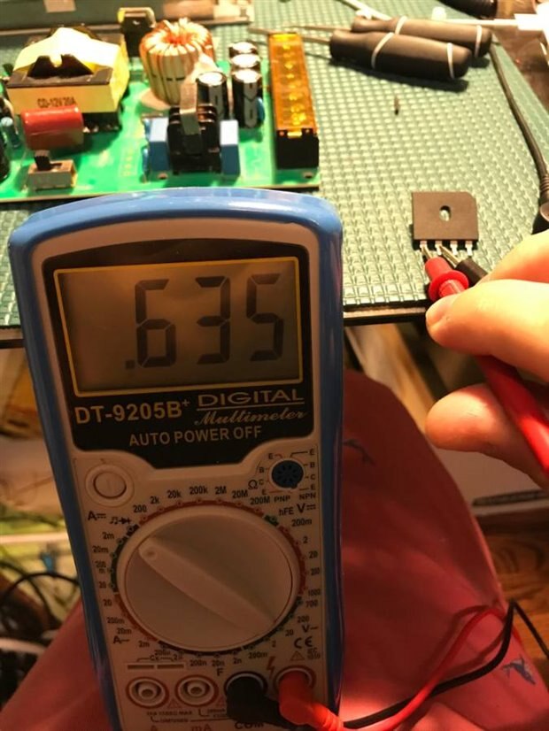

    The bridge out of the circuit should give OL on the connection of the meter between the s and s. Between the plus and each s with the black probe on the plus you should get OL. If you put the red probe on the minus you should get OL to each of the s s. This assumes that the test polarity of your ohmmeter  circuit is like most of the meters I have seen.
    When you read your meter make sure you are aware of the "K" or "M" that may be displayed as these can drastically change what the numbers indicate.
    .63 is basically a short.  .63K is 630 ohms and .63M is 630,000 ohms. If you indeed got .63 ohms when you tested across the AC (ss) terminals then the bridge is bad and probably caused the fuse to blow.

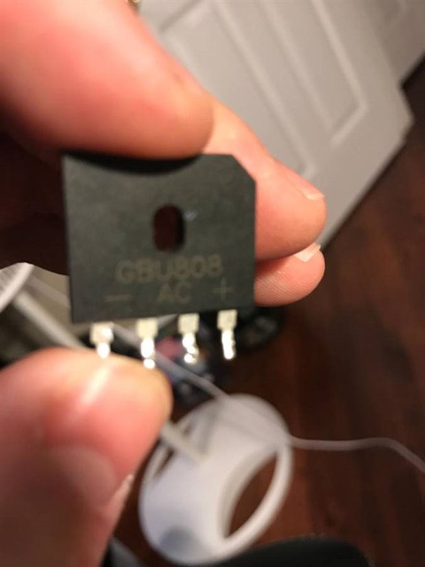

  • gio_dude
    Thank you I was wondering about the glue that makes sense now
    I attached some pictures of readings and the bridge rectifier mine doesn't have a tilde (side ways S) it just says AC which makes sense since that is the symbol for AC.
    my multimeter isn't auto ranging and after today I'm considering upgrading it.

    jc2048 over 9 years ago in reply to jw0752
    Giovanni is using the meter on the diode setting, so the reading is the forward voltage.

    jw0752 over 9 years ago in reply to jc2048
    Hi Jon,
    Good catch. After I turned off the computer and walked away it dawned on me that he was using the diode test and not the Ohmmeter. Always difficult to trouble shoot with limited access to info.
    Hi Giovanni,
    Based on your pictures it looks like the Bridge is OK. Just be sure you can get approximately .62 Volts from the plus to each of the AC and from the minus to each of the AC. The information I gave you before was based on the assumption that you were testing the diodes with the Ohm meter set on Rx1.
