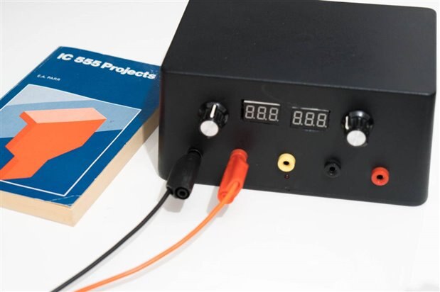

    shabaz over 8 years ago
    Hi Flemming,
    There are schematics (and board CAD files as soon as I upload them - let me know if you need them anytime soon) for a dual-rail supply here:
    Building a Linear Power Supply Module
    It is fixed voltage, but can be made adjustable by swapping R2 and R6 out for variable resistors (and put a small resistance in series with them too).
    If you need some help figuring out the values, let me know.
    It is only a 200mA dual rail supply, or optionally 3-rail.
    I created it for future op-amp and headphone amplifier projects, so it was intended to be a fixed rail supply.
    If you wanted something with through-hole components, there is nothing wrong with a LM317 supply by the way, it will still serve you well.
    I have an old homemade LM317 supply myself (I used a couple of LM317, for dual output), and I still use it.
    Photo here next to a paperback book for size comparison. I didn't do a great assembly job.
    Also if you search for jw0752 content he has blogged about some power supplies he has constructed, so you can see some ideas for how to build them.

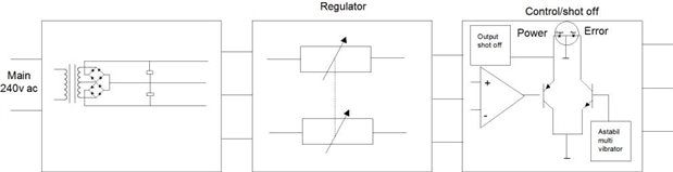

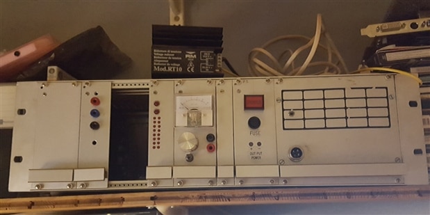

    Thank you for the reply.
    I am ahead of you
    I got a 2*15 V, 0.5 Amp. ring transformer, 1 amp. rectifier bridges and large capacitors ( might be too big ), the case would be part of a 3 unit high 19" rack case from Shcroffimage
    so must of the exterior is sorted
    Volt and amp. meters is necessary, not sure what i use, depend on the space on the front panel.
    The concept is just about planned, even a multi funktion power indicator.image
    I have been looking around at other homemade power supply, one thing is a puzzle to me, why do you all use small knobs for your adjustment, it's much easier to control with a BIG knob.
    The most important part is missing -the regulator circuit
