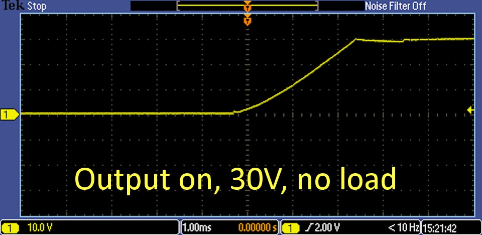

    shabaz over 7 years ago
    I did some initial measurements, and it's very good : )
    I did the measurements at 5V (since that's a popular voltage!) and at 30V.
    5V set voltage:
    At no load, the output was 5.0088V, and at 3A load it was 4.9969V
    30V set voltage:
    At no load, output was 30.039V, and at 3A load it was 30.029V

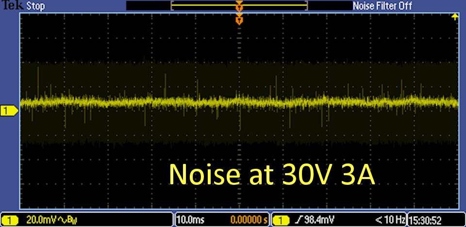

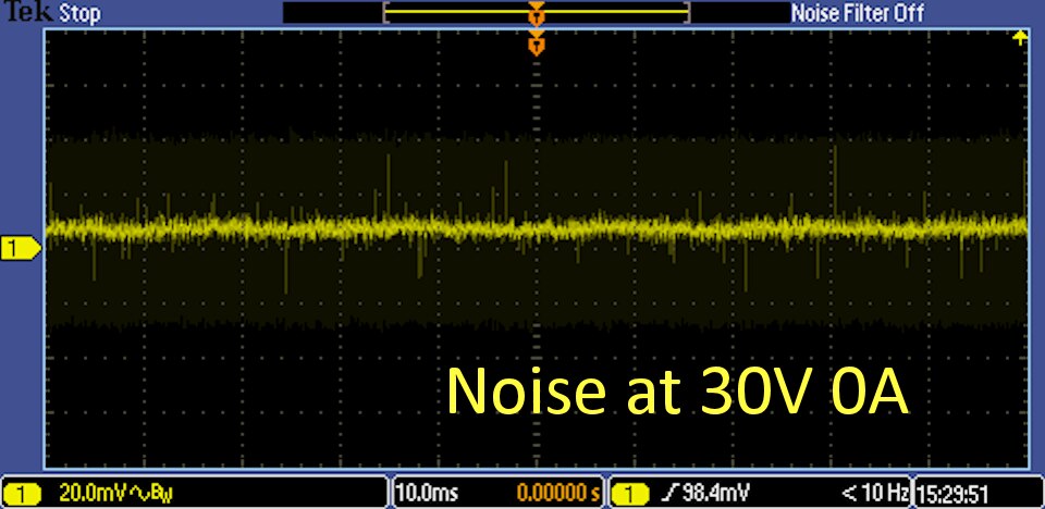

    So, set voltage is spot-on, and it seems to handle the max current fine too. Noise was low, I couldn't observe any ripple.
    This is noise at 30V with no load attached, and 3A load  (there is some faint garbage just visible on the trace background, but some of that will be due to scope probing, and some of it can be removed with a ferrite):

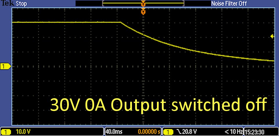

    Switching the output on (i.e. power supply is already on, but output is off, and it is switched on via SCPI), with no load attached:
    Switching it off:

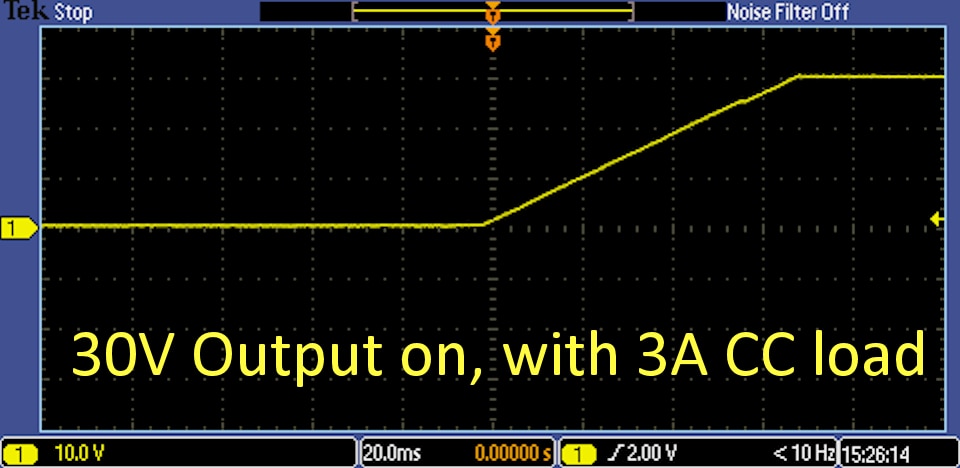

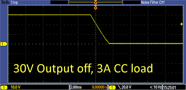

    Tests with a constant current load attached:
    Next I tried the same thing as above but with a 3A constant current load attached:

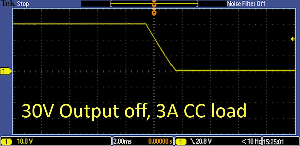

    And switching the output off:

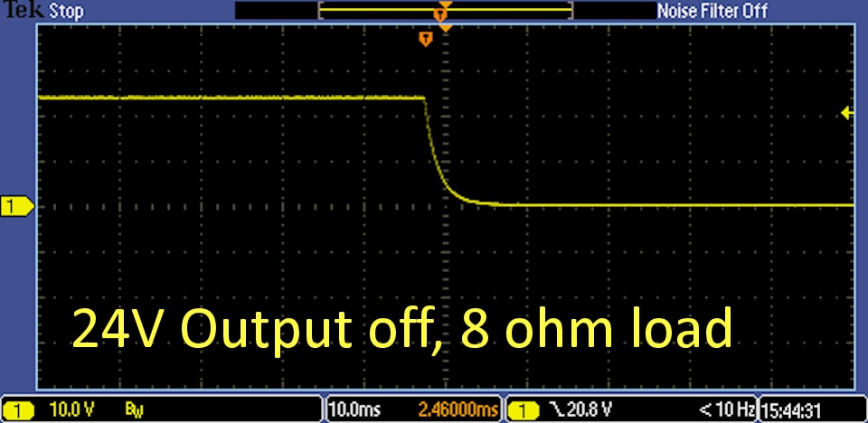

    Tests with a resistive load attached (home-made load, Building a Miniature 300W Speaker Simulator  ):

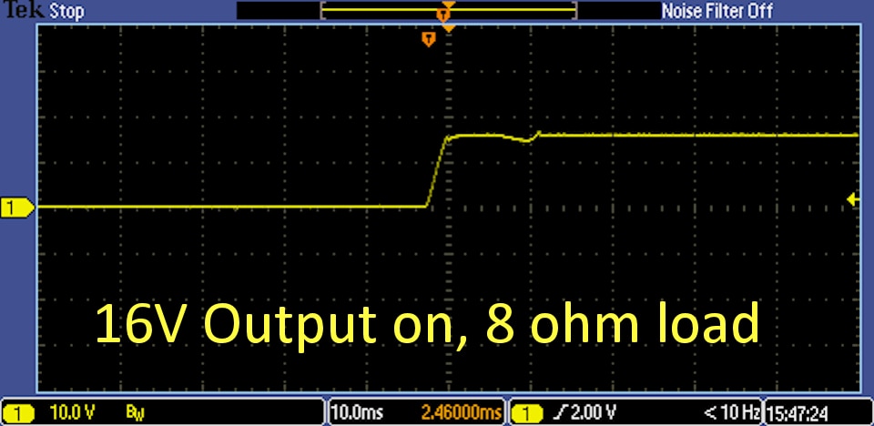

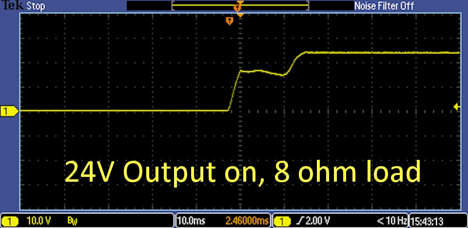

    I set the supply to 24V and attached a 8 ohm load, so that the expected current was 3A. I switched the output on via SCPI:
    As can be seem, there was an anomaly just after 15V or so. Maybe it is switching ranges there, since maybe the time period seems consistent with typical relays switching. Still, this looks great, no overshoot, and the output is flat within 20msec or so.
    Here's the output switching off:
    That anomaly at switch-on happens at different voltages too, down to about 15V. Here it is at 16V:

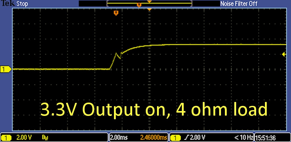

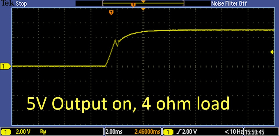

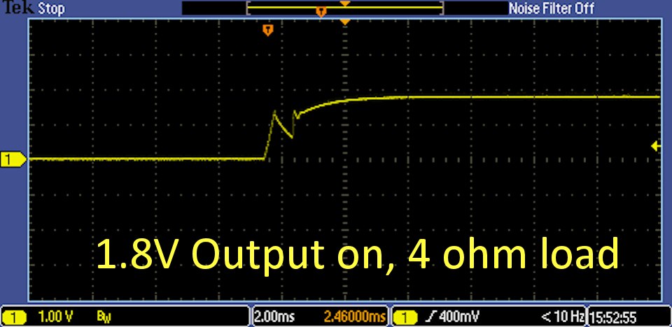

    I then set the load to 4 ohms, and set the supply to 5V and switched the output on via SCPI. Again, no overshoot, and output was flat within milliseconds:
    I tried lower popular voltages too, like 3.3V:
    and 1.8V:

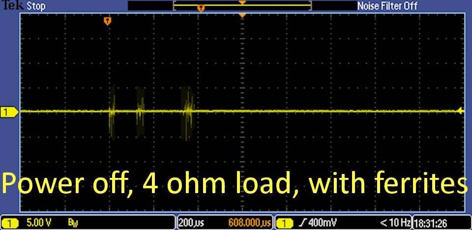

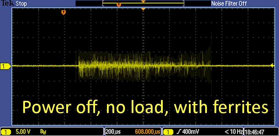

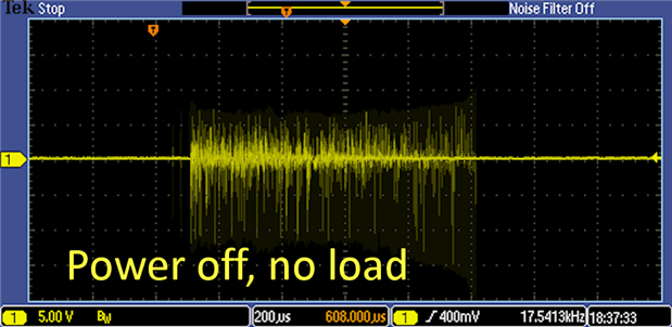

    Power off/on glitches
    If the supply is powered on or off, sometimes there is some output visible.
    Here it is powering off. This was the worst-case I could capture. Most of the time, it was less than this, but (say) 5% of the time switching off, I saw this:

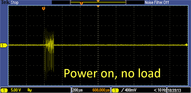

    Powering on produced junk for a shorter time:
    Adding the largest ferrites I had (not very large - one was about 1 inch OD and 0.5inch long, and the other was about 1.5 inch long and 3/4 inch OD) to the output wires, improved things a lot.
    With a load attached, it's better:
