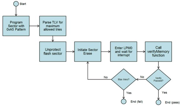

Calibration data has to be kept, also when the instrument is powered down. The MSP432 we're using has user Flash for such purposes.
The MSP43x drivers have functions to program it.

Writing and reading the data is done in a helper function. They are in a demo state now, to check if I can get this working.
Check the MSP432 datasheet for the relevant Flash memory area.

First, it detects if there is a valid calibration record. It does that by checking if the signature of the persistent calibration area is valid. It checks if that area starts with "eload".
If that is not the case, the firmware decides that you never stored any calibration data, and fully initialises the record. All fields get a default value.
    EEPROMRead((uint32_t *)&_CalibrationData, (uint32_t)(CALIBRATION_START),
               (uint32_t)CALIBRATION_DATA_SIZE);
    if(strcmp(_CalibrationData.code, "eload")) { // check if code == "eload"s
        calibrationErase();
