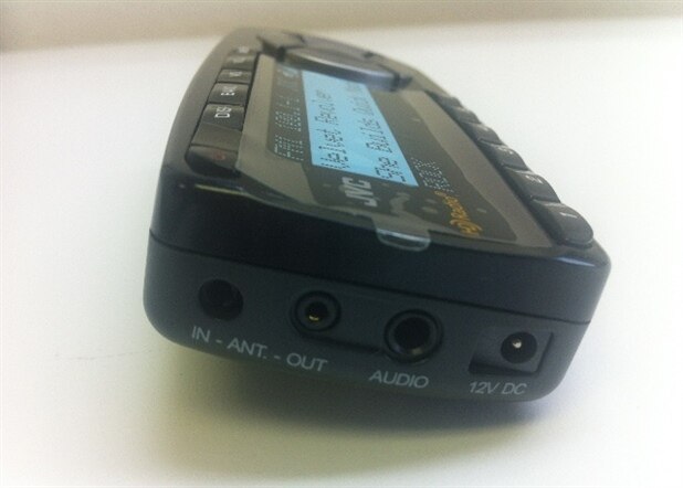

The connectors were unusual sizes, except for the headphone output.  None of the connectors I found on Digikey fit.
The antenna out port is for retransmitting the received signal in analog FM on the frequency of your choice.

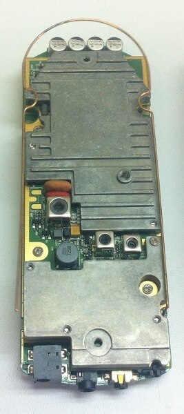

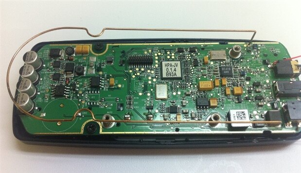

Inside the unit there is a user interface board and a receiver board.  The receiver board has a metal can that appears to function as a shield and heatsink.  The can is attached by screws, no solder.  It gets hot to the touch after a few minutes.  I suspect most of that heat comes from the TI DSP.
We soldered a two-meter wire to the RX antenna port.  The radio picked up no stations on AM and only the analog portion of FM stations.  The digital subcarrier is 20dB down from the the FM, so HD radio only works with strong stations.
We soldered another two-meter wire to the TX antenna port.  A trace going to the TX port also goes to a matching network connected to a metal antenna, perhaps making the external TX antenna optional.  With a wire on the TX port, the radio began receiving many more stations, including some HD signals.  It’s unclear why a wire on the TX port improved receive reception.  It was still nowhere near as good as the Insignia radio we tested first.
