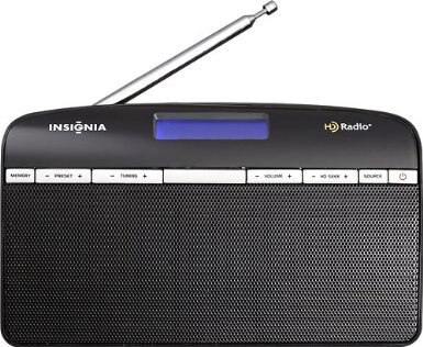

Testing Insignia NS-HDRADimage
I tested the Insignia NS-HDRAD receiver.  It did very well.  There was no noticeable intermodulation from the strong FM stations located near the office.  It detected the HD signal from several stations in my area.
Most stations with HD provide two channels with similar programming.  The WI Public Radio FM station in my area has three choices of digital programming on the same frequency.  Their third subchannel is dedicated to talk programming and had noticeably limited audio bandwidth.  Stations can have several subchannels, but at least one must be at least the same quality as the analog signal .
One nice feature with the Insignia radio is the AUX IN port.  I used it to listen to audio from my MP3 player.
The biggest downside to this radio is it has no AM coverage.  I looked at other HD radios, and many have no AM or analog-only AM.
Another issue is the volume.  I had to turn up the volume near maximum to listen to the low-bandwidth digital station with talk programming.  The same was true when listening to my MP3 player (at its max volume) through the AUX port.
