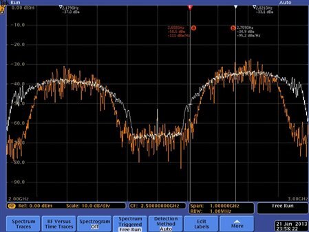

Tektronix let me borrow one of their mixed-mode scopes that has a spectrum analyzer and a full-featured scope in the same box. It's cool because you can watch one domain and trigger of the other.  You can watch them at the same time and stop them both to look at the frequency domain during a time-domain event.  Very cool.
I'm getting this weird noise on the spectrum analzyer side.  It is a set of two large symmetric peaks centered around 2.5GHz.
The signal presists even when I terminate the input with a 50 ohm dummy load.  I have another spectrum analyzer and have confirmed there's no noise in the area.
I'm guessing I'm doing something wrong because this is a new scope.

    I have seen this too,(bolth mdo4104-6 and mdo4014-3) all though not as bad. the sample clock of 2.5Ghz presents a small ~10dB average peak
    have you compensated signal path?
    if not, after compensating signal path, is it still there?

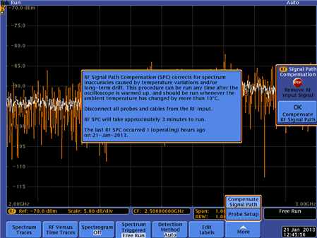

    remove RF input, and run compensation. also try pushing "default setup" to remove any other settings
  • gervasi
    gervasi over 13 years ago in reply to sqkybeaver
    I had tried reset-to-defaults.  Running Compensation fixed the problem. image   Thanks!!
    I left it in the car in the garage last night.  It was about 0F outside last night, so maybe the cold affected it.  It's non-operating range is down to -80F, so it shouldn't have damaged it.  But maybe it caused it to need to be compensated.  Thanks again.
