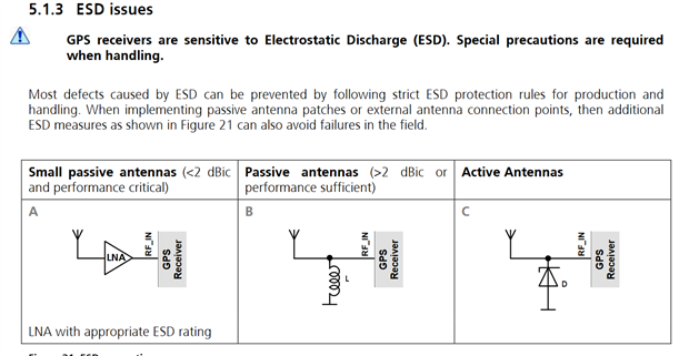

Hi,
I'm entering the beautiful world of RF design, and after looking into the documentation of the ublox NEO-6M module and saw this:
So because i know that my antenna is absolutely perfect (that isn't true but i'm proud of my qfh garbage)
I need to go with the inductance method since some manufacturers are saying that I should not go with a TVS because that's doing Bad things to the signal :
https://www.murata.com/products/emc/esd/sol_antenna_noise
So Do someone have any idea about how I can calculate the inductance
(BTW i wont connect my antenna directly to the RF-IN like this , i will do a little step of filtering)
Nico

    Hi Nicolas,
    Your image didn't post. You will have to use the picture icon in the tool bar so we can see what you are referring to.
  • nicoloquinte
    nicoloquinte over 8 years ago in reply to jw0752
    Ok thanks
    https://www.u-blox.com/sites/default/files/products/documents/GPS-Antenna_AppNote_%28GPS-X-08014%29.pdf
    page 20 FIG 21
    shabaz over 8 years ago
    Hi Nico,
    You can calculate the impedance and just ensure it is significantly higher than 50 ohms, for the frequency that you're working at. However, the real-world inductor will also have capacitance. At the frequencies that device will operate at, you can't use any inductor. I think option 3 in the document will be easier. Also, there is further reasoning to support this and suggestions for option 3 here:
    https://www.murata.com/en-eu/products/emc/esd/sol_antenna_loss

    nicoloquinte over 8 years ago in reply to mcb1
    Thank you for all your answers !
    So If i understand , I shouldn't go for an inductor, and look at a nice diode,
    Can I use a basic TVS or I should buy a A-TVS (there is no electronic part store near my city (basically not a lot in my country)
    I Asked my question because the inductance value wasn't specified (F = 1545.42 Mhz)
    Actually I plan to make a board to play with gps and rf in general and put this on a bike, so i think esd will be a problem since the antenna will be on the handlebar

    shabaz over 8 years ago in reply to nicoloquinte
    Hi Nicolas,
    The part will be tiny (of the order of 1mm in dimensions) because of the capacitance mentioned earlier, that needs to be minimized, otherwise there will be no usable signal. 1mm is hand-solderable, I don't know of any recommended videos but if you google 'soldering 0402 components' you'll find what you need.
    I think you're over-thinking this, and the result will be no usable signal and a damaged antenna cable (if you're planning to cut the cable to insert this device). You can buy it ready-made here for $49: TPD1E0B04EVM TPD1E0B04 1-Channel ESD Protection Diode for USB Type-C and Antenna Protection Evaluation Module | TI.com  or you can try to make it, but it is 1.0x0.6mm in size
