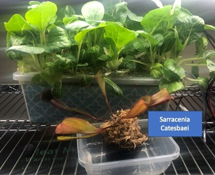

I've also tried this on sarracenia (bug catcher plant) because this plant constantly requires water.
2. Plant Growth Progressions
This week, green onions. Green onions grow easier with soil because if we add more water than required to the green onions (water level above the roots), they go bad.
3. New Plant: Bag Catchers
Fruits and leafy plants attract bugs. I am not sure how bugs can survive in space rockets. But, it is not fun for astronauts with many bugs in tight area.
So, I've added sarracenia. This plant requires special care. The gardening tips are summarized in this page: https://green-scientist.com/2020/12/05/bug-catcher-sarracenia-catesbaei/
