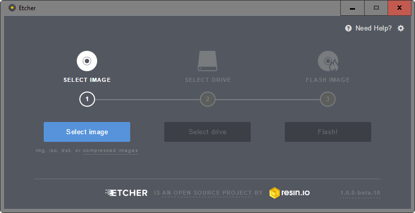

4) Download Software which will burn your Raspbian Image to your SD Card
I recommend using Etcher, although you can use WIN32DiskImager or other programs.
This will not only copy the software onto your SD card but help partition and format your SD card correctly for the Raspbian / Linux file system.
Download here https://www.balena.io/etcher/
5) Flash Raspbian onto your SD Card with etcher.
Once you have downloaded your Raspbian Image, it will be saved in your downloads folder as a .zip or a .img file.
  • Insert your MicroSD card into your computer,
      (if you don't have an SD card reader you can buy external USB SD Card readers)
  • Open Etcher
  • Select the Raspbian Image (Etcher can handle .zip or .img files)
  • Select your MicroSD Card from the list of drives.
Be very careful to select the right drive and SD Card!
  • Review your selections of Image and Micro SD Card and then click FLASH! on Etcher.
  • Once this has flashed the image, safely remove the MicroSD Card

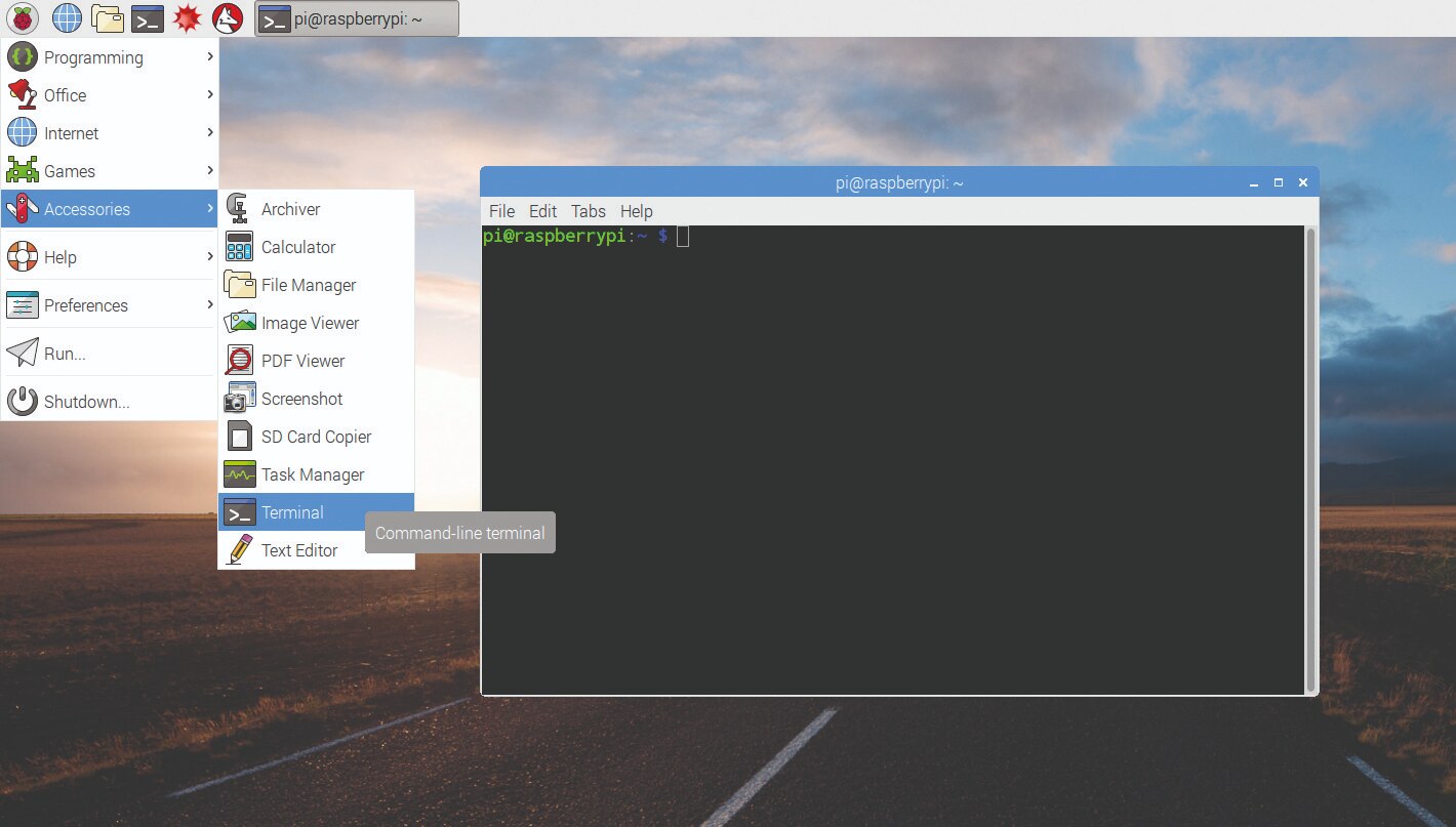

First, Go to "Terminal"
Then, you want to update the list of packages on your device by typing the following command into Terminal.
sudo apt-get update
After process has signalled it is finished in terminal, you want to update all the software on the device its self with the following command in Terminal
sudo apt-get dist-upgrade
Once this process is done you can close Terminal, rest assured that your Raspberry Pi is fully up to date!
