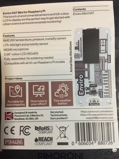

  • The Enviro HAT model PIM486, came in a nice black shielding bag, shown on the left.
  • Very poppy labeled package.
  • The board was wrapped in a shrink-wrap bag for added protection.
  • The back of the bag, shown on the left, has:
    • a description of the board
    • Features of the Board
    • Product Ideas
      • Portable for data mapping
      • How noisy is your office?
      • Tiny weather station
    • Contents of the bag
    • the Address of PIMORONI
      • With with help links and support email
      • Get Started
          • https://pimoroni.com/enviro
        • Technical help:
          • https://forums.pimoroni.com
        • Got a Problem?
          • support@pimoroni.com

PIM486 Enviro HAT for Raspberry Pi
Designed for environmental monitoring, Enviro for Raspberry Pi lets you measure temperature, pressure, humidity, light, and noise level. It's an affordable alternative to environmental monitoring stations that can cost tens of thousands of dollars and, best of all, it's small and hackable. In this section, I'll go through what the different parts of the board do, how to attach it to your Raspberry Pi, how to install and use the Python library, and also look at how to run a few of the code examples included in the GitHub repo.
What's on the Enviro?
BME280 temperature, pressure, and humidity sensor
    • The BME280 is a neat little weather sensor that measures temperature, pressure, and humidity. It's great for indoor monitoring, if you want to keep track of conditions in your home, for example.
    • On Enviro, the BME280 sensor is at the left hand edge of the board, and has been placed there deliberately to be positioned away from the Pi's CPU.
    • There's also a little slot routed out next to the sensor that helps to reduce heat radiated through the Enviro+ board to the sensor.
LTR-559 light and proximity sensor
    • This sensor can read the ambient light level in Lux (a unit of light intensity) and also has a proximity sensor.
    • The LTR-559 is the same sort of sensor that's next to the camera in your mobile phone that automatically dims and brightens the screen depending on the light level and disables the touchscreen when it's next to your ear.
    • As well as being great for reading the light level, the LTR-559's proximity sensor is really handy as a proximity-sensitive input. It is used it in one of the examples to toggle through displays of the different data from Enviro on the LCD.
MEMS microphone
    • Enviro has a tiny MEMS microphone that lets you record audio or detect noise levels.
    • It's really good for monitoring levels of noise pollution,
      • It's not clear when the company will be adding support for this to the Enviro Python library.
0.96" color LCD (160x80)
    • The tiny full-color LCD on Enviro is a neat way to display live data from the sensors onboard.
    • The display is an IPS display, so it's great quality for a display of its size,
      • and it's driven by SPI so you can update it pretty quickly.
    • The all-in-one example displays sensor readings from Enviro on the LCD,
      • with the live readings and a graph of the most recent values.
