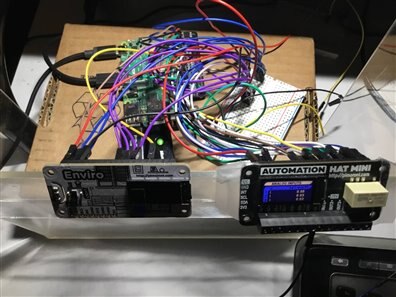

Electronics Build
The Electronic Build section will describe the Wireing for the connections of the 2 hats, water temp sensor  and the devices attached to the Automation Mini Hat
  • Enviro Hat and Automation Mini Hat
    are wired to the rasberry using the wireing scheme
    • I was somewhat disappointed that I could not stack the Hat's using the Pico Hat Hacker,but happy to find that another challenger, dules had a solution in one of his blogs Aquaponics Box: #2 - Hacking the HATs (both HATs from the challenger kit on single RPi)
    • I was able to get both HATs working, using the wiring diagram and his PIN analyst contained in this blog.
    • Thanks dules
    • The only wiring I did different is that I used GPIO 13 for the Enviro display backlight.
    • image
  • Water temp Sensor
    • This sensor is attached to the breadboard off the rasberry pi as described in my Blog# 5 EAS - Research Temperature Sensor - DS18B20
  • Devices attached to the Automation Mini Hat
    • LEDLight
      • Automation Hat output1
    • WaterPump
      • Automation Hat output2
    • WaterHeaterPad
      • Automation Hat output3
    • RoomHeater
      • not Implemented YET
    • IntakeFan
      • Automation Hat relay NO
    • OutTakeFan
      • Automation Hat relay NC

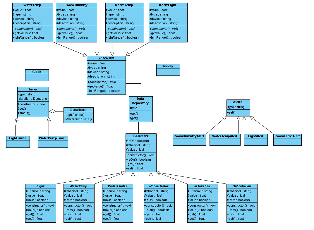

Software Build
The Software Build will contain sections on the python code used to implement each class from the from the class diagram described in Blog#7
For this build, I developed 6 Python scripts that implement the classes described in my Design Challenge Blog# 7 EAS -  System Designs -- Software Design
Each of the following sections contain the classes code..
Class Diagram

Alerts (alerts.py)
BASE Class
# Alert class
# this module contains the alert class used to
# - save alert message to the data repository
# - sending message in an email to the system Admin
# - logging message to stderr
#######Child classes that inherit from base class: Sensors
#type -- Nane
# 1 -- RoomHumidityAlert
# 2 -- WaterTempAlert
# 3 -- LightAlert
# 4 -- RommTempAlert
# 5 -- other     - NOT IMPLEMENTED YET

  • Ths blog documents the classes that I wrote to implement my design diagram from my Blog# 7 EAS -  System Designs -- Software Design
  • It includes all the code to be used by the python scripts to be produced and featured in a later blog post.
  • Unit test of each module, will be featured in a future blog post.
