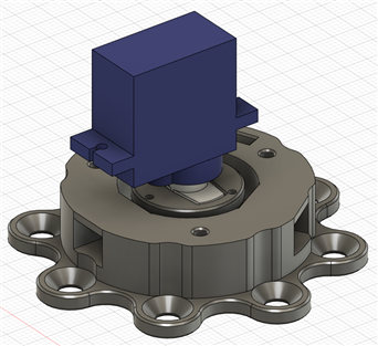

We will begin with the base of this mechanism, let's define what the base needs to do first. The base needs to have the holes for attaching the whole mechanism to the robot, part of it will be the cylinders that will be used as guides for the pistons, we need a hole for the cable routing and we need holes for attaching the motor mount to it.
It has a hole in the bottom in the center which is used as a brace for the barrel when turning as well as for tightening the screw that attaches the motor adapter to the servo motor.

     Those would be all of the parts needed for this assembly. Now, let's take a look at some sub assemblies and then at how the final assembly turned out. Another thing to point out is that I've designed all of the parts so they can be printed without any supports. I printed them on my Ender 3 Pro, using Creality White PLA, at 205C and 60C bed. The tolerances for the moving parts are 0.3-0.4mm, so most 3D printers will be able to handle that. I could have pushed for finer tolerances, but there really wasn't any need to. On this link, you can find STP files for all of the components if you wish to edit them in any way as well as STL files so you can slice them right away and print them. All of the filed are of course free to use, so you can do whatever you want with them!
     On this picture you can see how the base of the mechanism works with the barrel and the servo motor. There's a pretty big gap between the barrel and the base because I don't need them to be close and I've put chamfers on the bottom edges of all models  to compensate a bit for the elephant foot while printing.
     On these 2 pictures you can see the motor mount doing it's 2 jobs, holding the motor snuggly in place and on the second picture you can see how the top cap is mounted using the 4 screws and 4 springs. You can notice on the first picture that there are like channels around the motor, those are for the screw heads to go up and down when the cap is moving, and the square hole is for routing the flat 3 wire cable from the servo. Let's take a look at the full assembly now.
