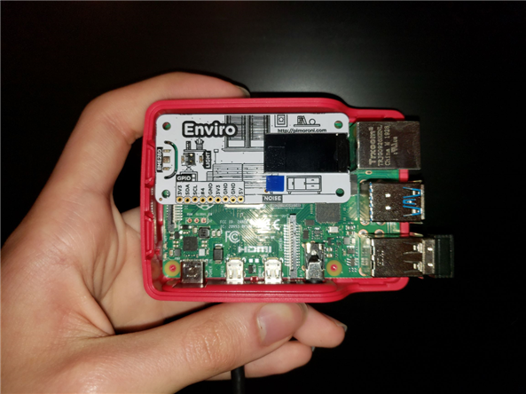

The Enviro HAT is an attachment that perfectly snaps onto the Pi pins. It is outfitted with sensors that collect environmental data such as temperature, humidity, and light.

Before attaching the Enviro HAT onto the Pi pins, I power off the Pi. This eliminates any possibility of short circuiting the Pi in case if things aren't connected correctly. I'll have to repeat SSH connection, but it's best to be safe.

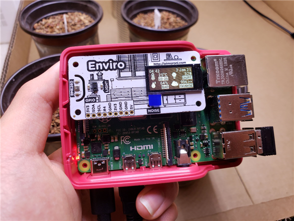

As we can see, readings may require calibration:
  • Temperature | 25°C is quite warm. Heat radiated from the Raspberry Pi CPU increases the actual reading. There is a compensated temperature program that accounts for this.
  • Humidity | 64% BAD. I'm not quite sure what qualifies as a BAD humidity. The plants are growing just fine. Perhaps the heat from the Pi affects humidity as well.
  • Light | 328 Lux. The Enviro HAT must face towards the light at the same distance as the plants to get the most accurate reading.
