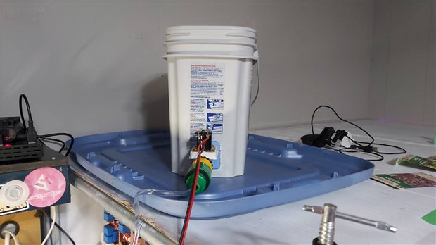

With that being said the first issue I had was I had everything wired up and ready to go software was installed and time to run my first bit of water through the system.   Using the 4 switch water relay (actually just air) I noticed sufficient water droppings forming around the unit and then it started to pour out there was little time to act so shutting it off I managed to get everything cleaned up and it was back to the drawing board.
Frustration levels where getting high at this point as I so wanted it to work but it wasn't going to happen.
So its time to adjust the valve swapping it out for a single valve instead of the 4 output valve I had to adjust my system to accommodate the change.   How was I going to water the system evenly?  well I opted for drip watering system so I could control the holes and flow amount over time.  later on a soil moisture meter will be added to monitor each tray.
I had the trays all sealed up and things where good.   Water was flowing and  any leaks that were in my line were now resolved.
But I wasn't happy it really isn't the system I initially imagined in my head.  Things were starting to be more and more off course.
At this point  I had to forfeit my top growing area due to now only having the one zone available on my valve relay.  which will later be revised I am sure to get it going as I would love to be able to grow strawberries and other items that would hang down in the enclosure.  At this point I would have been better of just making a 8 tray dual layer enclosure but then I would require more lighting adding more wattage to the system.   Trying to keep the overall working wattage down was my main concern.  Having the ability to be able to in the future run the system off a small solar setup is the ultimate goal.  Running and monitoring power consumption throughout the process was one of the main things I wanted to address going forward.
Carrying on with watering issues now the next thing that will have to be addressed in the future will have to be the watering pump.   Currently I need gravity to help force water down and into the pump as it wasn't strong enough to pump from below the the pump.
So initially I did have some water leaking from the green quick connect on the unit but that was resolved with a change in washer on the inside of it which was not tight enough to provide an decent seal on the unit.  So for now until I come up with either a design change or add on a better pump I will have to settle for this being the solution for now which is working but once again not ideal.
