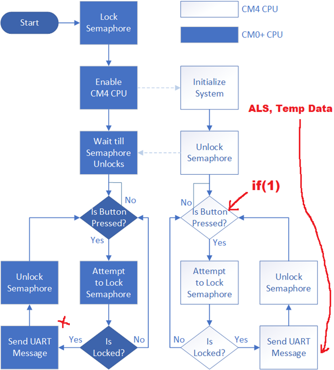

This blog is about interfacing the LED bar with the PSoC CY8CKIT-062S4 board through its vast number of IOs provided in the Arduino shields. It is one of the secondary modules in this project. Overall this involves writing up the logic to control 10 LEDs which will light up according to the Ambient Light Sensor(ALS) value reported by the onboard sensor. The process of obtaining these ALS and Temperature values is discussed in the previous blog and extending that, we'll now see about displaying it to the user.
Running on Cortex M4 Core
This implementation built on top of the code from the previous blog. In this dual-core application, the flow starts from Cortex M0+ (CM0+), enabling the larger Cortex M4 (CM4) core that initializes the IOs and subsystems within the application. We have seen how this whole flow works with both the cores sending UART messages and controlling the LED. Now with this LED bar interfacing, for real-time updates of the bar graph, the program flow is made to follow the loop in CM4 as highlighted. I suppose this can also be done probably in a more efficient way by activating an interrupt in a frequency when new data appears on ALS. Or even doing the process of query every 500ms or so and running through the loop on each core.
Code
Contains:
1. 2D array implementation for LED bar indication
2. ALS brightness threshold level definitions
3. Logic to pick the LED series from the matrix based on ALS levels
4. Print the ALS and temperature sensor values over UART

/*core for loop program*/
for (;;)
        if (1);     //or if(cyhal_gpio_read(CYBSP_USER_BTN) == CYBSP_BTN_PRESSED));
        #if ENABLE_SEMA
            /* Attempt to lock the semaphore */
            if (Cy_IPC_Sema_Set(SEMA_NUM, false) == CY_IPC_SEMA_SUCCESS)
        #endif
                /* Print a message to the console and turn Orange LED ON*/
                cyhal_gpio_write(CYBSP_USER_LED2, CYBSP_LED_STATE_ON);
                printf("Message sent from CM4\r\n");	/*UART transmit message*/
                /*Also send sensor data*/
    			/* Wait till printf completes the UART transfer */
    	        while(cyhal_uart_is_tx_active(&cy_retarget_io_uart_obj) == true);
    	        /*Bar LED display logic*/
    	            if(light_intensity < ALS_THRESH_LEVEL1)
    	            	ALSLevel = eALSLevel1;
    	            else if(light_intensity < ALS_THRESH_LEVEL2)
    	            	ALSLevel = eALSLevel2;
    	            else if(light_intensity < ALS_THRESH_LEVEL3)
    	            	ALSLevel = eALSLevel3;
    	            else if(light_intensity < ALS_THRESH_LEVEL4)
    	            	ALSLevel = eALSLevel4;
    	            else if(light_intensity < ALS_THRESH_LEVEL5)
    	            	ALSLevel = eALSLevel5;
    	            else if(light_intensity < ALS_THRESH_LEVEL6)
    	            	ALSLevel = eALSLevel6;
    	            else if(light_intensity < ALS_THRESH_LEVEL7)
    	            	ALSLevel = eALSLevel7;
    	            else if(light_intensity < ALS_THRESH_LEVEL8)
    	            	ALSLevel = eALSLevel8;
    	            else if(light_intensity < ALS_THRESH_LEVEL9)
    	            	ALSLevel = eALSLevel9;
    	            else if(light_intensity == ALS_THRESH_LEVEL10)
    	            	ALSLevel = eALSLevel10;
    	        /*Update LED status*/
				cyhal_gpio_write(CYBSP_D0 ,LedState[ALSLevel][eLed1]);
				cyhal_gpio_write(CYBSP_D1 ,LedState[ALSLevel][eLed2]);
				cyhal_gpio_write(CYBSP_D2 ,LedState[ALSLevel][eLed3]);
				cyhal_gpio_write(CYBSP_D13 ,LedState[ALSLevel][eLed4]);
				cyhal_gpio_write(CYBSP_D4 ,LedState[ALSLevel][eLed5]);
				cyhal_gpio_write(CYBSP_D5 ,LedState[ALSLevel][eLed6]);
				cyhal_gpio_write(CYBSP_D6 ,LedState[ALSLevel][eLed7]);
				cyhal_gpio_write(CYBSP_D7 ,LedState[ALSLevel][eLed8]);
	            cyhal_gpio_write(CYBSP_D8 ,LedState[ALSLevel][eLed9]);
    	        cyhal_gpio_write(CYBSP_D10 ,LedState[ALSLevel][eLed10]);
				/* Print the temperature and the ambient light value*/
				printf("Temperature: %2.1lfC    Ambient Light: %d%%\r\n", temperature, light_intensity);
				printf("\n");
                cyhal_system_delay_ms(500);
                cyhal_gpio_write(CYBSP_USER_LED2, CYBSP_LED_STATE_OFF);
            #if ENABLE_SEMA
                while (CY_IPC_SEMA_SUCCESS != Cy_IPC_Sema_Clear(SEMA_NUM, false));
            #endif
main.c (CM0+)
                for (;;)
                    /* Check if the button is pressed */
                    if (Cy_GPIO_Read(CYBSP_SW2_PORT, CYBSP_SW2_PIN) == 0)
                    #if ENABLE_SEMA
                    #endif
                            /* Print a message to the console and turn Red LED ON */
                            cyhal_gpio_write(CYBSP_USER_LED, CYBSP_LED_STATE_ON);
                            Cy_SCB_UART_PutString(CYBSP_UART_HW, "Message sent from CM0+\r\n");		/*UART transmit message*/
                            cyhal_gpio_write(CYBSP_USER_LED, CYBSP_LED_STATE_OFF);
                        #if ENABLE_SEMA
                        #endif

    Continuing over this, there is a very interesting method for doing inter-process communication(IPC). Within the same lock/unlock cage of semaphore, this IPC can be implemented to transfer data between the processes. I am currently trying this feature using Cy_IPC_Drv_SendMsgWord() and Cy_IPC_Drv_ReadMsgWord()
    /*Motor ON full speed if ALS > 60% using IPC pipe*/
    if(light_intensity >= 60)
    myMsg = 0x1; /* MOTOR ON message */
        if (CY_IPC_DRV_SUCCESS != Cy_IPC_Drv_SendMsgWord(myIpc, MY_IPC_INTR_MASK, myMsg))
        /* Insert error handling */
