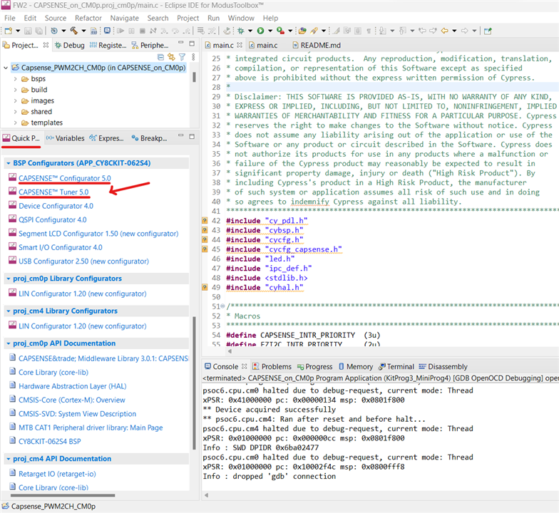

Configuring Capsense
Capsese is an interesting feature offered in many of Infineon's PSoC MCUs which is a capacitive touch sensing solution involving no physical pushbuttons or mechanical switch. This particular CY8CKIT-062S4 comes with 2 Capsense buttons and one Capsense slider. The IDE comes with integrated tools for configuring and tuning the Capsense application specific to the user.
Capsense Configurator
Capsense Tuner
The slider consists of multiple capsense units integrated sequentially and based on the touch signal weight as in the above plot, it judges the sliding movement.

The basic capsense example comes with the implementation of LED brightness control and for this project, it is extended to 2 channels. Initially, here I am using 2 onboard LEDs to configure and test out the functionality of PWM with the slider. Additional LED and PWM channel is added in the code as in the prototype definition.

Toggle Button Control Logic
For this project, I am interested to have the 2 capsense buttons to independently turn ON/OFF the motors or thereby the PWM signals driving them. As we have seen above in the CM0+ for main loop, process_touch() function is called and so the hint was to go there and add what I want to do as a part of processing the touch captured by the button. The flow goes so:
Get button status -> Get slider status -> Detect new touch on the button {do user defined action} -> Detect new touch on the slider {do user defined action} -> Update states (LED for example)
This block of code is written to toggle the LED status when a touch is detected on the button.
