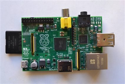

Key to the functioning of my system, is the Raspberry Pi 3 B+.
This improved version features Bluetooth 4.2 and 2.4/5 GHz Wifi onboard.
It's running at 1.2GHz with 1GB Ram, and is a far cry from the original.

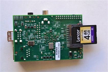

Just to wet your appetite, here some pictures of one of the first 10,000 Pis ever produced.
               photo credit :    three minions (me, myself and I)     Click for full size
As you can see quite a bit has changed, and this one sits in the cupboard with a sticker on it to make sure I know it is an original.

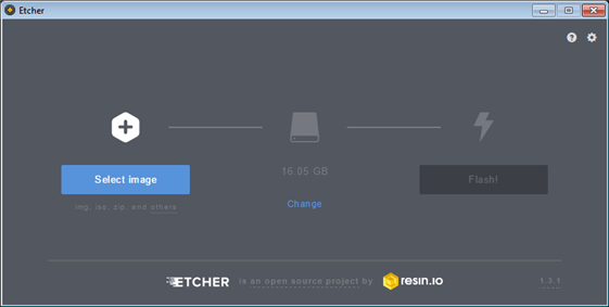

The Pi needs a uSD card, and for this use, I chosen a 16GB card.
I don't need the desktop so my software choice is Raspbian Stretch Lite from here https://www.raspberrypi.org/downloads/raspbian/
This is a 350MB download (versus the 1.7GB full version).

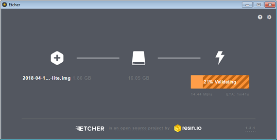

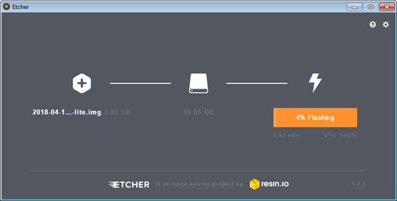

Formatting the card and loading the image onto it has been made a lot easier with Etcher https://etcher.io/
Select the image, it detects your SD automatically and hit Flash
After a brief delay it starts Flashing the image and displays the progress
It then validates the data

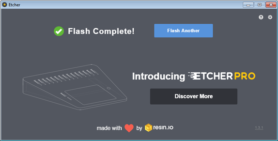

It then unmounts the card and indicates the Flash is complete and even asks if you want do it to another card.

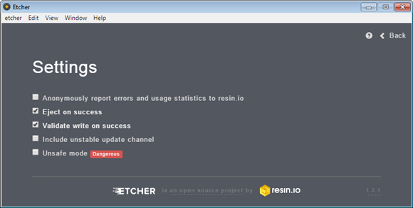

You do have some setting options for those that want to change things.
This is much easier than the previous format and then use SDFormatter, that worked but was slightly less safe.

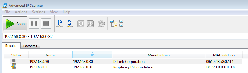

Does it work

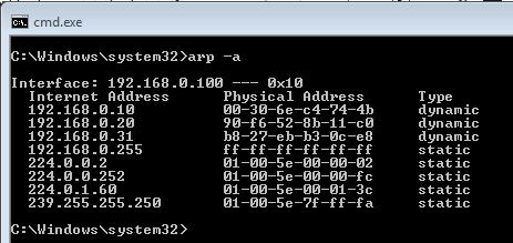

Well the next step involves accessing your router to see if the device appears.
You can also use a network tool to find IP address's.
I use Advanced IP Scanner ( Advanced IP Scanner - Download Free Network Scanner. ) on windows to tell what is there and whats not.
I suspect it has associated the MAC address to Raspberry Pi Foundation, rather than the device reporting it is a Raspberry pi.
In theory Windows runs around and tries to find all the devices on a Network, or the Router will start broadcasting about this new device it found.
You can try arp-a in a Command Window ..
In my development LAN this is the result, and I can tell that the b8-27-eb range is Raspberry Pi's MAC address range
Unfortunately this machine has already started a session with the Pi, so it's not possible to tell if it discovered it, or added it to the arp table.
However the conversation here suggested it worth trying https://raspberrypi.stackexchange.com/questions/13936/find-raspberry-pi-address-on-local-network#comment130327_34594
They even filter the first three parts of the MAC Address.
You can ping it, but all this tells you is the device is there, and you already know that as you've checked the router, or used something else to verify it. image
