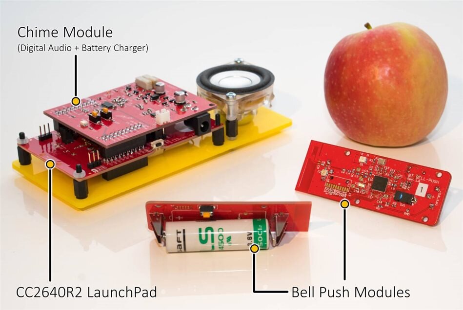

The Smart Doorbell System is a Bluetooth Low Energy (BLE) project to build a better doorbell! However, it could also have other uses - to open and close gates, to act as an emergency attendant button or to control or monitor all sorts of things. It can also be connected up to a Pi or BeagleBone, for extending reach and capabilities even further. For example, the Pi could log and timestamp activity, or activate a camera, or tunnel the information to another Pi or BeagleBone, and then pass the information onward over BLE to the far end, providing all the benefits of BLE combined with the compute horsepower and cloud connecting capability of the Pi.
All software and schematics and PCB files and bill-of-materials (BoM) are available.
For more information, click on the link above to explore all the blog posts, or (easier) watch the twenty-minute video below.
What Was Built?
Two modules were constructed; the bell push module, and the chime module. The can communicate directly to each other, or they can connect to a Linux system for extra features such as tunnelling alerts over the Internet, or for logging events or taking photos of who is at the door. With some effort the same system could be used for patient care, or for alerting people in a warehouse / shop floor.

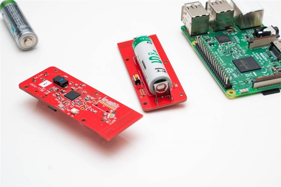

The Bell Push Module runs from an AA sized battery and should run for four years (I intend to make code changes to improve that further - currently it consumes 45uA but around 20uA should be feasible). It uses a Texas Instruments chip, the CC2640R2FCC2640R2F. When connecting to the wireless Chime Module, it consumes around 12-13mA average, briefly until the communication is complete. More accurate tests still need to be done, but these values were promising.

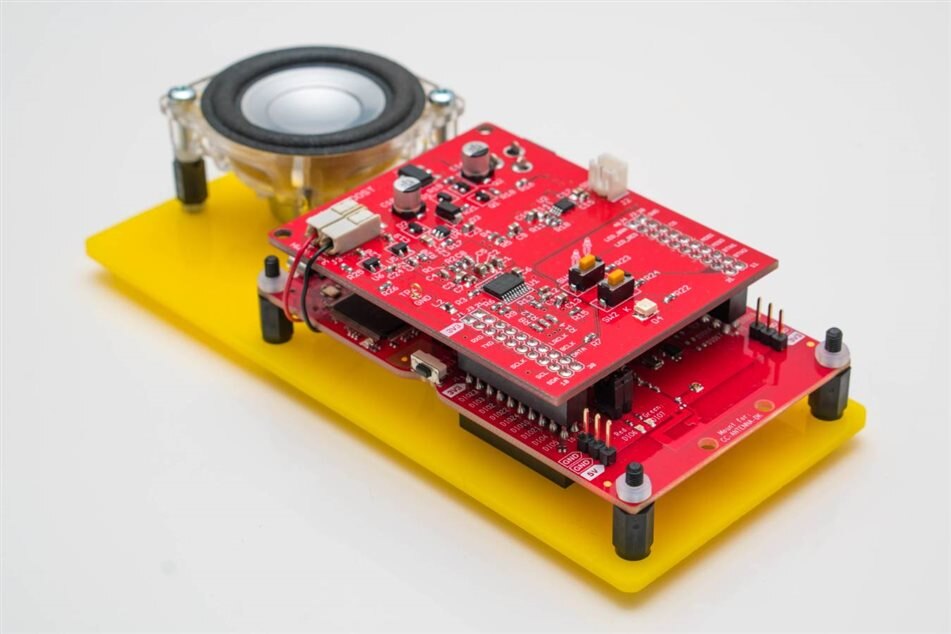

The Chime Module was constructed from a custom PCB plugged on top of a ready-made Texas Instruments microcontroller board called the CC2640R2 LaunchPadCC2640R2 LaunchPad. The custom PCB contains digital audio capability and dual supply capability (external DC, or the attached rechargeable battery which gets charged up automatically). The Chime Module can be used plugged-in to the DC supply, or it can be detached and taken outdoors (e.g. into the garden). When used on battery power, the current consumption is about 8mA, which allows for several days of outdoor use with the 600mA battery that was used. The battery will charge itself so there should be no maintenance required.

    One thing I'd suggest is examining the antenna closely - I thought I had got all measurements spot-on, but I've made a small error, there is a portion of the PCB antenna that looks like it has the incorrect dimension, I must have mistyped when I copied co-ordinates from the gerber file. So, although the system works, the range is just adequate until I get that sorted. Quite annoying that I missed it, but it is like a millimetre difference that was near-impossible to visually spot until I had the revision 1 board in my hand. I hope to have newer CAD files in the next few weeks. Also, it would be worth spending time seeking cost-efficient parts, because some of the inductors and capacitors are expensive, but cheaper alternatives will exist. There seems to be an industry-wide capacitor shortage recently which isn't helping : (
    There are also a few other tweaks I'd like to make to the board, although it functions today. One is that I really shouldn't have ground plane directly under the positive battery contact terminal! in case the solder resist ever accidentally scratches off : ( This was an oversight (or maybe I'm being over-paranoid about the likelihood), but ok for a rev 1 prototype where I can be extra careful with handling it all.
    Also, the tiny ceramic caps have a tendency to short when damaged, so I'd want to re-examine their positions, or perhaps specify flexible-termination caps, because an outdoor unit may end up with a flexed board when installing or over time with impacts. So it's an important thing to consider. A small resistor in series with the supply, or a polyswitch will also help to protect things in that circumstance.. there is space for such a resistor, currently a zero-ohm resistor is specified for that position. So in summary a few things are needed to improve long-term reliability.
