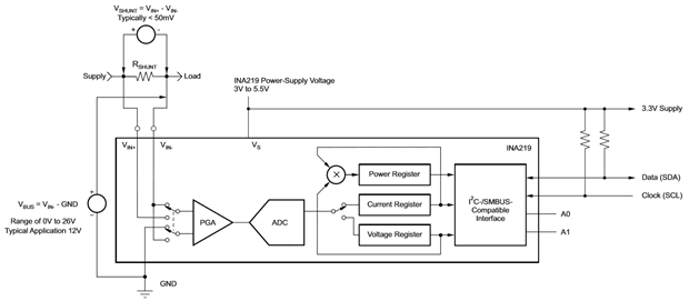

Current and Voltage Measurement
The belt-driven DC generator  on the Stirling engine flywheel outputs voltage and current that will be monitored by a Texas Instruments INA219 chip. This chip uses an I2C interface and has half a dozen registers to deal with.
The INA219 chip is mounted on a small PCB with a shunt resistor:

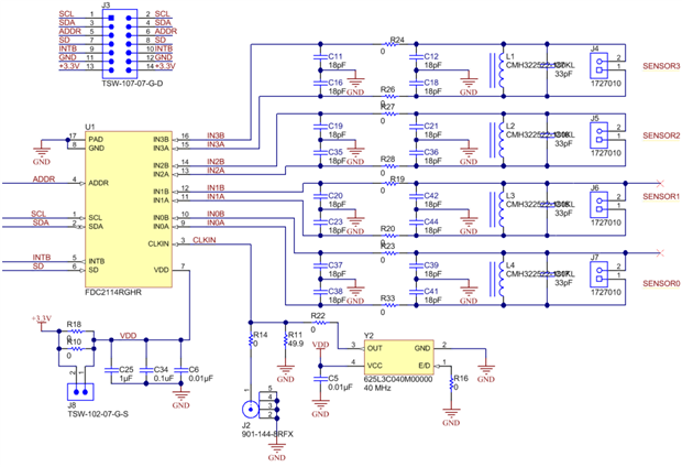

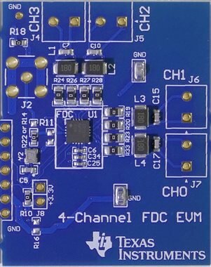

Fuel Level Measurement
Fuel measurement was covered in blog #4
The Texas Instruments FDC2214 chip is mounted on an evaluation module that can be partitioned to allow access to the chip via I2C.
This module has a fairly complex interface that has at least 13 registers to deal with.

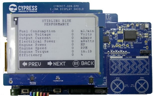

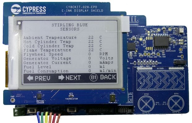

I have also been trying to get a better handle on programming the PSoC6 BLE module which will read all these interfaces. Here are a couple of screen shots showing the kind of parameter data I want to display:
