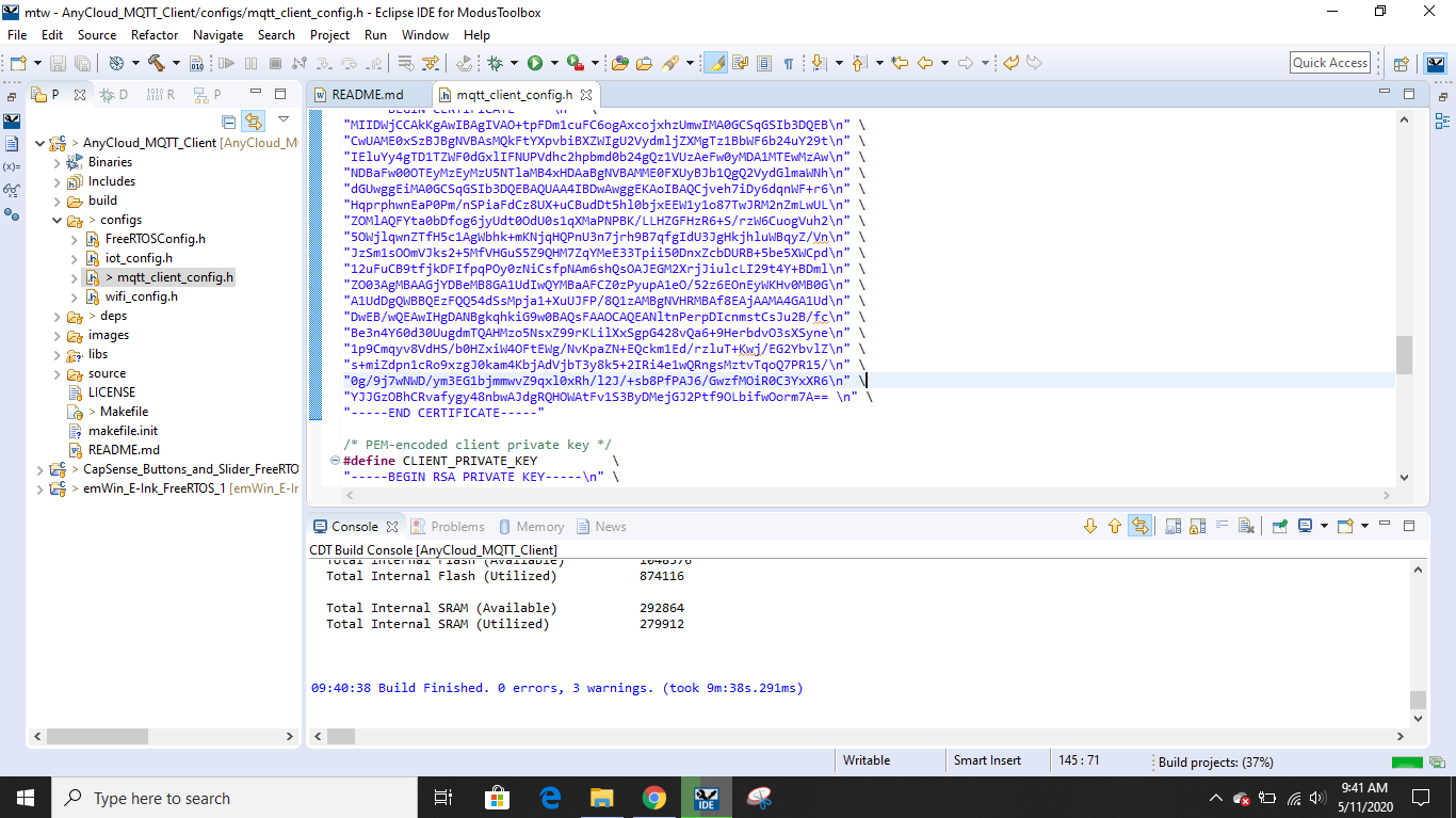

My initial idea is to use the Pioneer kit and AWS servers which are connected via the internet. After creating sync interaction between the server and PSoC 6 so that after just replacing the old image in can reflect that on the TFT screen.

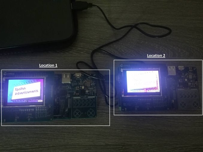

At last for final submission, I will use 2 PSoC kits and manage them by the server and create the scenario for a different location with a live user interaction interface.

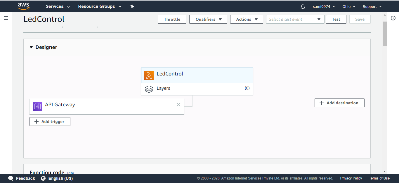

2) The server will run the Procedures to keep Sync between the database and Product status --> Examples: Procedure will keep looking if any changes in the database or any agreement will be near to expire then send a notification to User or a payment reminder. As the user updates the Image through Website it will call the API and after running the DB query it will pick-up the image from DataBase storage and Update into PSoC 6.
3) The connection between UI and HTTP API to trigger the Updation query of the image into a product.
4) API will send the command to update image or in other words, Send/Receive data from/to Product and establish a connection.
5) It will update/transfer the data from/to the product. (Note: this is part is still not complete I am facing the challenge to this task, I will discuss in details below of this Post)
As I have defined earlier that to display image into TFT using EmWin we need to convert that image into BitMap for EmWin --> but after getting image from Database I am facing the challenge how to convert that image into BitMap format for this project submission I have stored the Bitmap image as default into PSoC.
I have also ready with the 2 PSoC kits but due to facing this issue not able to demonstrate live transfer operation. image
As I have started working on making my own BitMap converter program using Python which can deploy on the server (I have completed this part you can see here) and I am able to complete this project. Due to many reasons like hardware delay and the curfew situation in India not I had faced many problems to develop this. Please consider my entry as submission of the project in "Connected Cloud Challenge" due to submission deadline I need to submit this project, but after this submission, I will try to complete this project as soon as possible
