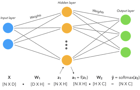

In general, a neural network is made of
  • an input layers
  • some hidden layers
  • An output layer
Values are provided to the input layer, multiplied by values called weights and propagated to the next layer. Weighs can be adjusted so that the output for a given input matches the expected output by means of an algorithm called optimizer. The most commonly-used optimizers are SGD (Stochastic Gradien Descent) and Adam. To measure of how good the value predicted by the neural network matches the expected output, we can select a proper loss function. For regression problem, the typical loss functions are MAE (Mean absolute error) or MSE (Mean squared function). For classification problems, Cross entropy is the most commonly used

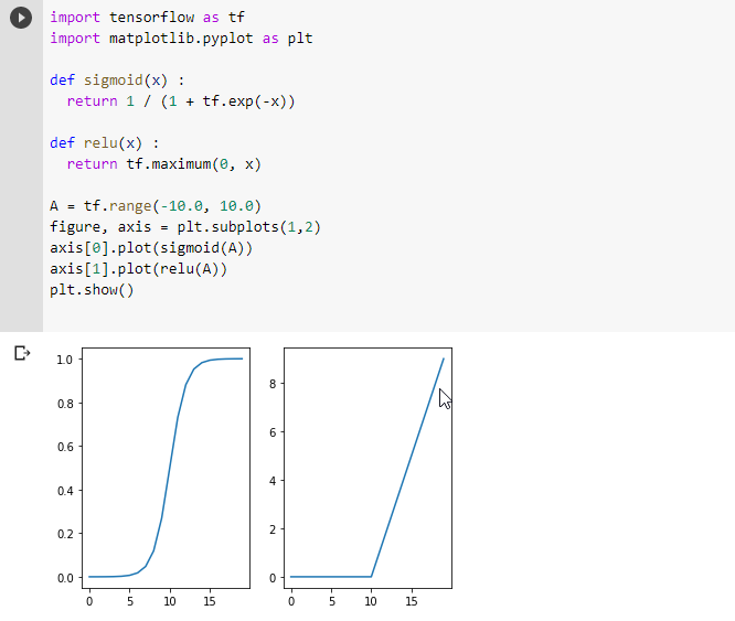

Hidden activationUsually ReLU (Rectified Linear Unit)
Output activationSigmoid

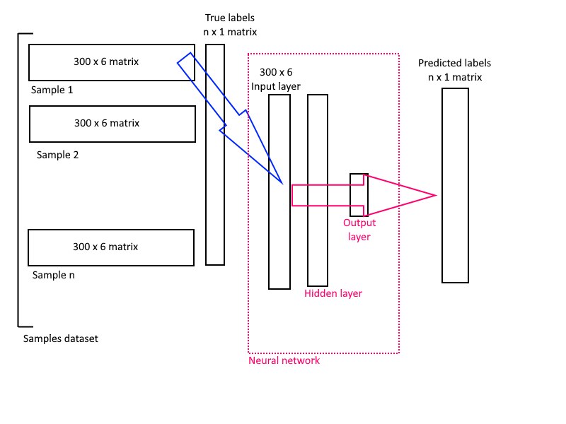

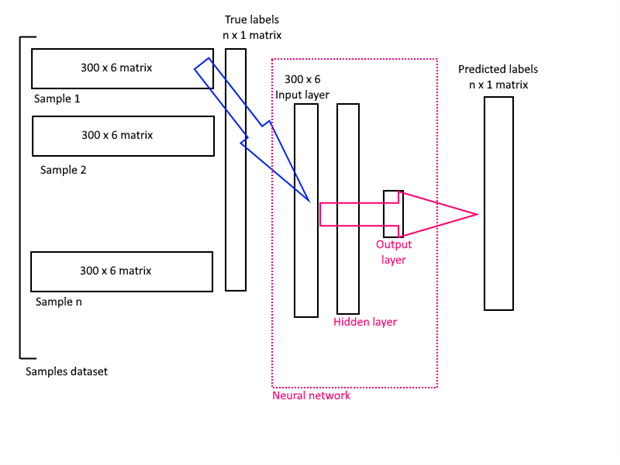

So this is the diagram of how our neural network will work
Neural network is fed with all the samples in the dataset, label is predicted and compared with the expected label. During training phase, comparing predicted output with the expected output makes it possible to adjust the weights of the neural network's internal connections

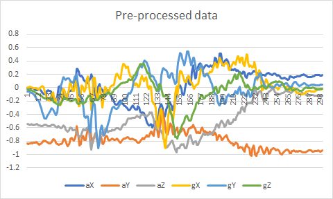

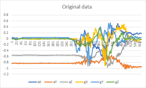

Preprocessing
In order to be used in this project, I created a simple application in C# that takes the text files in the dataset and performs the following preprocessing operations
  1. gets data related to ITG3200 and MMA8415Q sensors
  2. downsamples from 200Hz to 50Hz
  3. starts saving data to output final one second before the acceleration norm or the angular velocity reaches a threshold value
  4. limits the number of samples in each file to 300
  5. converts data [g] and [°/s]
  6. saves data to a file whose name has the format
      <ACT>_<PROGR>.csv
where
<ACT> is the code of either an activity or a fall as listed in the Readme file included in the Sistemic dataset
<PROGR> is a progressive number
The reason I applied a peak detection algorithm to the samples in the Sistemic dataset is to train the neural network with a set of time series that resembles as close as possible the real data collected by the Arduino Nano 33 IoT board, where the peak detection algorithm will be implemented. A peak detection algorithm is required because the wearable device will collect data continuously and it practically unfeasible to invoke the neural network every time a sample is read from the accelerometer because:
  1. invoking the neural networks takes for sure an amount of time larger than the accelerometer sample time. A minimum sample frequency of 50 Hz (i.e. a sample every 20 ms) is required in order to be able to reliably analyze time serie
  2. storing a complete window would take a lot of RAM, which is the scarcest resource in this challenge
Here is an example of the original time series from the dataset (on the left) and the time series saved in the csv used to train the neural network (on the right).

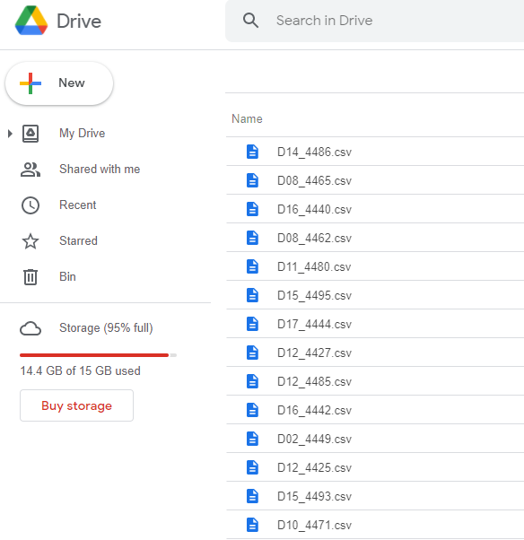

Files generated by the application have been uploaded to my Google Drive in order to be loaded by the Python code I will write in TensorFlow

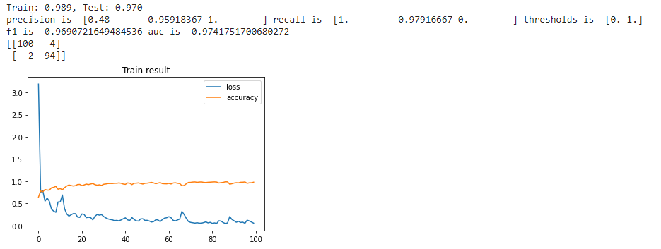

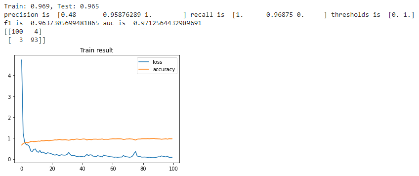

The metrics is the method the measure the predicted output when compared to the expected output. Here we used binary_accuracy, because we are creating a model for binary classification. Another possible metric could be  'accuracy', which is a special metric in Keras because it can be used in any kind of regression or classification problem.
In a binary classification problem, there are some other metrics that are of interest to us
MetricDefinitionCode
Accuracy
Percentage of correct predictions. For example, 95% accuracy means that 95 predictions out of 100 are correct
sklearn.metrics.accuracy.score()
tf.keras.metrics.Accuracy()
Precision
Proportion of true positives over total number of samples. Higher precision leads to less false positives (i.e. model predicts 1 when it should have been 0)
sklearn.metrics.precision.score()
tf.keras.metrics.Precision()
Recall
Proportion of true positives over total number of true positives and false negatives (i.e. model predicts 0 when it should have been 1)
sklearn.metrics.recall.score()
tf.keras.metrics.Recall()
F1-score
Combines precision and recall into one metric
sklearn.metrics.f1_score()

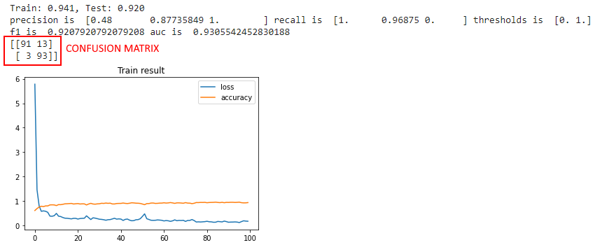

Confusion matrixRepresents in a 2D matrix the number of predicted class by the model vs the expected class
Classification reportCollection of some the main classification metrics, such as precision, recall and f1-scoresklearn.metrics.classification_report()
(images from https://anarinsk.github.io/lostineconomics-v2-1/machine-learning/basics/2020/04/19/classification-metrics.html )
Because we want to avoid false positive (i.e. falls that are detected are activities of daily life), our goal is to optimize the precision
Training the model

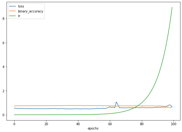

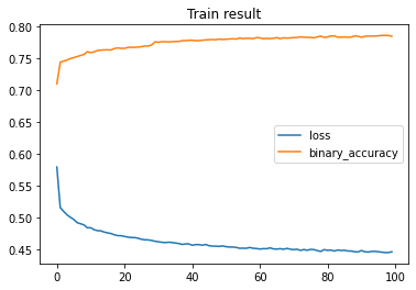

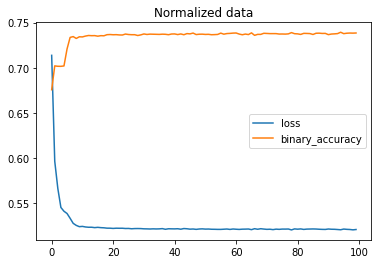

Finally we can train the model with our training dataset
# train the model
hist = model.fit(X_train_normal, y_train, epochs=100, verbose=0)

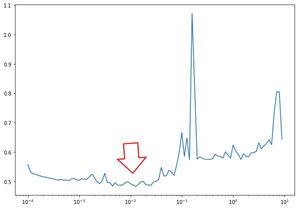

The first version of the model provided these results
Accuracy is less the 75%. Some serious improvements to the model are required!

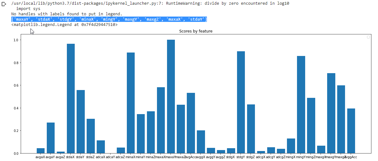

Model improving process
The common ways to improve the model is to
  • add new layers: adding new layers, however, makes the neural network that is more prone to memorization than generalization

We immediately see in the chart is the that binary_accuracy flattens after a very limited number of iterations. This is a symptom of a model that is too simple for the phenomenon we are trying to predict. So the first thing is to increase the number of nodes in the hidden layers and/or add new layers. As a dummy in neural networks, I don't have the experience to find the most convenient optimization path. I just followed a trial-and-error process to find out which are the sets of parameters that are best suited for my specific problem. Hopefully I will discover a more systematic approach in the near future...
But with 100 nodes this is what happened
No improvements or very marginal improvements. Looks like the input data can not be mapped to expected results reliably using the multilayer perceptron. At this point, I tried a feature-based different approach (more about this later). I will now talk a little bit about how to determine the best learning rate because this optimization procedure will also be used for the second approach I experimented with
To understand how well the model is learning, we can plot the loss curves, i.e. how quickly the "distance" between predicted outcome and expected outcome decreases. The fit() method of the model returns an object whose history property stores the value of loss function for each iteration. We can plot easily plot such values using pandas library
import pandas as pd
hist = model.fit(X_test, y_test)
pd.DataFrame(hist.history).plot()
Finding the best learning rate
To find the best learning rate, we can plot a graph of learning rates against losses. First, we need to set a learning rate scheduler callback
# Create a learning rate scheduler callback
lr_scheduler = tf.keras.callbacks.LearningRateScheduler(lambda epoch: 1e-4 * 10**(epoch/20)) # traverse a set of learning rate values starting from 1e-4, increasing by 10**(epoch/20) every epoch
# Fit the model (passing the lr_scheduler callback)
hist = model.fit(X_train,
  y_train,
  epochs=100,
  callbacks=[lr_scheduler])
# Checkout the history
pd.DataFrame(history.history).plot(figsize=(10,7), xlabel="epochs");
To find out the optimal value, we can plot loss versus the learning rate
# plot the learning rate versur the loss
lrs = 1e-4 * (10 ** np.arange(100)/20))
plt.figure(figsize=10,7))
plt.semilogx(lrs, hist.history(["loss"])
The rule of thumb is to take the learning rate value where the loss is still decreasing but not quite flattened

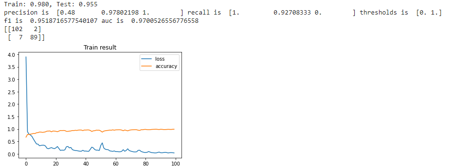

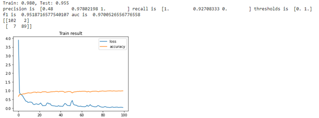

Evaluating the model
We can evaluate how the model is good at predicting the expected outcome on the test dataset. The most relevant metrics have already been introduced. The following code calculates and prints out precision, recall, F1-score and AUC
# evaluate the model
train_acc, train_loss = model.evaluate(fX_train, y_train, verbose=0)
test_acc, test_loss = model.evaluate(fX_test, y_test, verbose=0)
print('Loss - Train: %.3f, Test: %.3f' % (train_loss, test_loss))
# compute precision, recall, F1-score
from sklearn.metrics import precision_recall_curve
from sklearn.metrics import f1_score
from sklearn.metrics import auc
import seaborn as sns
y_predict = model.predict(fX_test)
y_predict_labels = np.round(y_predict)
precision, recall, thresholds = precision_recall_curve(y_test, y_predict_labels)
f1 = f1_score(y_test, y_predict_labels)
auc = auc(recall, precision)
print("Precision: ", precision[1])
print("Recall: ", recall[1])
print("F1-score: ", f1)
print("AUC: ", auc)
One step back: features extraction

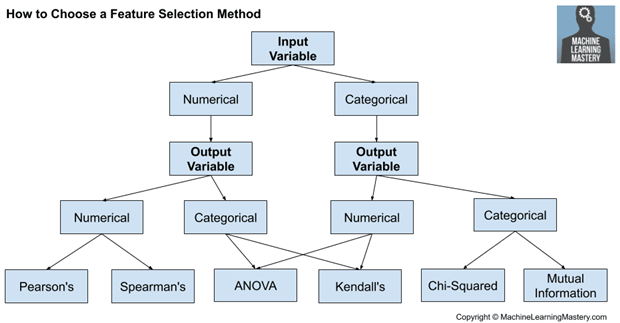

After the first experiment, I realized that time series can not be ingested in the neural network. There are so many inputs (300 samples for each of the 6 IMU DOFs) that the network can be trained to generated the expected data reliably or may be there are some many inputs that neural network can not determine what is relevant. So I tried to identify a certain number of features that can "summarize" the input data from sensor and make the machine learning process work better and faster. This process is called features selection. There are many different feature selection methods, and all of them are intended to reduce the number of input variables to those that are believed to be most useful to a model in order to predict the target variable. This diagram is very handy to select the correct feature selection method
Since the fall detection problem is a classification predictive modeling problem with numerical input values, we can select between two methods (both of them are correlation based)
  • ANOVA correlation coefficient (linear, implemented in scikit-learn by the f_classif function)
  • Kendall's rank coefficient (nonlinear)
I started from a long list of possible aggregation functions to apply to the IMU readings and that, in my opinion, may contain a good indication of a fall event was occurred. The initial list of aggregator included
  • minimum
  • maximum
  • average
  • standard deviation
  • median
  • skew
  • magnitude
  • slope
  • absolute minimum
  • absolute maximum

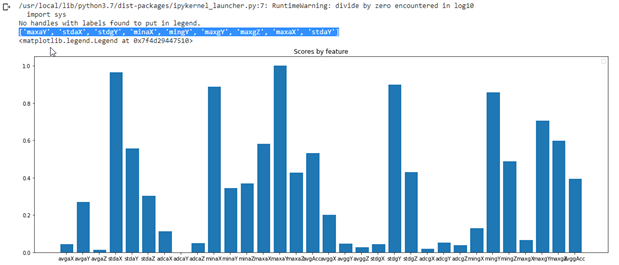

and many others. From this initial lists, I applied a top-k selector to determine which features have more correlation with the output
import numpy as np
import matplotlib.pyplot as plt
from sklearn.feature_selection import SelectKBest, f_classif
# check which are the most promising
featuresselector = SelectKBest(f_classif, k=2)
selector.fit(fX_train, y_train)
scores = np.where(selector.pvalues_ != 0, -np.log10(selector.pvalues_), 0)
scores /= scores.max()
fX_indices = np.arange(fX.shape[-1])
labels = ['avgaX', 'avgaY', 'avgaZ', 'stdaX', 'stdaY', 'stdaZ', 'adcaX', 'adcaY', 'adcaZ', 'minaX', 'minaY', 'minaZ', 'maxaX', 'maxaY', 'maxaZ', 'avgAcc','avggX', 'avggY', 'avggZ', 'stdgX', 'stdgY', 'stdgZ', 'adcgX', 'adcgY', 'adcgZ', 'mingX', 'mingY', 'mingZ', 'maxgX', 'maxgY', 'maxgZ' , 'avggAcc']
x = np.arange(len(labels))
indices = scores.argsort()[-16:][::-1]
print(list(np.array(labels)[indices]))
I tested with the a different number of the most representative features and I found that the best results comes with a set of 32 features, which, luckily, are also easy to compute!
I fed the neural network with a set of the 32-features input data extracted from the original dataset and the results are very encouraging. Here are the metrics calculated with a multilayer perceptron with different number of nodes in the hidden layer
