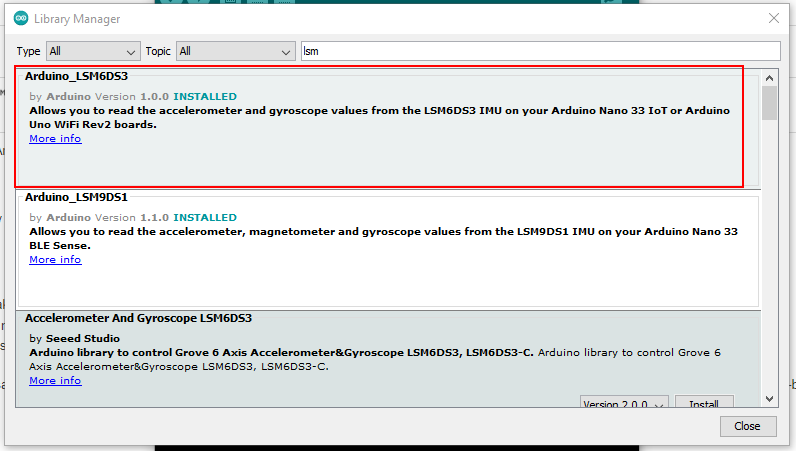

Reading IMU
Reading the IMU on the Arduino Nano 33 IoT is really easy: you just need to install the library Arduino_LSM6D3 from the IDE's Library Manager...
and run the following sketch to have access to both the accelerometer and gyroscope

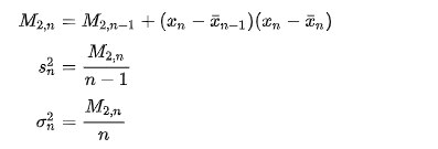

The calculation of minimum and maximum is trivial. Averages and standard deviation requires some attention because we want to implement an iterative calculative in order not to store all samples and thus save some precious RAM.
For the average, we will the following formula
Regarding the standard deviation, the solution comes from the Welford algorithm
where "M2,n" is the squares of differences from the current mean, image. This algorithm is much less prone to loss of precision due to catastrophic cancellation, but might not be as efficient because of the division operation inside the loop.
