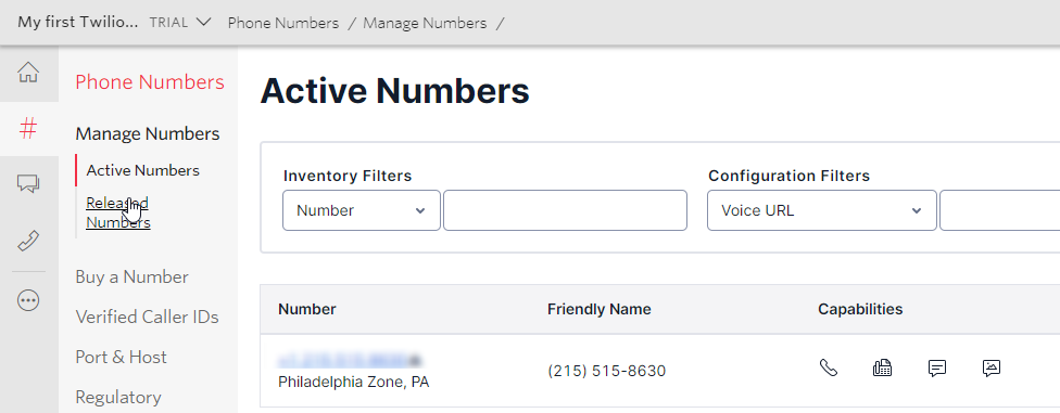

Twilio
I want ACE to send notification through SMS because this is probably the most reliable way of sending alarm notifications: they work wherever there is a 2G coverage, and are not affected by application out-of-services (for example, I experienced Whatsapp black-out even recently). Also, receiving SMS is nowadays a "abnormal" event, because we are mainly focused on messages and notification coming from social applications. So an SMS is more likely to be noticed and read promptly.
Since the Arduino Nano 33 IoT does not have a modem on-board, we must rely on an external service. I selected Twilio because we can send SMS worldwide and provides a convenient trial account. So the first thing is to register on Twilio and request a phone number (number with US prefix are free, other prefixes may be charged)

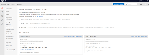

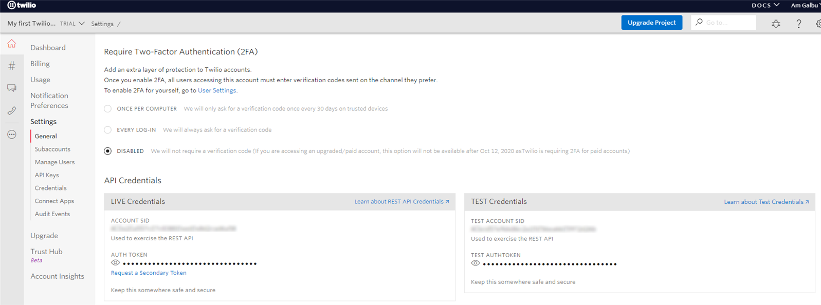

Next step, is to find the Account SSID and the Account token. Both are required to invoke Twilio's APIs

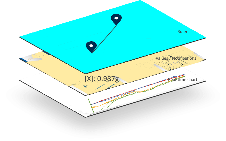

In this application, I created three overlapping SurfaceView objects:
  • one to draw the real-time chart
  • one to draw values and notifications (for example, in case of a fall)
  • one to draw the ruler
Probably this concepts are more clear if you go through a demo video

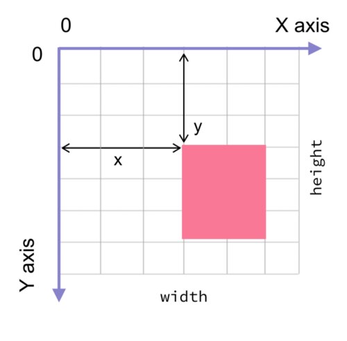

  • the canvas coordinate system. The coordinate system of the Android Canvas starts in the top left corner. The Y axis is positive downwards and the X axis is positive towards the right. All element drawn on a canvas are placed relative to the origin point at coordinate (0, 0)
  • canvas draw commands will draw over previously drawn items. The last draw command will be the topmost item drawn onto your canvas. So it's important to order draw primitives to have the foremost elements drawn after all other elements.
