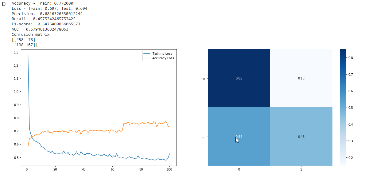

The only neural network I was able to run on the Arduino Nano 33 IoT board was a neural network with just 4 feature and 10 nodes in the hidden layer. These are the metrics for such a neural network
Accuracy - Train: 0.772000
Loss - Train: 0.697, Test: 0.694
Precision: 0.6816326530612244
Recall: 0.4575342465753425
F1-score: 0.5475409836065573
AUC: 0.6794613632478063
What I can figure out here is that a coin toss can predict the fall better than the neural network.

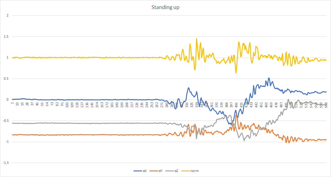

This is what the accelerometer readings when a person stands up

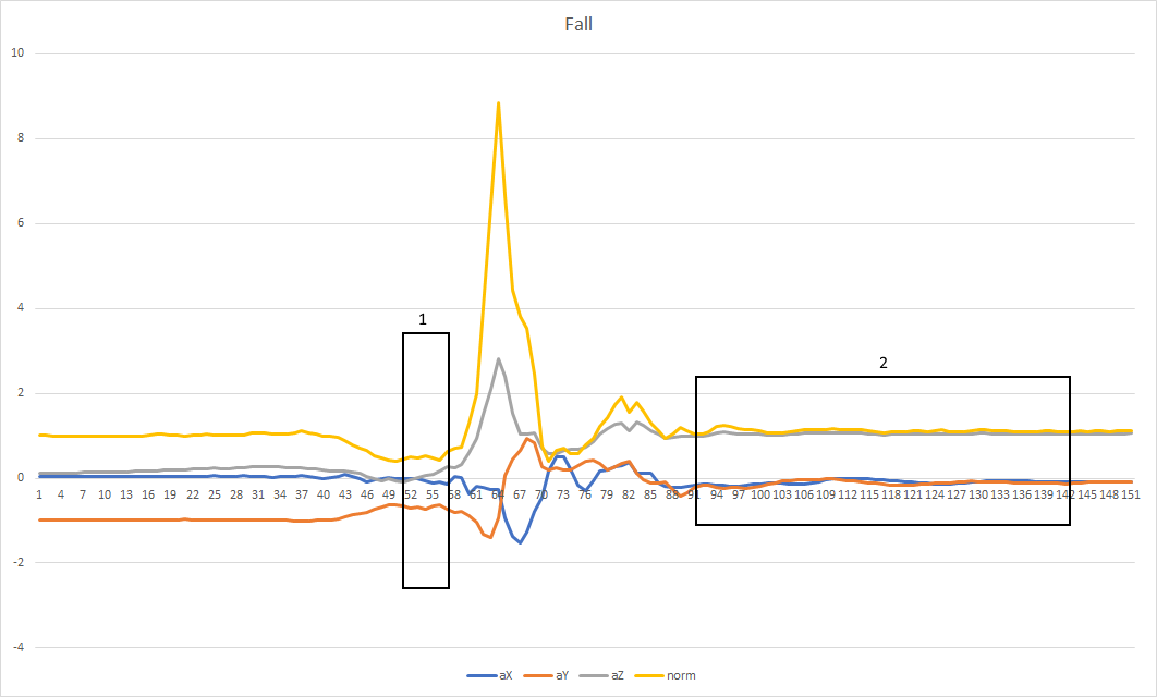

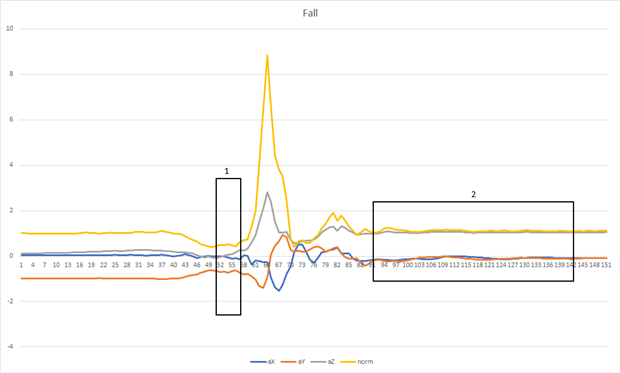

And this is the accelerations in case of a fall
As one can see, they are completely different
There are some notable characteristics that can be used to detect a fall
  1. start of the fall: the phenomenon of weightlessness will always occur at the start of a fall. It will become more significant during free fall, and the vector sum of acceleration will tend toward 0 g (see the yellow line); the duration of that condition will depend on the height of freefall. Even though weightlessness during an ordinary fall is not as significant as that during a freefall, the vector sum of acceleration will still be substantially less than 1 g (while it is generally greater than 1 g under normal conditions)
  2. aftermath: Generally speaking, the human body, after falling and making impact, can not rise immediately; rather it remains in a motionless position for a short period (or longer as a possible sign of unconsciousness)
  3. impact: between the "start of the fall" and the "aftermath" phases, the human body will impact the ground or other objects; the acceleration curve shows this as a large shock.
  4. comparing before and after: after a fall, the individual’s body will be in a different orientation than before, so the static acceleration in three axes will be different from the initial status before the fall. Suppose that the fall detector is belt-wired on the individual’s body, to provide the entire history of acceleration, including the initial status. We can read the acceleration data in all three axes and compare those sampling data with the initial status. In figure, it is evident that the body fell on its side, since the static acceleration has changed from –1 g on the Y axis to +1 g on the Z-axis. So the fourth basis for determining a fall is if the difference between sampling data and initial status exceeds a certain threshold, for example, 0.7 g.
