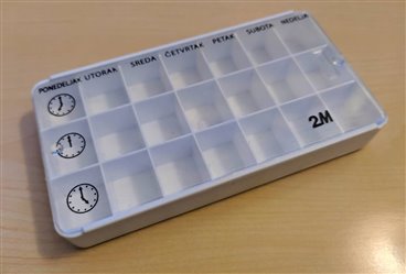

     This project will be primarily designed for my lovely grandma. She needs to take a lot of different pills during the day on a regular basis whether that is for her heart, blood pressure or something else just like a lot of people her age. Of course, it's really important that she takes the right medication at the right time for them to have the right effect, specially because some of those pills work in combination. During 2020 a lot of people had to start taking medication regularly or add new medication to the ones they usually take. While my mom and I live in the same house as my grandma, she's usually at work, at I'm sometimes not home for weeks if I have some obligations at university, so we can't really actively control if she has taken every single pill and she would probably get annoyed by us as well in the meantime. Shortly put, my idea for this project is to make a medication box which would keep track if grandma is taking the right medication at the right time and alarm us if something is not right.
My grandma uses one of those standard pill organizers which you can see on the picture above. It has individual cells for pills for the morning, midday and evening for all of the days in the week. It does the job okay, the lid is a bit flimsy and not so secure and something I don't understand why, it's made out of white plastic, like most of other pill boxes. Pretty much all of the medication she needs to take (and that I have generally seen in my life) is either white or some bright pink/blue color, so, it would be more logical to have a dark box, to have a bigger contrast so you can see the medication easier. My idea is to make an upgraded version of the pill organizer. Here's a short bullet point list that will represent my goals with this project a bit better:

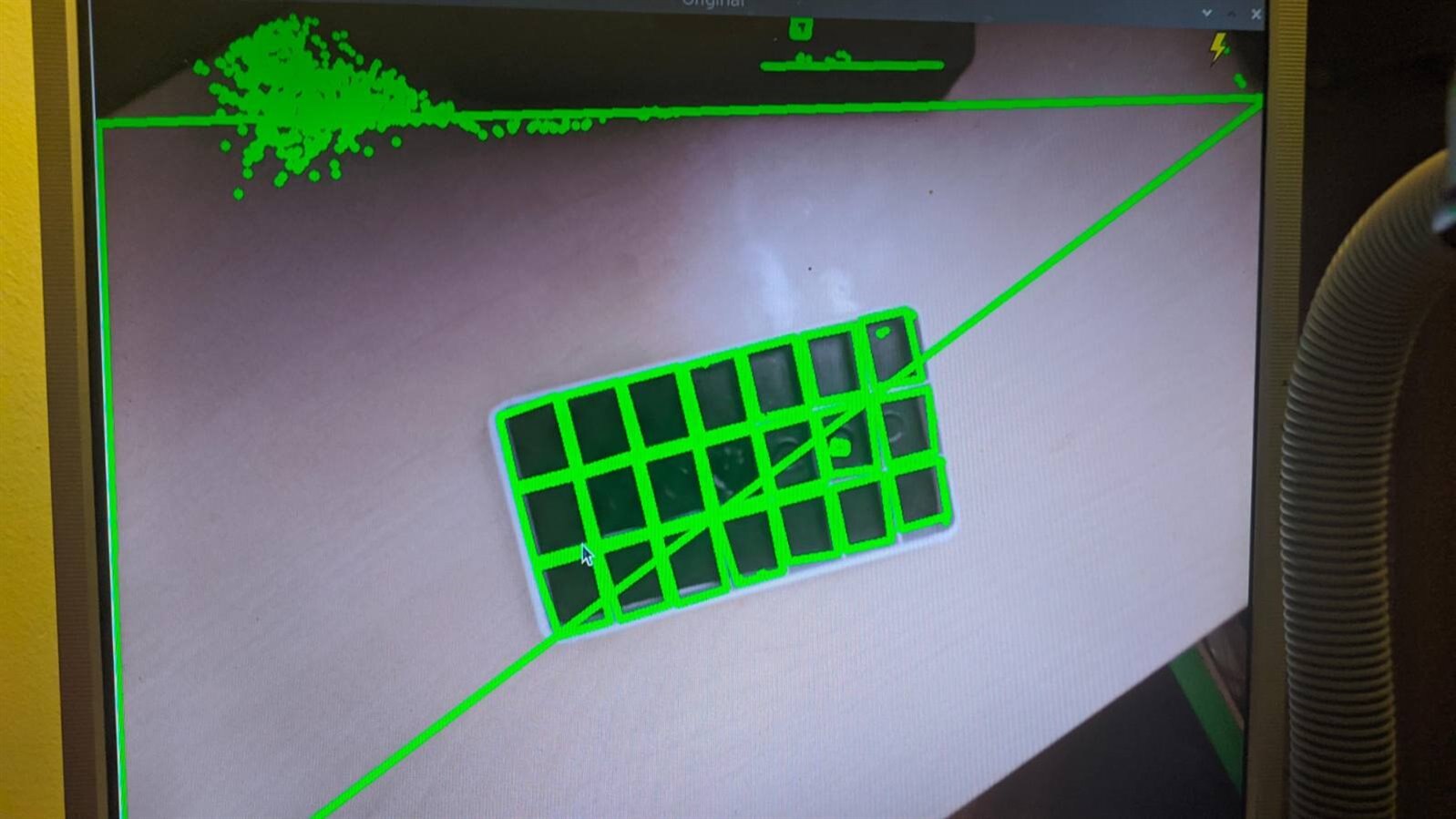

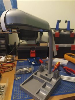

     My first attempt for tackling this issue was back in 2019. My idea back then was to use an old desk lamp, and upgrade it with a Raspberry Pi and a Raspberry camera to have an overhead look of the box and to track and count how many pills are in each of the compartments. You can take a look at that blog here: Medication Monitor - Part 1 . I've ran into some issues back then, but the main issue was I ran out of time, there would of course still be some things needed to be addressed like the glare from the lid, but I think it's doable.
You can see the lamp of the first picture and you can see the first results that I've had from OpenCV where I wanted to detect all of the individual compartments. While I did detect all of them, I've clearly also detected a lot of stuff which I shouldn't have in the process. Again, with more time, I am sure that this could work out in the end.

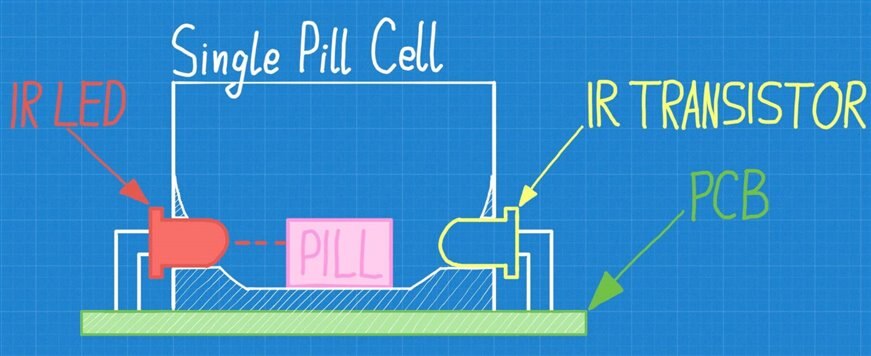

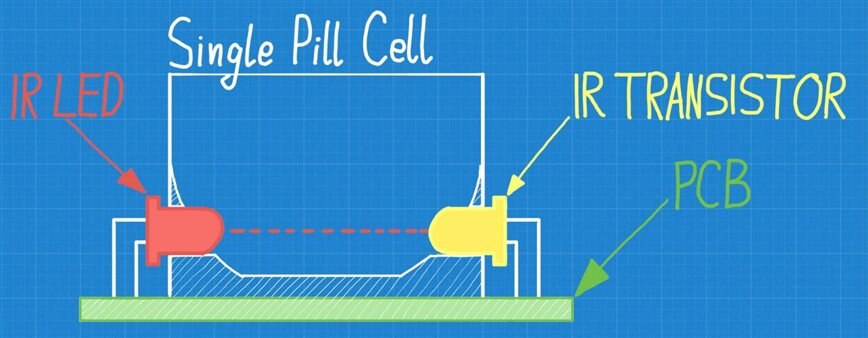

     The new concept is based on a really simple idea and requires some widely available and very cheap components. My idea is to use an IR LED and an IR transistor for each of the compartments and effectively, have a small laser gate which would detect if the there is a pill at the bottom or not. To explain better, here are some Mythbusters inspired, blueprint sketches.
When there is nothing in the compartment, the path between the LED and the transistor is free and we can easily detect that using an analog (or even a digital) pin on the Arduino. If however, there is a pill inside the compartment, then we have a situation that looks something like this.
Here, you can see that IR LED is still active, but, due to the small pill which is in the compartment, it's obstructing the path between the LED and the transistor, which we can again easily detect using the Arduino. Now, you may ask, how do we know that the pill break beam reliably when we are trying to get a reading? There are a 3 thing I'm planning to do which will immensely help with reliability and also help how easy it's to use the box.

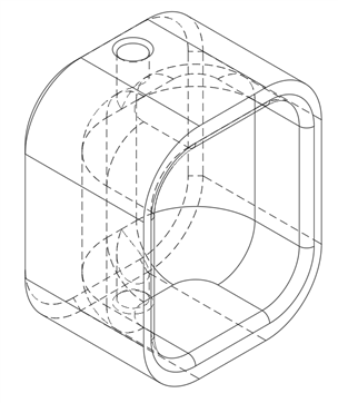

  • I will be putting both the IR LED and the IR transistor as close to the bottom of the compartment as I can
    • This way, no matter how small the pill is, I'll be able to detect it when it's at the bottom of the compartment.

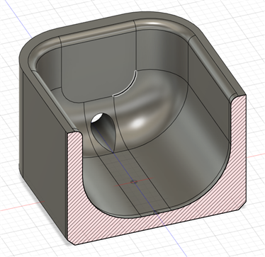

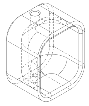

  • All of the sides of the boxes will have curved edges
    • As you can notice on the sketches above, you can see that the inner walls curve inwards. This proved to be a great thing because of 2 reasons. One, it will center the medication much better so we will have more reliable readings and second it's so much incredibly easier to take out a pill out of the compartment when we have curved edges rather than sharp 90 degree corners like is the case with most pill boxes.
  • I will be using the integrated IMU on the Arduino Nano 33 IoT board
    • This system is designed to look for the pills which are the bottom of the compartment, if the box is upside down or at some weird angle, there really isn't a point of trying to get any readings. So, to have reliable readings, I will only do the readings when I can check with the IMU if the box is at some normal angle where the pills would actually be at the bottom of the compartments. Another safety feature which can be implemented would be if we detect and open box while it's upside down, something is clearly wrong...

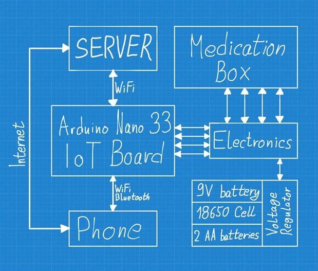

With those 3 design methods in mind, we will be able to get very reliable and consistent readings for all of the compartments. I've touched upon on how I plan on integrating all of the features that I've talked about, but this is something that I will develop more as the project is moving forward. The idea for the whole layout of the box would be something like this.

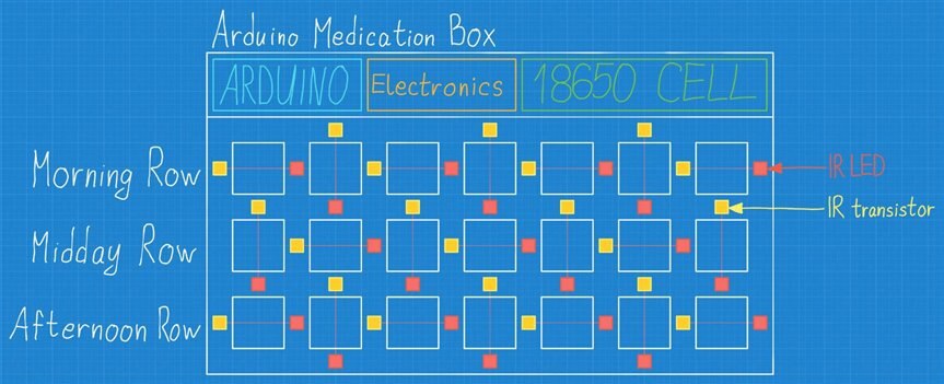

By placing the LED and transistor alternatingly horizontally and vertically, I can achieve a layout where there is a maximum of one IR LED/transistor on each of the side of compartments making everything uniform and as compact as possible. Besides that, in the back we will have the Arduino, the other necessary electronics and a 18650 LION cell for powering the whole thing. I have a few ideas for some alternative battery options, but this is the one I will focus on the most for sure. I've worked out the details on how I plan on integrating so many sensors with not so many pins for the next blog, but I think one word will explain a lot and that is multiplexer. This is my current plan for the project as a whole.
A lot of the stuff from the picture I've already covered in great detail, the things I haven't covered that much are on the left side of the picture. Since the Nano33 IoT has WiFi capabilities, the idea is to of course have it connected to the home WiFi where it can store all of the data online which I can then fetch with an Android app. The only thing I'm trying to work out still is how to go through the initial setup of connecting the board to WiFi without having to hardcode it into the device. Some first idea for me was to use the Bluetooth capabilities of the board for the initial setup, but, if you have any better ideas for that, please let me know.

     I of course wouldn't put so much time into planning without at least conducting a small test to see if the idea is feasible at the first place. To do this, I designed and printed a small single cell compartment with 3.2mm holes on either side just enough for a snug fit for the IR LED and IR transistor.
I wired up the IR LED with a current limiting resistor, and wires up the IR transistor in a voltage divider with a resistor and then attached that to a pin of the Arduino. Happily, the experiment worked great and really reliably, I didn't get a single error when it comes to the pill detection. Here is a short video demonstrating my test.

5. Standard pill organizer
     To kick off, I designed and printed a simple pill organizer as a test, to see what my grandma and family members would think. They really liked how it turned out. For designing this box I kept to the principles I described above, I wanted a more secure lid, I wanted it a darker color and I wanted rounded edges at the bottom of each compartment so the pills can be picked up more easily. The size of the single cell compartments is the same as the one in the test. If you want to try printing out this box, you can find all of the files here: 3D printed pill organizer.

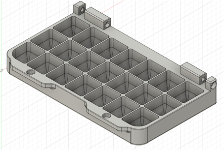

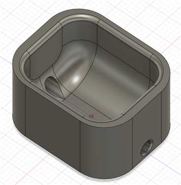

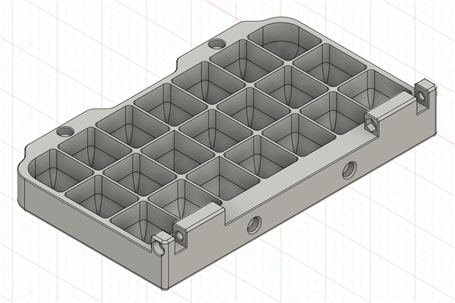

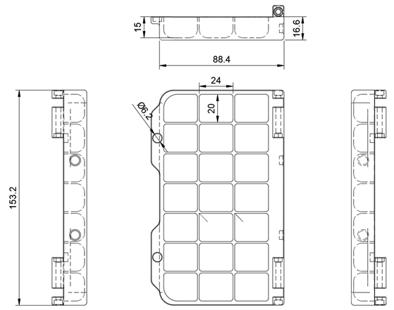

Let's begin with the design of the box
It keeps the 3x7 layout because my grandma is used to it. Instead of a sliding lid it has a lid with a hinge. I like the idea of a sliding lid more, but I'll need to work it out how to make that work properly. To keep the lid close you can see 2 holes at the front of the box which are used for magnets, there is a matching set of holes on the lid.

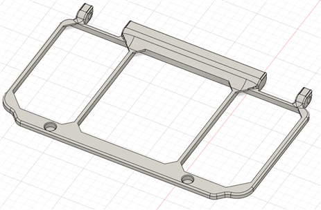

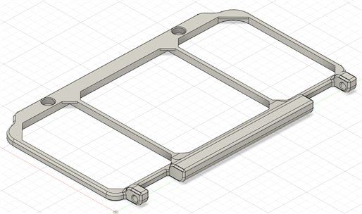

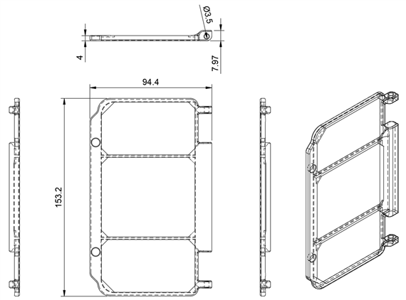

Lid

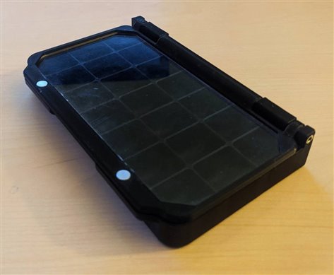

The second part that needs to printed is the lid. It has a matching set of holes for the magnets, and has the negative of the hinge design in the back. For the hinge, I just used some M3 screws and nuts.
There will be one more thing needed, which isn't printed, and that is some clear plastic/acrylic. The top needs to be see through so it needs to be made out of some material like that. There are 2 versions of the lid, one is a single window version and the other one is a 3 window version. You can find both files on GitHub linked above and below.

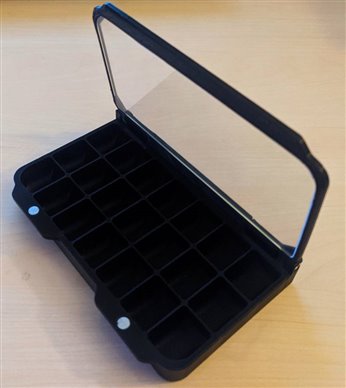

This did need a bit of time to print, since these aren't the smallest items, but they printed without any support needed. The box is a bit counterintuitive, because it needs to be printed on it's backside. I designed it like this so that there is a curve in one direction which is really nice instead of just layer on top of layer. Here is how the finished box turned out.
The acrylic is a bit of a finger print magnet, but it fit in perfectly. I managed to cut it just by using a knife and scoring it over and over and then using a file to get it just right to pop into place. There is a really satisfying click when the magnets close up the lid.

    That would make the job easier for the PCB design and the design of the compartment would be cleaner with a small indent for the photoresistor. Something like this is pretty flat and would work perfectly.
    The only problem I would need to overcome is to get light into the compartment reliably. I could have a base reading with one of these at the top of the box, but maybe half the box is in shade, or it's just too dark in the room, so I can't rely only on ambient light. It could maybe work if I had an LED at the top of each compartment somehow, which could also be used to indicate from which compartment the next pill is. Seems like an interesting idea, I'll take a look into it more!

    Looking at your concept, you could recess the detector down into a hole so that only light from directly across the cell can reach it.

    That's why I went with IR, though, I found out that sometimes, a phone with the camera turned on can trigger the IR transistor if it has IR distance sensors.
