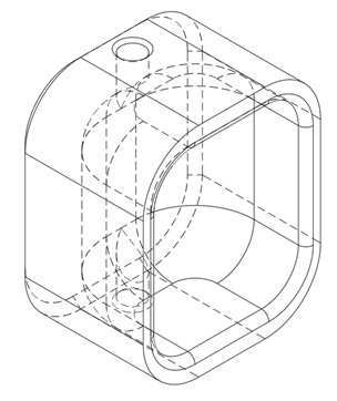

  • I will be putting both the IR LED and the IR transistor as close to the bottom of the compartment as I can
    • This way, no matter how small the pill is, I'll be able to detect it when it's at the bottom of the compartment.
  • All of the sides of the boxes will have curved edges
    • As you can notice on the sketches above, you can see that the inner walls curve inwards. This proved to be a great thing because of 2 reasons. One, it will center the medication much better so we will have more reliable readings and second it's so much incredibly easier to take out a pill out of the compartment when we have curved edges rather than sharp 90 degree corners like is the case with most pill boxes.
  • I will be using the integrated IMU on the Arduino Nano 33 IoT board
    • This system is designed to look for the pills which are the bottom of the compartment, if the box is upside down or at some weird angle, there really isn't a point of trying to get any readings. So, to have reliable readings, I will only do the readings when I can check with the IMU if the box is at some normal angle where the pills would actually be at the bottom of the compartments. Another safety feature which can be implemented would be if we detect and open box while it's upside down, something is clearly wrong...
With those 3 design methods in mind, we will be able to get very reliable and consistent readings for all of the compartments. I've touched upon on how I plan on integrating all of the features that I've talked about, but this is something that I will develop more as the project is moving forward. The idea for the whole layout of the box would be something like this.
By placing the LED and transistor alternatingly horizontally and vertically, I can achieve a layout where there is a maximum of one IR LED/transistor on each of the side of compartments making everything uniform and as compact as possible. Besides that, in the back we will have the Arduino, the other necessary electronics and a 18650 LION cell for powering the whole thing. I have a few ideas for some alternative battery options, but this is the one I will focus on the most for sure. I've worked out the details on how I plan on integrating so many sensors with not so many pins for the next blog, but I think one word will explain a lot and that is multiplexer. This is my current plan for the project as a whole.
A lot of the stuff from the picture I've already covered in great detail, the things I haven't covered that much are on the left side of the picture. Since the Nano33 IoT has WiFi capabilities, the idea is to of course have it connected to the home WiFi where it can store all of the data online which I can then fetch with an Android app. The only thing I'm trying to work out still is how to go through the initial setup of connecting the board to WiFi without having to hardcode it into the device. Some first idea for me was to use the Bluetooth capabilities of the board for the initial setup, but, if you have any better ideas for that, please let me know.

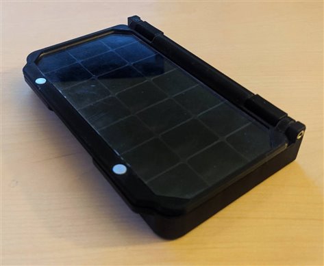

     To kick off, I designed and printed a simple pill organizer as a test, to see what my grandma and family members would think. They really liked how it turned out. For designing this box I kept to the principles I described above, I wanted a more secure lid, I wanted it a darker color and I wanted rounded edges at the bottom of each compartment so the pills can be picked up more easily. The size of the single cell compartments is the same as the one in the test. If you want to try printing out this box, you can find all of the files here: 3D printed pill organizer.
Box
Let's begin with the design of the box
It keeps the 3x7 layout because my grandma is used to it. Instead of a sliding lid it has a lid with a hinge. I like the idea of a sliding lid more, but I'll need to work it out how to make that work properly. To keep the lid close you can see 2 holes at the front of the box which are used for magnets, there is a matching set of holes on the lid.
Lid
The second part that needs to printed is the lid. It has a matching set of holes for the magnets, and has the negative of the hinge design in the back. For the hinge, I just used some M3 screws and nuts.
There will be one more thing needed, which isn't printed, and that is some clear plastic/acrylic. The top needs to be see through so it needs to be made out of some material like that. There are 2 versions of the lid, one is a single window version and the other one is a 3 window version. You can find both files on GitHub linked above and below.
This did need a bit of time to print, since these aren't the smallest items, but they printed without any support needed. The box is a bit counterintuitive, because it needs to be printed on it's backside. I designed it like this so that there is a curve in one direction which is really nice instead of just layer on top of layer. Here is how the finished box turned out.
The acrylic is a bit of a finger print magnet, but it fit in perfectly. I managed to cut it just by using a knife and scoring it over and over and then using a file to get it just right to pop into place. There is a really satisfying click when the magnets close up the lid.

    The pill detecting method works surprising well, it will be interesting to see if there is any drifting with time or possibly the impact of ambient light. I was thinking that maybe you could just put a light detector on the bottom of each compartment and then use ambient/external light to provide the light part. It wouldn't work in the dark though but I guess you do not normally take pills in the dark and it is possible that ambient light might vary too much to be reliable.
    Dubbie
  • milosrasic98
    milosrasic98 over 5 years ago in reply to dubbie
    That's why I went with IR, though, I found out that sometimes, a phone with the camera turned on can trigger the IR transistor if it has IR distance sensors.
    Milos
  • aspork42
    aspork42 over 5 years ago in reply to milosrasic98
    Looking at your concept, you could recess the detector down into a hole so that only light from directly across the cell can reach it.
  • milosrasic98
    milosrasic98 over 5 years ago in reply to aspork42
    That would make the job easier for the PCB design and the design of the compartment would be cleaner with a small indent for the photoresistor. Something like this is pretty flat and would work perfectly.
    The only problem I would need to overcome is to get light into the compartment reliably. I could have a base reading with one of these at the top of the box, but maybe half the box is in shade, or it's just too dark in the room, so I can't rely only on ambient light. It could maybe work if I had an LED at the top of each compartment somehow, which could also be used to indicate from which compartment the next pill is. Seems like an interesting idea, I'll take a look into it more!
