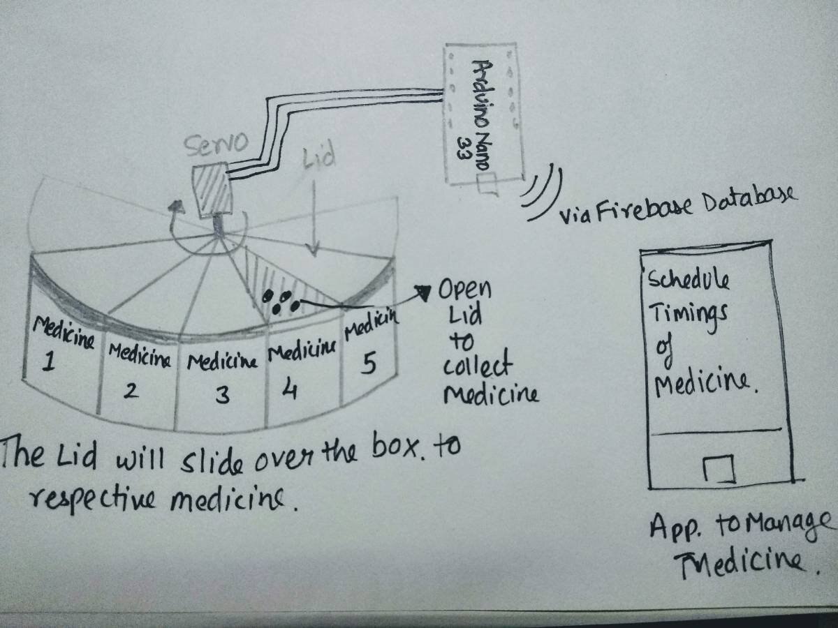

System Concept
1. 3D Printed Vending Box:
          The Box will have sliding Cover with One Open so the user can take medicine out. The servo motor will slide this cover such that the required medicine will be opened according to Medicine Schedule.
          The Box will be printed on my personal 3D Printer.
2. Arduino Nano IoT 33:
          It is the main controller of the Project, As this Board supports Firebase, I will use Firebase to store Medicine Schedule Data of the Specific Patient.
          The Servo will be driven by external Power Supply and Controlled by Arduino
3. Servos:
          I have currently Tower Pro Servo with Enough Torque to easily slide the cover of Box. And they work on 5V DC.
4. Phone App:
          The App will be created using Flutter and Firebase Database, the User will be provided with UI to add/schedule the medicine according to Name,Dosage,Time,etc.
5. Firebase Database:
          It is a NoSQL Database which has a Free Tire, It is easy to integrate with my app and also to Arduino so I am using it.
