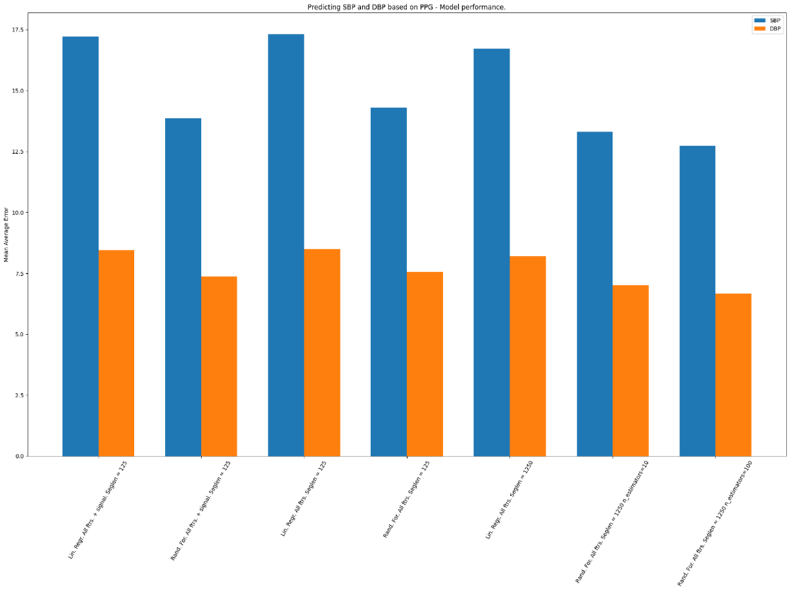

A comparison of the ABP and PPG signal is visible below:
Inspecting the SBP and DBP shows they are good enough:
The PPG signal is surely non-ideal and that is why we will need to perform some further cleaning:
For now we can create a baseline model and see how it fares. We did not extract any features yet so we do the prediction based only on the PPG signal:

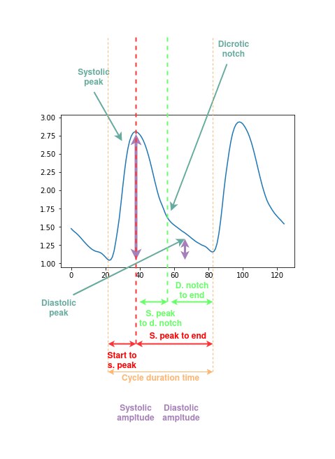

Since classic Machine Learning usually benefits from hand-picking some features from the input data, some features are extracted from the signal periods and assessed for validity. Features were chosen based on most popular ones in the recent scientific papers.
     These include:
  • Cycle duration time
  • Time from cycle start to systolic peak
  • Time from systolic peak to cycle end
  • Time from systolic peak to dicrotic notch
  • Time from dicrotic notch to end
  • Ratio between systolic and diastolic amplitude
These features are explained in more detail in the graph underneath:
The code for extraction of both features is available in the notebook.

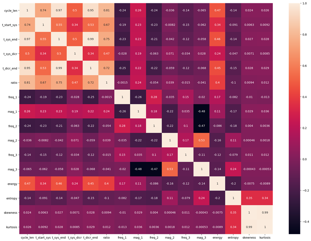

Now we can finally plot our data and see if there are any striking relations we should be aware of:
# correlation plots
plt.rcParams['figure.dpi'] = 100
plt.rcParams["figure.figsize"] = (20,15)
scatter_var = ["cycle_len", "t_start_sys", "t_sys_end", "t_sys_dicr", "t_dicr_end", "ratio",
               "freq_1", "mag_1", "freq_2", "mag_2", "freq_3", "mag_3", "energy", "entropy", "skewness", "kurtosis"]
correlation_matrix = df[scatter_var].corr()
sns.heatmap(correlation_matrix, annot=True)
It can be seen that time variables are quite correlated, which is expected. Also the energy is somewhat correlated with the time variables. There are strong anticorrelations in frequency domain features - frequency/magnitude associations.
Apart from confirmation, this plot did not give as much insight as it can in other cases, so let's move on!

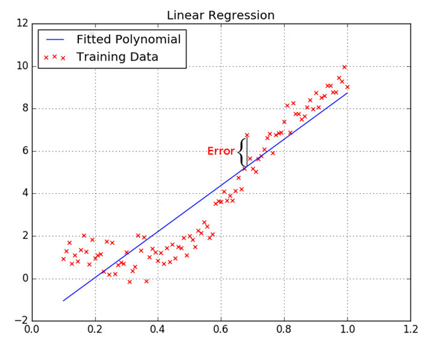

Linear Regression is one of basic ML models. It is a method which finds a relationship between a dependent variable and a set of independent variables. It can be illustrated as fitting a scatter plot to a line:
Credit: Davi Frossard
This page explains it in more detail.

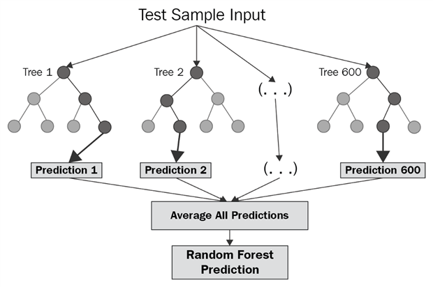

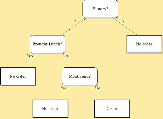

Random Forest consists of decision trees - structures consisting of nodes and branches. Trees are created by splitting the data in each node on some branching conditions. A single Decision Tree is generated similarly to asking questions about the current data input to the tree, like in the picture below:
Credit: Daksh Trehan
In a random forest the data is fed through all trees and the predictions are averaged - this is the prediction of the random forest.
Credit: https://www.oreilly.com/library/view/tensorflow-machine-learning/9781789132212/d3d388ea-3e0b-4095-b01e-a0fe8cb3e575.xhtm…

The RF model is trained in a similar way.
The results are visible in the picture below:
It is visible that the rightmost model is the most accurate - Random Forest with 10s segment lengths and 100 estimators. The results are far from ideal but they are not much worse than recent State of The Art (we have still much to improve in this area).
The most important problem we are now facing is making the data captured from the PPG with the Arduino fit our model (be normalized and rescaled). Also the PPG reading often wanders and has varying amplitude between readings, so we will have to rescale the data dynamically (averaging a period of 10 seconds or more).
