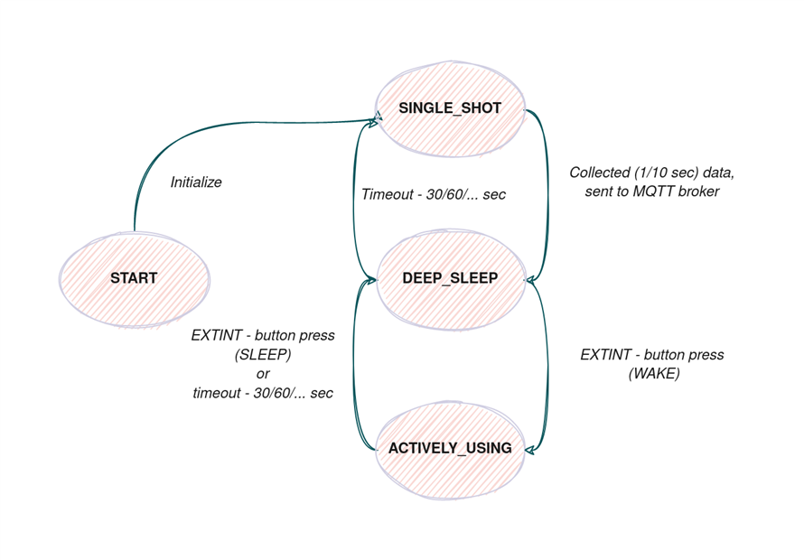

The power states of the system look as follows:
We can have the main loop running more or less frequent depending on the clients desire.

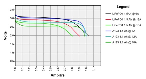

For powering the system we are using raw Arduino pins (we could also use a limiting circuit so we don't accidentally fry our Arduino image - it is always good to have some kind of protection - boards are expensive, passive components not so much!
Initially we planned to use a Li-Po battery cell akin to those used in RC cars and drones, but it had too big voltages and we found out that there exists a type of battery providing us with the just right voltage most of the time - LiFePO4! It boasts recharge-ability and better efficiency than Li-ion ones. Also the voltage is mostly flat when the battery discharges, only decaying rapidly when the battery is almost empty which is desired for our application. The graph below shows exemplary battery charge curves over time:
Credit: quora
As you can see, the graphs are very flat and this is what we need! Most of the devices onboard the Arduino need up to 3.6V and the LiPo battery would provide 3.7V when full. Maybe the only disadvantages are that charging these batteries is quite difficult and they have lower capacities (or I could not find bigger for less money).
I also found a simple DIY battery charger on hackaday.com which I will have to construct once the battery dies out!
The charger is making use of a popular element from TI - a programmable shunt regulator. The only problem with this charger is that you have to remember to switch it off to not overcharge the battery. It could be alleviated but as mentioned this is mostly a hack!

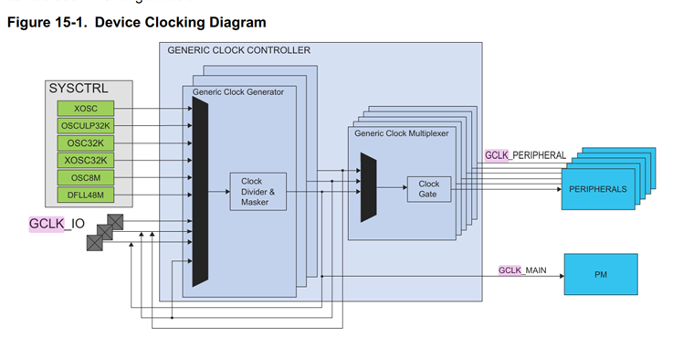

First we need to create the GCLK and connect it to the External Interrupt Controller (EIC).
Onboard our MCU we have 9 GCLKs we can enable and then connect to peripherals. The code below creates one of them and connects it to the EIC:
    // create a generic clock generator for the EXTINT peripheral system
    GCLK->GENDIV.reg = GCLK_GENDIV_ID(3) |
                       GCLK_GENDIV_DIV(0);
    while (GCLK->STATUS.bit.SYNCBUSY);
    GCLK->GENCTRL.reg = GCLK_GENCTRL_ID(2) |
                        GCLK_GENCTRL_GENEN |
                        GCLK_GENCTRL_SRC_OSCULP32K;
    GCLK->CLKCTRL.reg = (uint32_t) (GCLK_CLKCTRL_CLKEN |
                        GCLK_CLKCTRL_GEN_GCLK3 |
                        (EIC_GCLK_ID << GCLK_CLKCTRL_ID_Pos));
As you can see there are three registers we need to configure: GENCTRL, GENDIV and CLKCTRL.
GENCTRL - Controls the generator and clock source
GENDIV - Controls the prescaler of the clock
CLKCTRL - Controls the Generic Clock Multiplexer
If you seek even more information about GCLK, be sure to check out this blog post and the official datasheet!

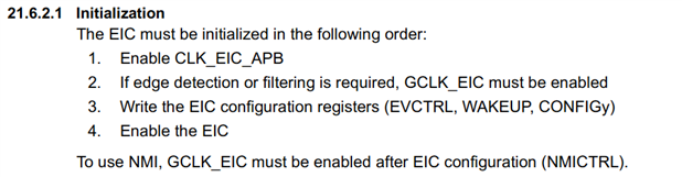

Basing on the graph above, we can start activating and configuring the necessary peripherals basing on EXTINT's requirements:
The first precondition is by default satisified, the second one we just configured, so now we will focus on the third one!

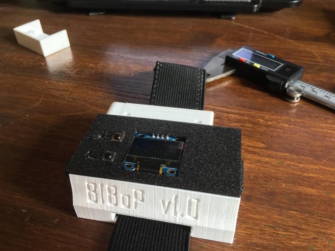

Case sneak-peek(s)
Below is a sneak-peek of the casing for BIBoP, designed in fusion 360 by us!
Rendered 3D modelimage
assembled 3D print
