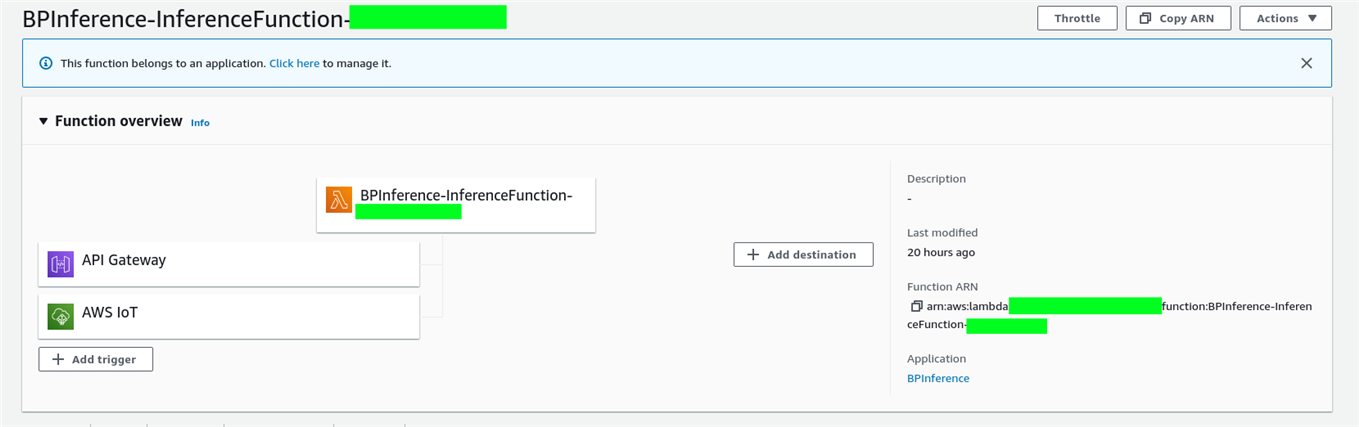

Now you should see something similar to this picture:
We have our Lambda with an API Gateway meaning we can send HTTP requests to an endpoint. Unfortunately I could not send HTTP POST messages from the Arduino over the secure channel and after several (more like several dozen) hours of fruitless pursuit I decided to switch to MQTT and for this I had to prepare several other things.
We will talk about MQTT more later - it is a protocol used for communication between IoT devices.

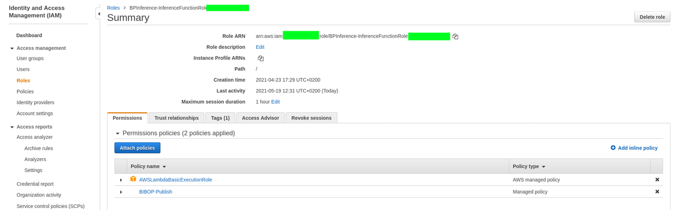

We will use the word policy to describe a set of rules which allow/deny the components of AWS to communicate between themselves and more!
Go to IAM and create a new policy:
In this policy we allow the policy holder to Publish to a topic /bibop/* (* - is a wildcard, meaning that any other child topic will match).
We now have to add this policy to our Lambda:
As you can see, we have two policies added: AWSLambdaBasicExecutionRole and BIBOP-Publish(our custom policy).

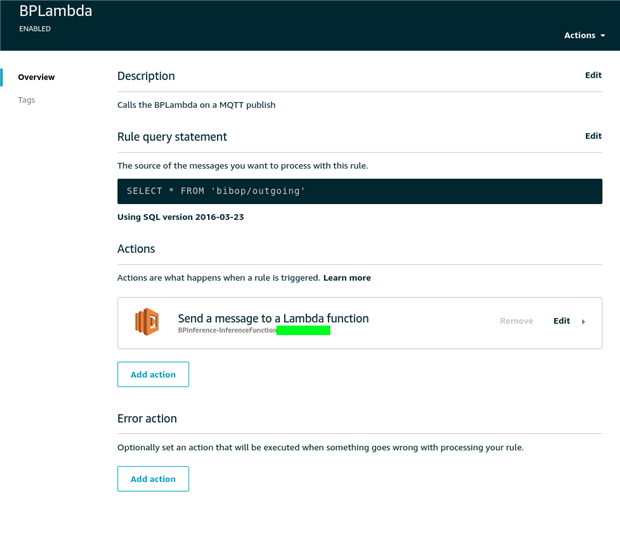

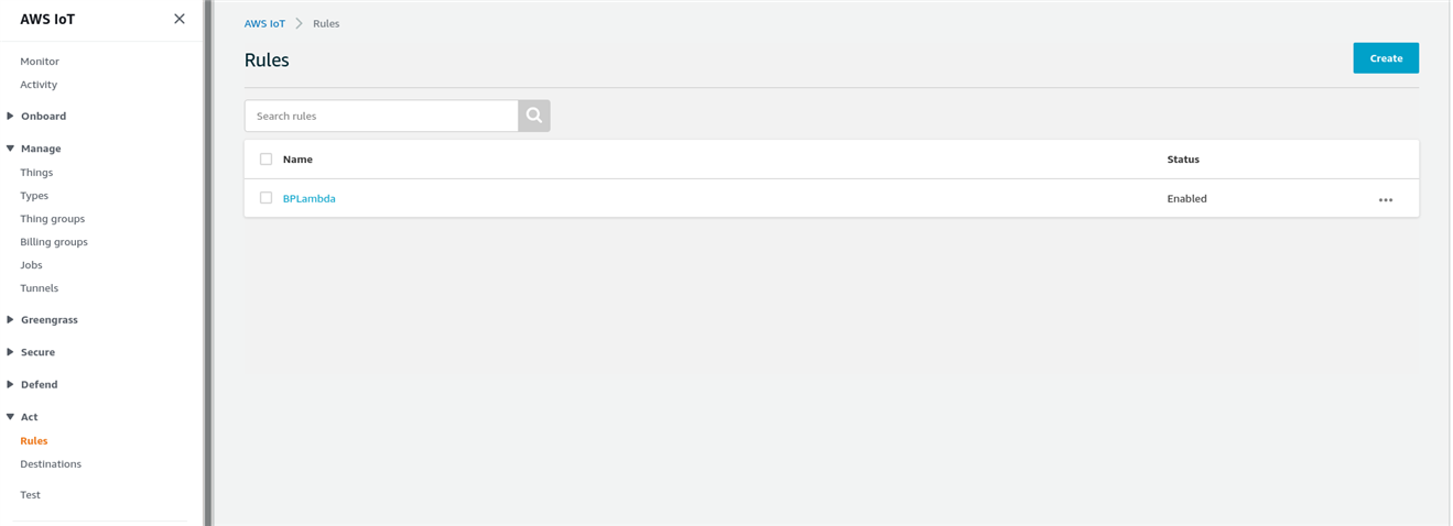

Now all we need to do is create a hook which will subscribe to a particular MQTT topics and forward our messages to the Lambda.
For that we will add a custom Rule which will trigger whenever there is a published message to a topic bibop/outgoing:
The rule looks as follows (it utilizes an SQL-like language for specifying conditions and a choice of actions).

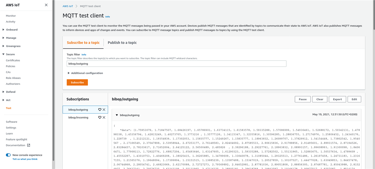

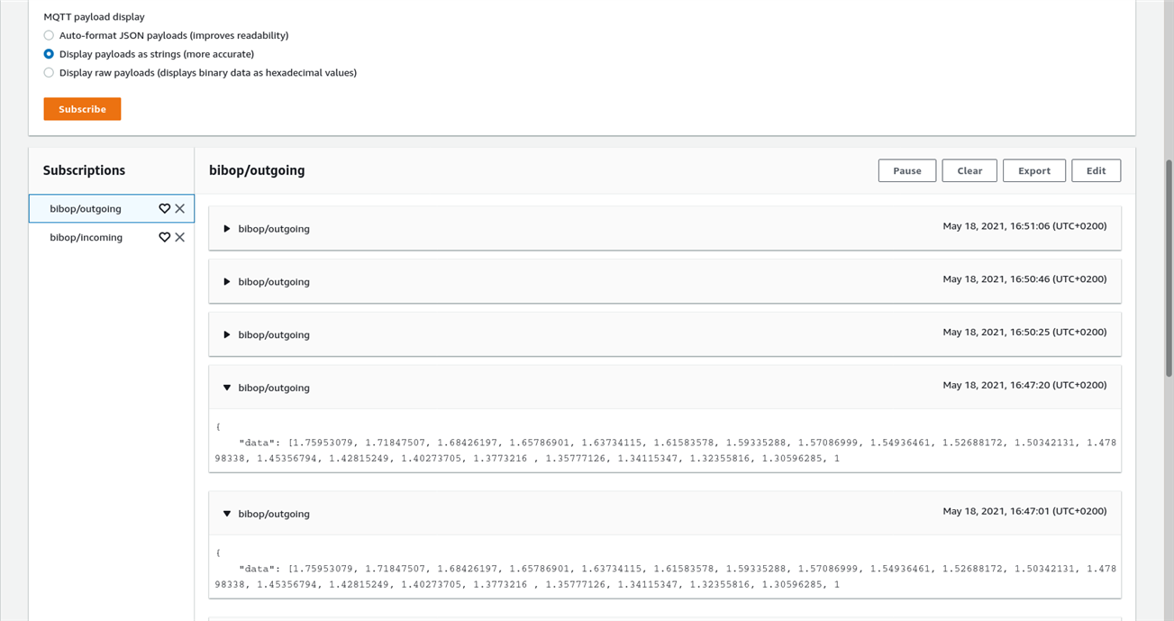

We can test our functionality by utilizing AWS IoT Test panel, where we can subscribe and publish to topics:

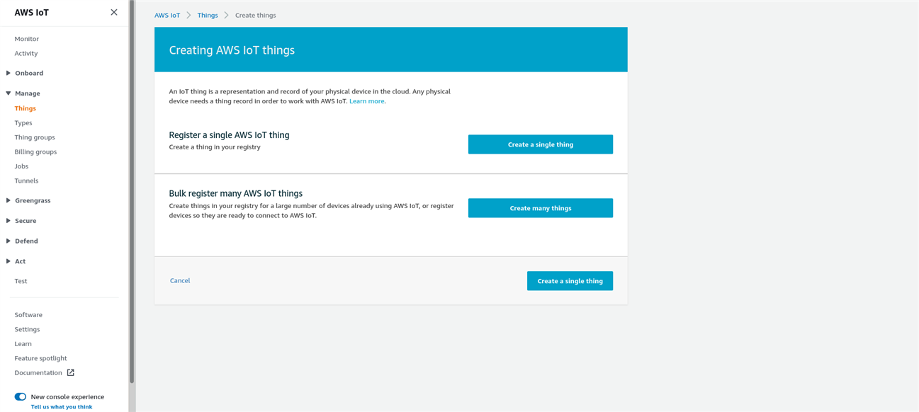

So far we were building our backend but we haven't yet configured our Things - devices which will be talking in our network. We will do so in the same subsystem we have used for MQTT configuration - AWS IoT Core.
In there we need to Create our Thing:
  • On the first page just give a meaningful name to your Thing.
  • On the second one, you will be generating a certificate for it, and in my case I decided to Create it with CSR(Certificate Signing Request), which I generated using following script.
  • After obtaining the CSR and saving it, you can upload it to the AWS and proceed with the registration.
  • Next you have to attach a policy and/or create it - I chose to allow all actions for all resources in this case, but in a production environment you should use less permissive settings.
  • Finally you obtain your certificates and keys which you can use for authentication

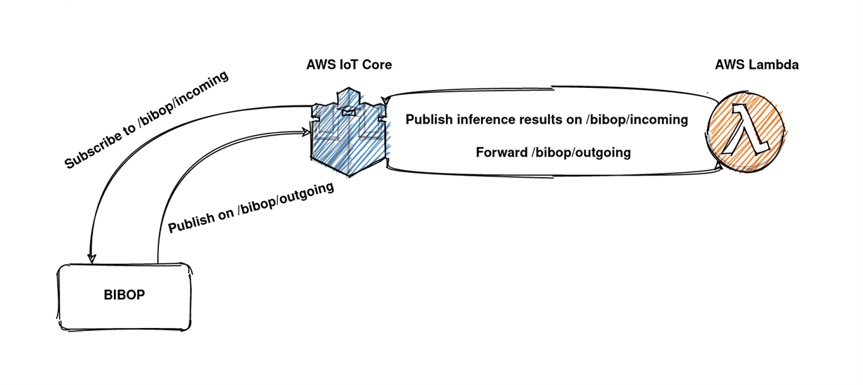

The high level overview of networking solution looks like this:
HTTP Troubles - Enter MQTT
Because of unknown reasons, I was not able to send my HTTP POST requests - they hanged forever until AWS Gateway dropped our connection. A viable alternative was to set up an MQTT broker and set up some triggers like we did above.
But what on Earth is MQTT you may ask?
I won't go into nitty gritty details of the protocol itself and instead say that it is a lightweight protocol for IoT, which is build around publisher-subscriber scheme, and which involves brokers (devices which act as packet switches in regular networks, transmitting the messages to whoever is subscribed to them).
If you peruse the attached code, you will get a grasp of how it works. Also the image above should shed some light on the subject if you are confused.

The integrated code will be shown in the next post not to spoil the power thingies image`
I was long baffled why my MQTT messages were truncated in the AWS IoT Core dashboard, like this:
Who would have thought that the developers of the ArduinoMQTTClient library had a surprise waiting for me (and not the most pleasant one by the way...) - they limited the TX message length to 256 characters, and the library distributed in Arduino library manager has this value hardcoded (0.1.5). The one upstream already has a define guard which allows the user to change it, but this option is absent in the documentation of the library. Thus, if you want to send longer buffers: set the TX_PAYLOAD_BUFFER_SIZE to your desired size.
Another obstacle encountered along the way was having disconnects as soon as I published the message. It turned out that BearSSL adds some bytes to the message payload and the library checked if the bytes transferred were equal to the message payload. I proposed a solution in this GH issue.
When I thought I have a neat and working solution, yet again I was surprised by a cosmic event - I was getting disconnects every second message I published, making me come up with nasty hacks, such as: connect, send a message, disconnect,  repeat...
