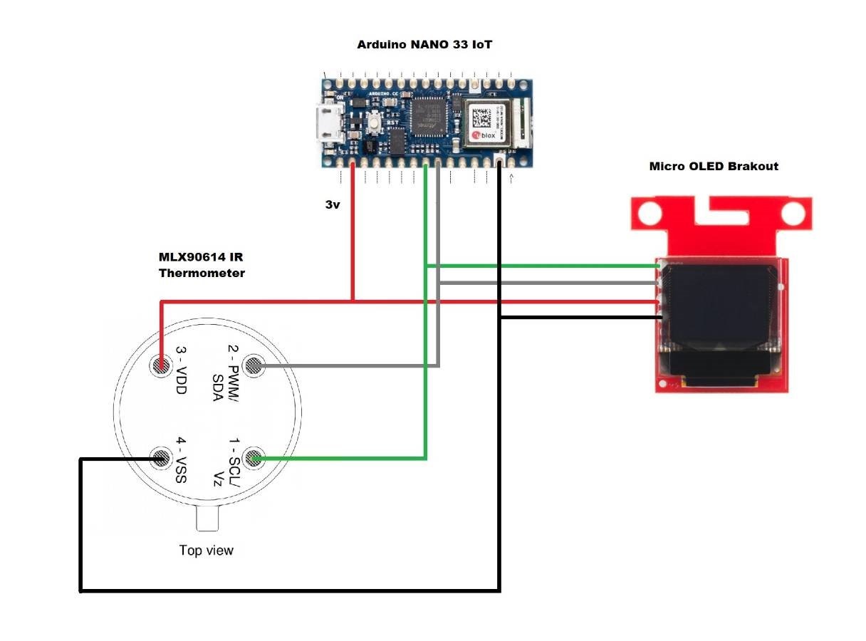

HARDWARE
Here we use the same schematic diagram from the chapter: Blog #3

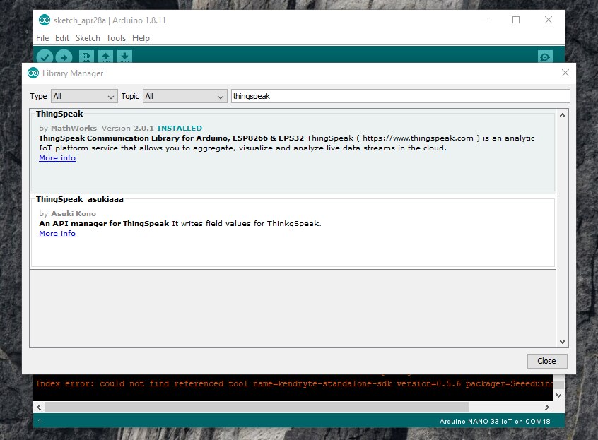

PREREQUISITES FOR ARDUINO IDE:
  • Download and install the Micro OLED Breakout display library here.
  • Download and install the MLX90614 Infrared Thermometer library here

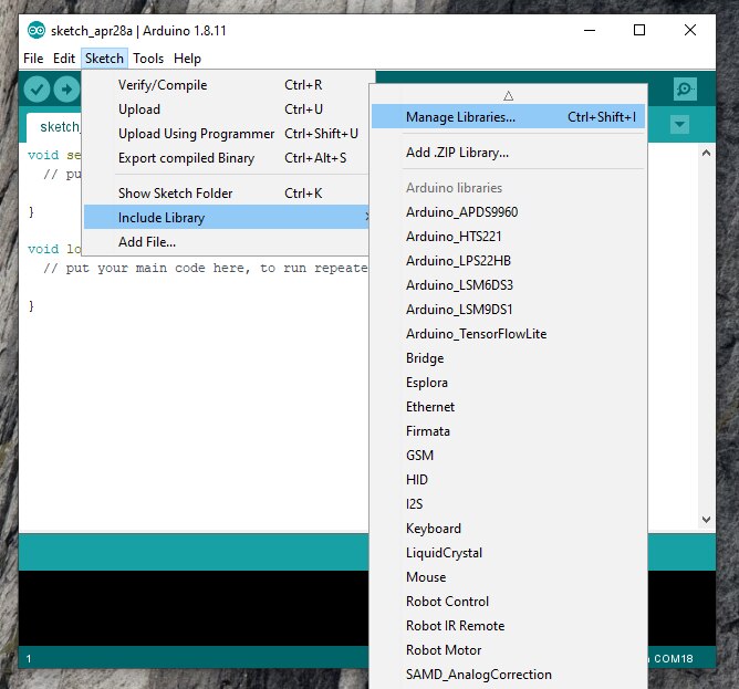

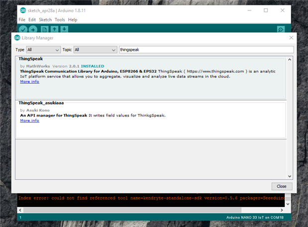

  • Install the ThingSpeak library, go to: Sketch> Include Library> Manage Libraries ...
Find and install the ThingSpeak library, by MathWorks
Once the library was installed, I used the Arduino IDE 1.8.11 to compile and upload the code to the Arduino NANO 33 IoT board. The code and comments are shown below: "thingspeak_temp.ino"
