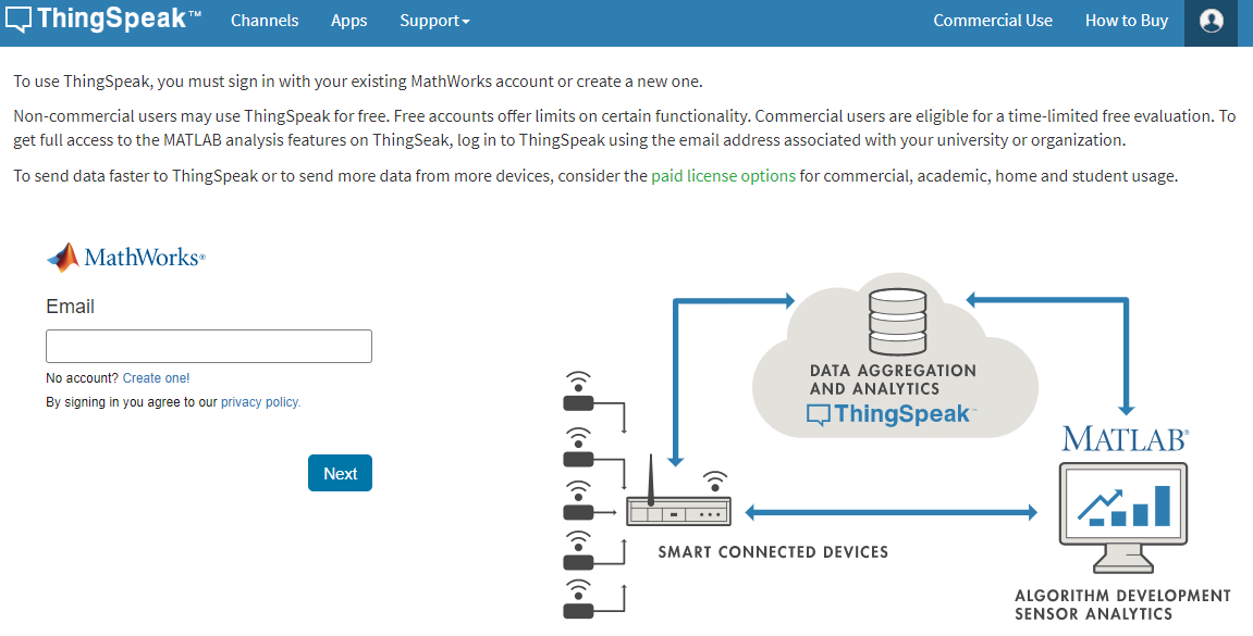

In the steps below I show you how to configure our first application using the ThingSpeak IoT service provider.
STEP 1.- First you have to open a free account on the official ThingSpeak IoT site: https://thingspeak.com/login?skipSSOCheck=true

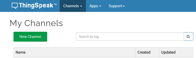

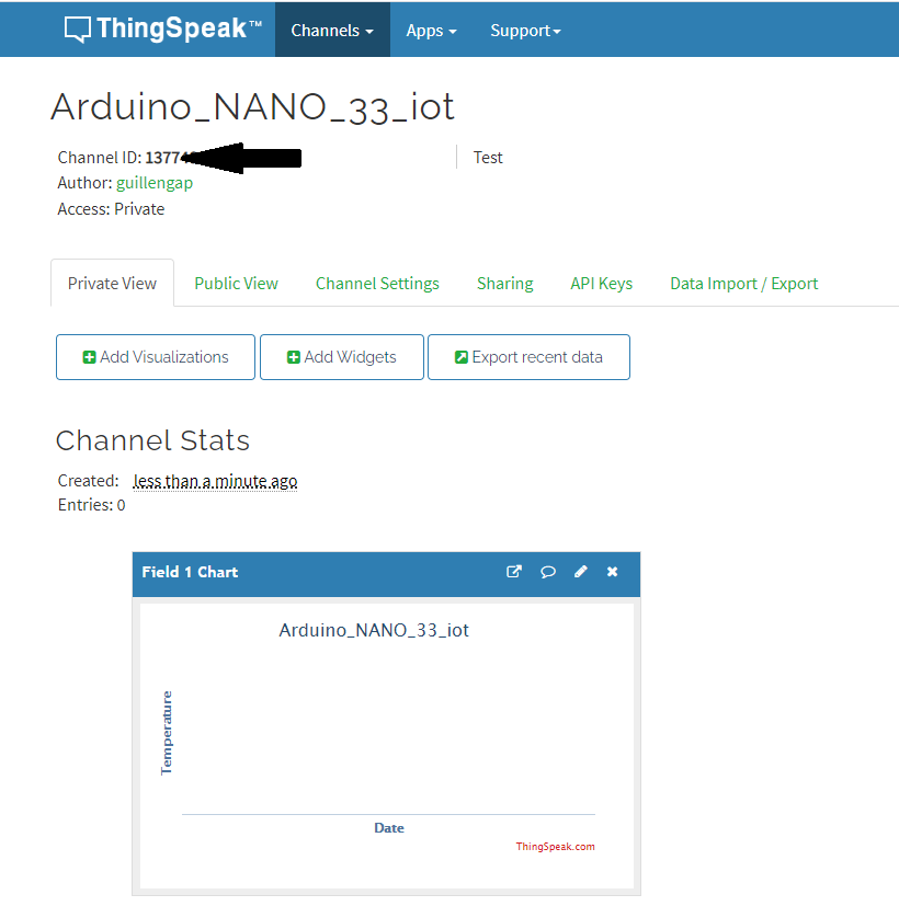

STEP 2.- Now is the time to create a new channel:

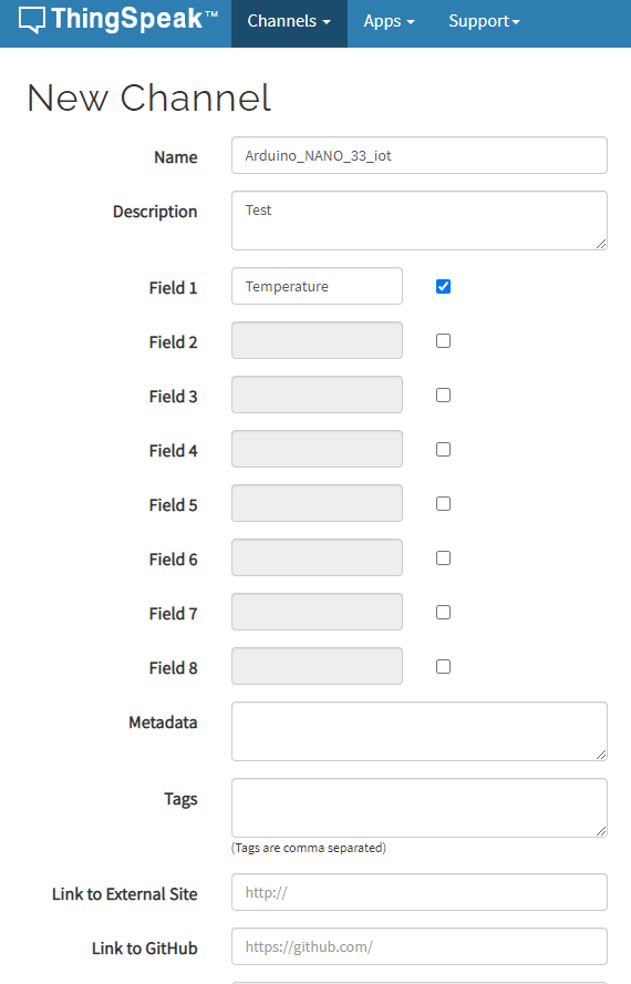

STEP 3.- Remember that the free license has a limit of four channels. Now we edit our channel with the data shown below:

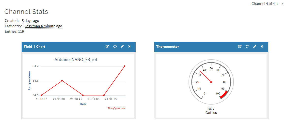

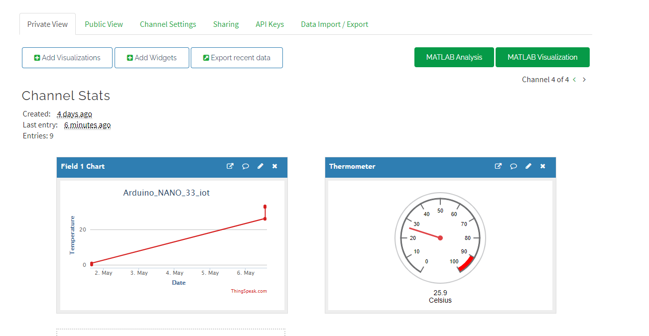

STEP 4.- Now we can see the visualization of our channel and the Channel ID value, which is useful in the previous chapter: Blog #7

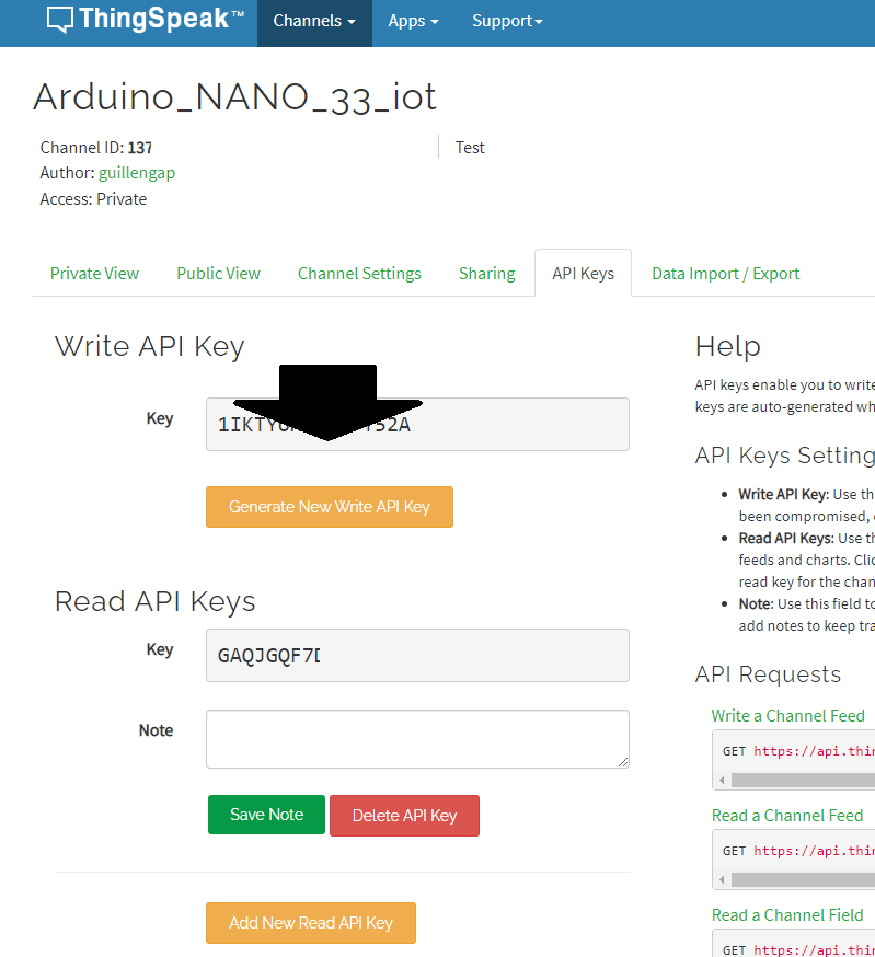

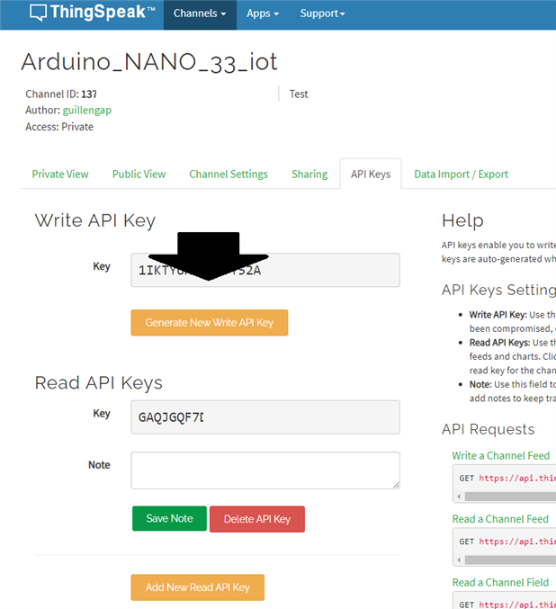

STEP 5.- In the API Key tab we see the "Write API Key", which will also be used in the previous chapter.

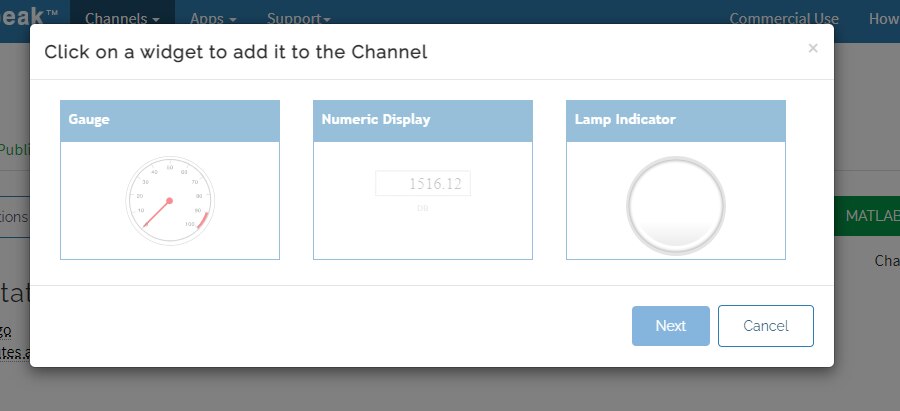

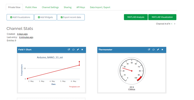

STEP 6.- Click on the gauge widget to add iit to the channel.
Finally, the image below shows how our work looks.
TEST
The video below shows the tests carried out with this IoT server.
In the image below I show you a screenshot. In the image below we can see the measured temperature, on the left is the graphic visualization and on the right a gauge.
