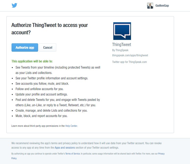

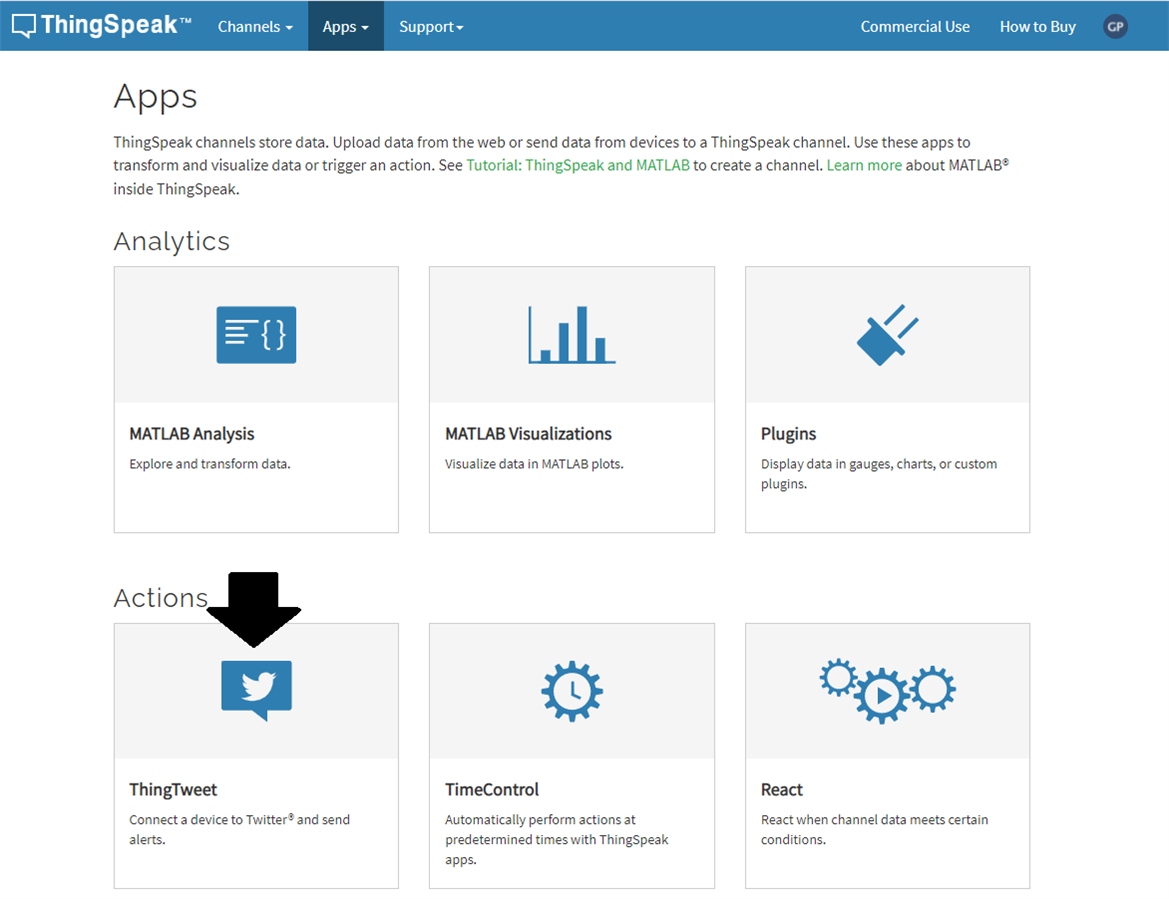

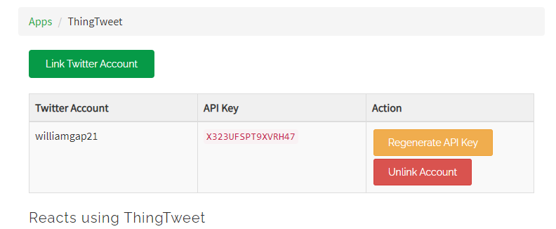

STEP 1.- First, open the application menu and select ThingTweet.
STEP 2.- Click on Link Twitter Account.

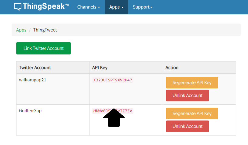

STEP 3.- Authorize ThingTweet to access your account by clicking on Authorize app

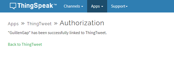

STEP 4.- The system will notify you if the link to your twitter account was successful.
STEP 5.- Finally we verify the generated API Key.

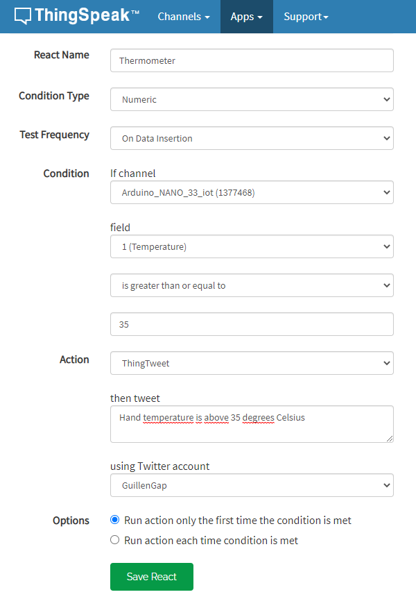

REACT APP

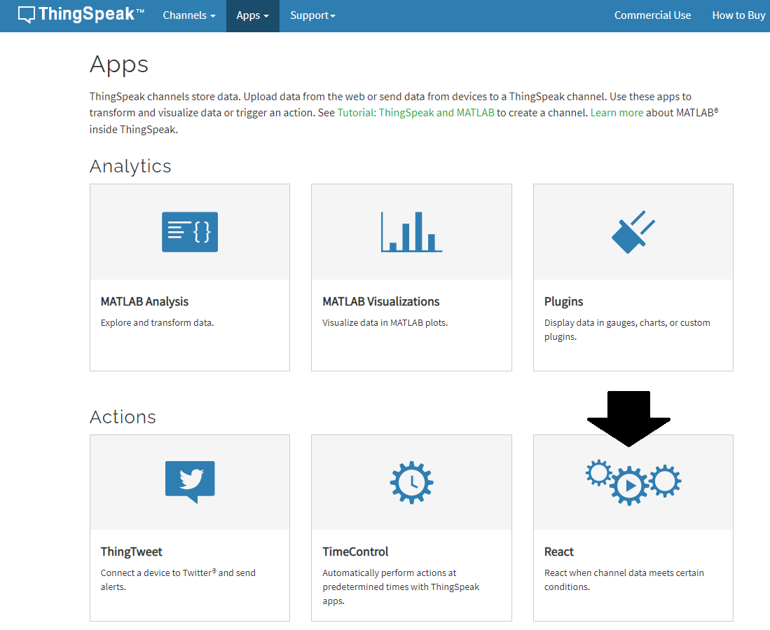

STEP 1.- Open the application menu and select React.

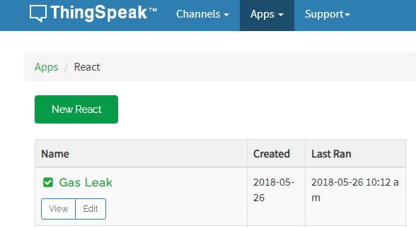

STEP 2.- Click on New React.
STEP 3.- Fill out the form shown below and save.

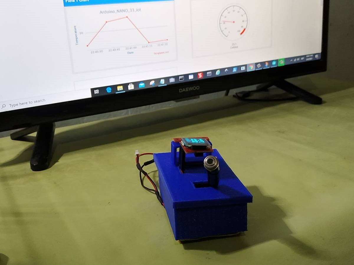

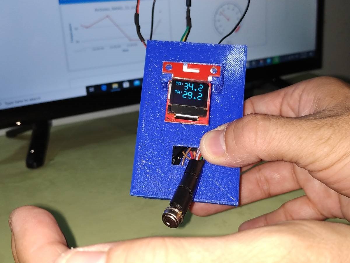

The video below shows the successful test with my twitter account.
Below is a test image.

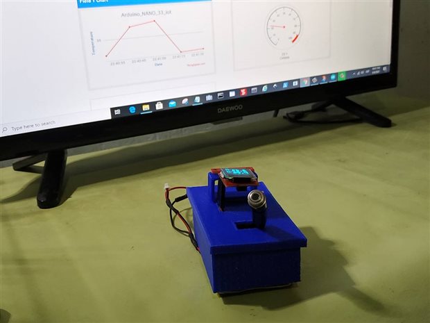

Below we see the device measuring the temperature of my hand.

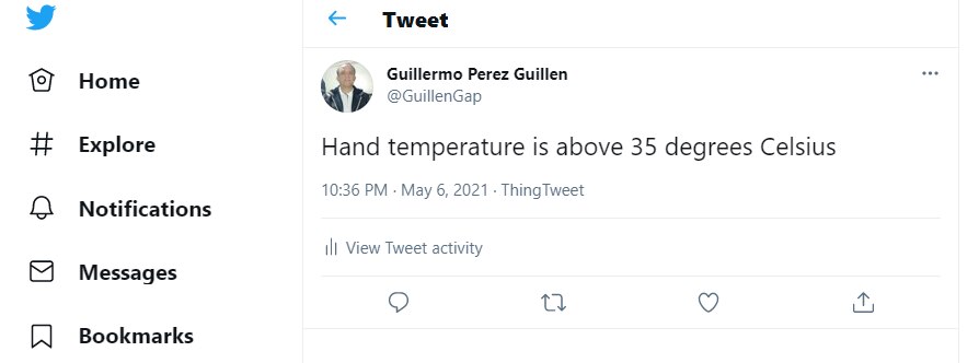

Finally, below is the Thingtweet sent to my twitter account.
