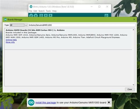

     Getting Started with Arduino MKR1000 was quite hassle-free with the help of this document found in this link. I had used Arduino IDE V1.8.5. The installation process resulted in an error while downloading the package in Arduino IDE V1.6.9. Hence I switched to the latest version. As always you have the joy when you blink an LED successfully in a new dev board. I'll try to cover some examples and code snippets which will be useful to play with the IoT bundle in the forthcoming blogs.
