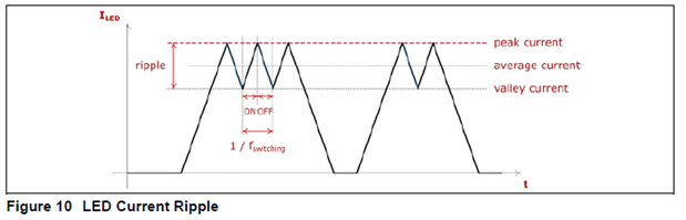

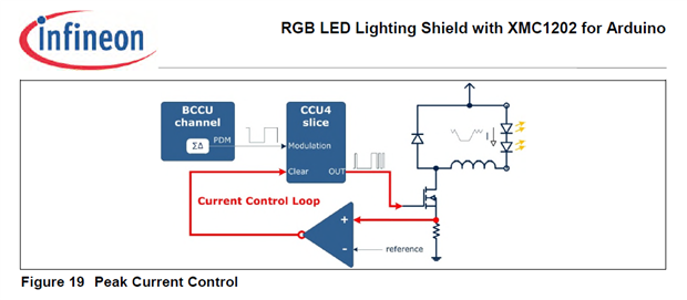

The Infineon shield does not implement large resistors to limit the current through the LEDs, rather it senses the current flow as a voltage over a small sense resistor and adjusts the modulation of the driving MOSFET based on that. To vary the current a reference voltage can be configured. It should also be possible to bring the average current down by increasing the off time parameter which in turn increases the LED current ripple.

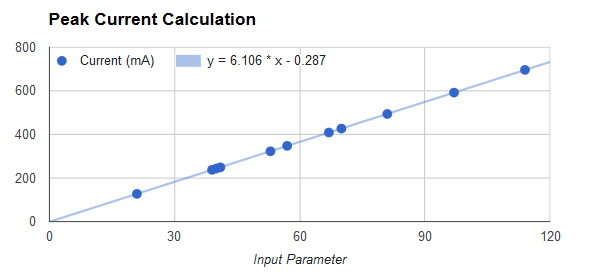

The data sheet did not provide a calculation for the current, recommending an experimental technique using an oscilloscope, it also had a big table full of examples. These values were plotted and a trend line added to produce a formula to calculate current from input parameter.
That gave a value of 3 representing 18mA or 2 representing 11mA which might be a safer starting point. The average current could then be measured with a multimeter as an oscilloscope was not available.

The first test was to see if it was possible to drive a regular red LED with no current limiting resistor. Based on the above graph/equation, the "max current" setting was set to 1, it's lowest value (although 0 has not been tried). A multimeter was put in series with the LED to measure the current. This read a little high at 24mA so the off time parameter was incremented and successfully brought that back down to 20mA. Then a little programme was written to sweep the brightness up and down. The other thing that was tested was that the shield could be run from just 5v rather than needing a higher supply, Hans had already checked the schematic, the regulator and microcontroller on the shield were capable of running at the lower voltage. This would simplify the circuitry. The Arduino was powered from an adapter and the shield from the battery with Adafruit boost regulator.
