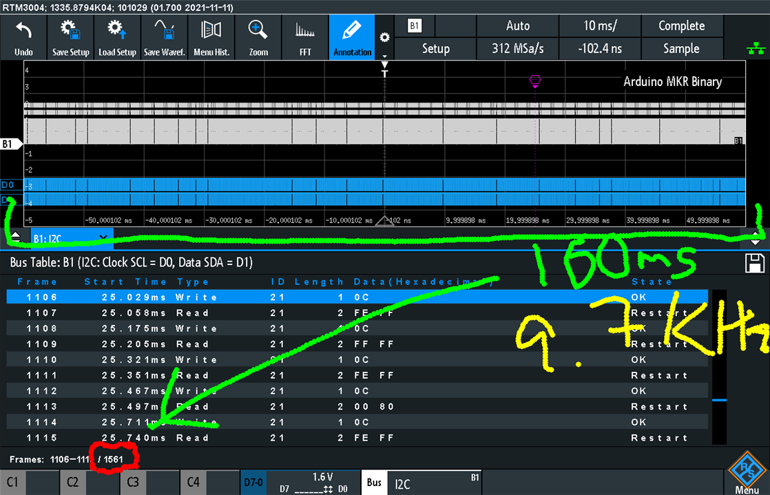

I started by porting my whole code over to the MKR which was easy enough … but I soon discovered nothing worked. As it turns out, running the I2C bus at 1MHz on the MKR just didn’t work – perhaps the Dupont wire was a stretch too far, but 900kHz worked fine so I settled for that. Already, the MKR was at a disadvantage compared to the Raspberry Pi.
Unfortunately, the performance was disappointing. Whereas I was easily reaching ~12kHz on the Raspberry Pi, the MKR was putting out closer to 4.5kSa/s on a sustained basis, with the inter-query time varying depending on the data and the transformations necessary to turn it into an ASCII value and then push that to the PC. This was not unexpected, I suppose, because the microcontroller isn’t particularly powerful.
As a result, I decided to make the job for the MKR much easier – now its job is just to read two bytes from the FIFO, decide if they are valid by checking one bit, and if so then write both bytes out on the USB-CDC emulated serial. The code was as follows:

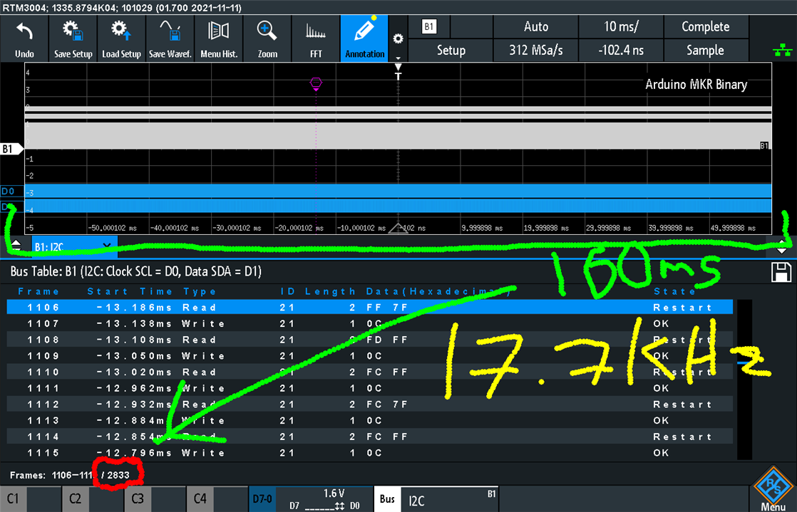

With the unit operating but the virtual CDC port closed, we were seeing a nice sample rate of about 17.7kHz.
But once the CDC port was opened, the rate was now just 9.7kHz and in practice, varied quite a bit. This again meant that despite dividing the tasks, a meaningful increase in speed was not achieved simply because of the overhead of dealing with the data. Perhaps going back to the Raspberry Pi and using C may help a bit, but perhaps the best solution would be to go FPGA-based.

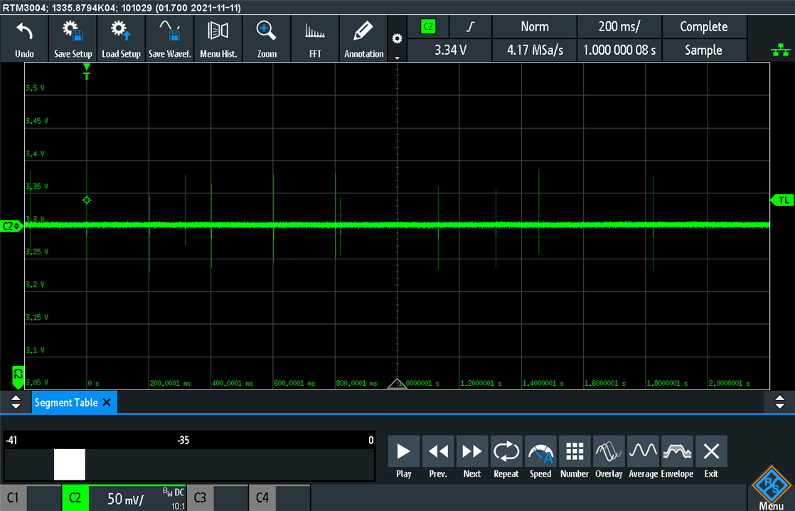

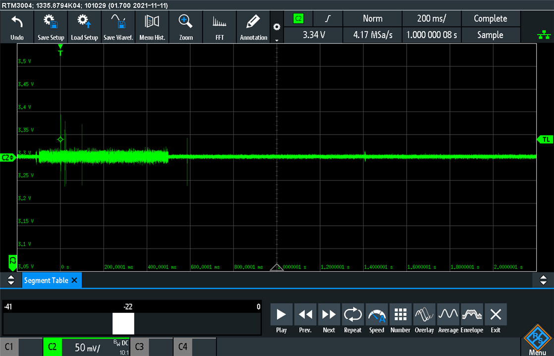

This had me wondering … what does the power on the Raspberry Pi look like? While the MAX40080 does sport fairly impressive power supply rejection ratios in its datasheet, poor quality power is usually a cause for problems.
Probing the 3.3V rail that supplies the Click, I saw some noticeable spikes, occasional periods of noise when the microSD was accessed and other quirks. It’s definitely not instrumentation-clean!
image image
While it wasn’t clean, it wasn’t dirty-enough to matter. This is because the MAX40080 operates at 1.8V and there is a linear regulator on the Click itself that should have chopped all of these dips and spikes out!
