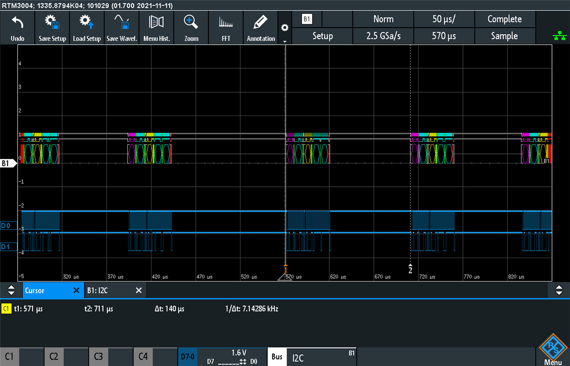

While the code works, it’s hardly optimal as it stands. For one, we’re not even pushing the I2C as fast as it can go. The chip supports the 3.4MHz HS mode, but unfortunately, I haven’t got anything that will support that as it’s an entirely different beast, being a current-mode bus and neither does the level-shifting hardware on the Click. By default, we are running at 100kHz standard mode speeds, but we can easily push this to 400kHz fast mode on most microcontrollers and even 1MHz fast mode plus.
In order to do this, a modification is needed to the config.txt file to add the following line:
dtparam=i2c_baudrate=1000000
A reboot is necessary to apply this setting. Unfortunately, after rebooting, I found a number of errors which stopped the I2C bus from working at all.
Curiously, a full shutdown, removing power and plugging back in again seems to avoid this error on a speed change.
Using the digital probe on the Rohde & Schwarz RTM3004, I verified that we were indeed signalling at 1MHz.
The MAX40080 also features the SMBus ability of using a packet error check byte with each transmission. This can be important in ensuring data integrity as the I2C bus does not feature any error detection or correction – things will just silently go flaky. Unfortunately, this adds one extra byte to every transaction which means more bus time, while also requiring some “horsepower” to compute the CRC-8 (ITU variant, which I discovered the hard way) that is used.
To do this, my Python code basically sets the configuration register to all zeroes with a pre-computed PEC byte. I initially didn’t realise the PEC byte covers address and register bytes and had no idea which variant of CRC-8 was used, so I had to do some head-scratching to figure it out. Thankfully, the chip will NACK anything that doesn’t make sense, but after disabling the PEC byte, we can basically skip the error checking with the potential for occasional errors creeping in. As our bus length is short and well-controlled, this was a risk I was willing to take.
Unfortunately, with the FIFO status checking version of the code, we were only hitting the registers at a rate of about 7kHz which is way too slow for my liking.

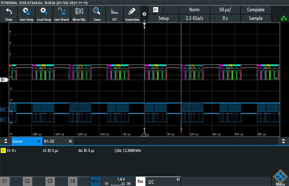

With the non-status-checking version that just looked at the data valid bit, it was possible to increase this to a rate of 12kHz. This was better, but still meant that the second-lowest sample rate of 15kHz could not be achieved!
So, while Table 9 in the datasheet has a nice colour-coded table that implies that we can probably push even 18.75kSa/s of readings, in reality, this is also constrained by the time taken by the host to process the data and turnaround the next transaction. Using a microcontroller with separate offload hardware or FPGA would probably be able to meet this level of performance, but the Raspberry Pi seems a bit distracted and Python is not ideal for performance either.
