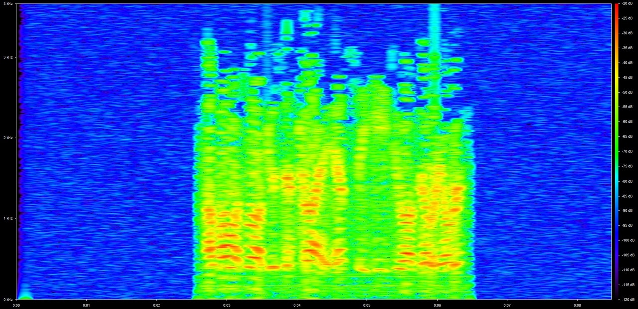

Challenge – Can You Hear the Current?
One thing I proposed testing was whether it would be possible to use the CSA to measure a current waveform that contained audio. This would be a test of both noise performance (as that would present as background hiss) as well as sample rate capability (as you’d need about 8kHz to achieve telephone-grade audio). As we previously established the noise level of the CSA itself, I decided to eschew testing of a practical device as the audio-related current could be smaller than the noise and instead sought to push a clean signal with a moderate current instead.
For this, I used the Keysight EDU33212A Waveform Generator from my Keysight Smart Bench Essentials RoadTest. For this test, I used the famous Apollo 12 “set SCE to AUX” recording which I had transformed into an .arb file compatible with the waveform generator and previously used in a modulation demonstration. A listing of the .arb file is provided below in case you want to try this for yourself on your own compatible waveform generator –
