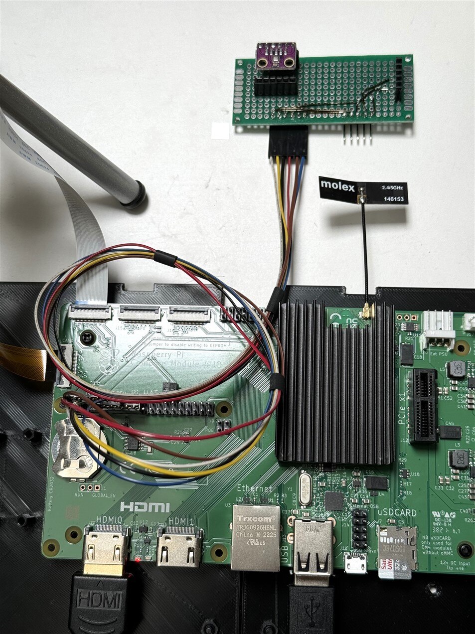

I initially started software development on an RPi4 with 8GB of memory.  I have started the transition to the CM4 + CM4 IO board assembly.  This will initially be powered with a +12V power adapter and will transition to being powered by the charge controller when the enclosure is moved outdoors.
Here is a view of my current setup.  I have the CM4 mounted on the CM4 IO board.  The WiFi antenna and heatsink are attached.  You can see the RPi4 that I was using for initial development in the background.  I have added a CR2032 battery for the RTC and am currently playing with a dual camera setup.  A V2.1 is on the left and a V3 is on the right.  I will only use the V3 in the final project.
So far, moving from the RPi4 to the CM4 setup has been fairly straightforward.  No issues with the software, just moved the SD card over.  I did have to change the cable on the V3 camera because the CM4 IO board uses a 22p 0.5mm pitch CSI connector like the RPi Zero instead of the 15p 1.0mm pitch connector on the RPi4.  Adding new features like the RTC and second camera did require adding device tree overlays to /boot/firmware/config.txt.

The front panel holds the sensors (BME280, VL53L1X, and RCWL-0516), the RPi Camera Module 3, and the Midas Display.  The sensors will be mounted on a protoboard that aggregates the I2C bus and +3.3V (BME280, VL53L1X) and +5V (RCWL-0516, Display) power.
I find it easier to use a physical layout rather than a schematic when wiring and debugging a protoboard.  I have socket headers for the sensors and right angle pin headers for the cable down to the CM4 IO and across to the Midas Display.  I also added a potentiometer for the display contrast adjustment.
The completed protoboard.  Not my best work.  I was struggling to solder the wires and I realized that my trusty 30+ year old Weller WTCPN soldering station appears to be having problems maintaining temperature.  And unfortunately in an earlier attempt at cleaning and organization I have managed to misplace my spare soldering station and spare Weller tips.  Never grow old as my mother used to say...
Anyway, I managed to finish and the connections buzz out okay.
Then I made a wire harness to connect the Protoboard to the CM4 IO GPIO connector.  I used a 1x6 socket connector with crimped pins on the protoboard end and a 2x10 socket connector with soldered connections (I didn't have one that used crimped pins) for the CM4 IO GPIO connector.
I believe in baby steps so I did a quick test of the connected boards only using the BME280 and that was successful.
