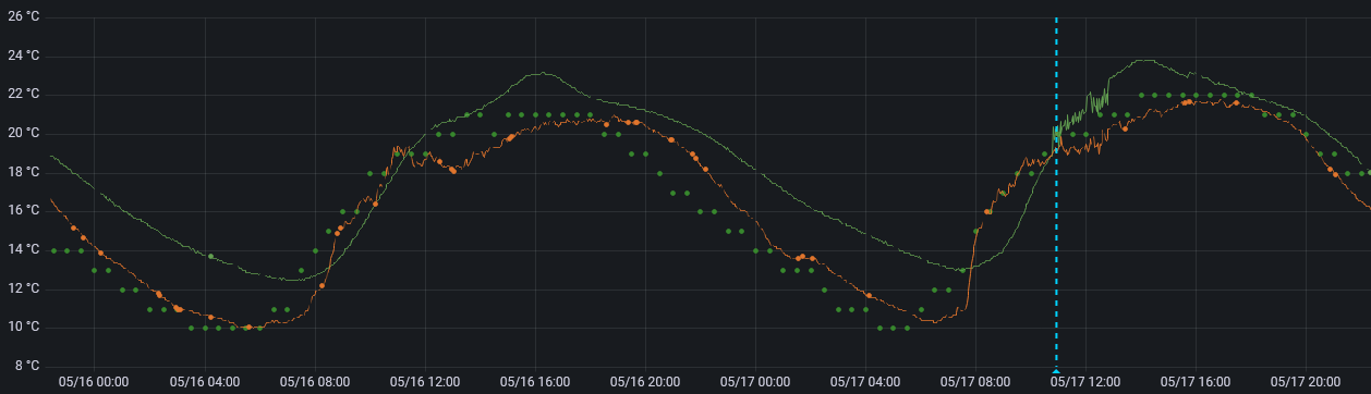

To overcome this challenge I have decided to use wireless outdoor sensors from weather station I have learned to read in the meantime.
The setup is the same as I have described a few times (for example, in PlutoSDR RoadTest) - basically, an (RTL-)SDR dongle, rtl433 software, InfluxDB as a database and Grafana for visualization.
Initial tests were like below (green dots are from METAR data, other two from local sources):
metar_vs_local
As you can see, something is amiss - local data seems shifted. After some investigation, problem was found - mechanism used was not taking into consideration local timezone: database plugin was happily inserting data using local time without timezone, which was interpreted as UTC by the database. Quick workaround later (setting local timezone to UTC at blue, vertical, dotted line)
TZ reconfiguration
and it seems that local data series fit more closely METAR measurements now.

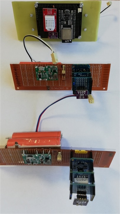

As a cost-reduction feature, I was previously using two (or three - with two generations of one module) hardware platforms (selected from group of four, using lowest idle power consumption criteria).
{gallery}Modules of old
wemos v.3
Each sensor was equipped with the 18650 cell package (retrofitted from old laptop batteries) and charger/step-up converter (like below)
j5019
by the way - this module is an interesting one: it integrates battery charger with step-up converter, that is allowing for longer battery operation time than most popular charger-only modules (which - lacking step-up part - are usually capable of powering 3.3V device only if battery voltage is at least 3.4-3.5V [taking into consideration voltage drop on next stage power supplies], which leaves much of the battery capacity unusable). It also lacks power-saving features of typical power-bank module, which proved problematic during wake-up phase (when processor was sleeping, converter reduced voltage to the level preventing SoC from reliably waking-up).
It has one drawback through - it does not include undervoltage protection, which was observed to result in undesirable behavior: not only batteries were depleted to 0V (limiting their lifespan) but processor modules, powered from too low voltage, were prone to enter undefined state (they were consuming power like in active state but without any visible effect).
To remedy this, each battery pack was modified by adding local BMS module (which includes undervoltage cut-off)
bms

Processor boards, from previously used
  • Wemos D1 mini clone v.2
  • Wemos D1 mini clone v.3
  • ESP32 develoment kit

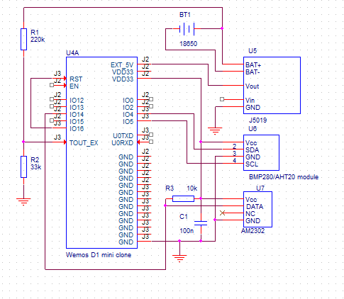

were reduced to Wemos D1 mini clone v.3, that was considered most energy-efficient at the time, resulting in the circuit as below:
sensor schmatics

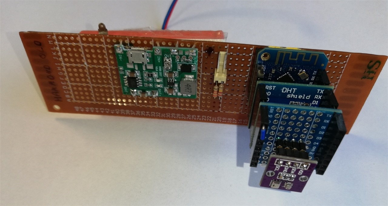

Sensor construction was done in main part as tower-of-modules - as a mean of increasing flexibility (one can easily exchange individual modules) - like below:
sensor construction
but several problems were observed:
  • precision socket (between purple AHT20/BMS280 daughterboard and base module) - never problematic when using DIL packages, was found prone to contact problems when using in such a short run as SIL (single in line) setup,
  • extended goldpin contacts (working as sockets at the one side of PCB and pins at the other and allowing for easy stacking) turned out to be thinner than usual goldpin, easily bending and also creating some connectivity issues,

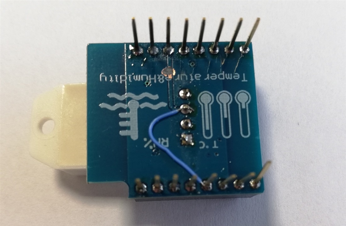

DHT22 modules for Wemos D1 mini had to be modified (moving data line from D4 to D5 GPIO), because originally they were using the same pin as connected to the LED on main board, preventing communication:
DHT22 module modification
