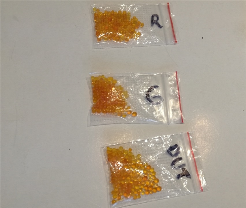

To reduce the influence of humidity already present in the enclosure to the test results, I have bought some humidity absorbing silica gel. I have decided to use version that is changing color when used-up. As a side note - color change seems to be reversible when the gel dries up.
But what use will be of color-changing silica gel when it will be put in a opaque package? So, improvised transparent package was made:
Then absorbers for all three enclosures were created (with about the same amount of the gel - which puts our test enclosure in disadvantage by the way, because of it's three times bigger volume).

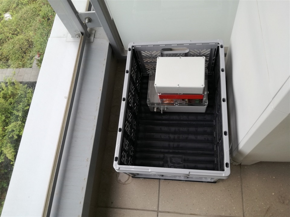

And put to the test (on the balcony, protected from direct rain and sunlight shining into the sensors - AM2302 datasheet states that direct sunlight can affect measurement results).

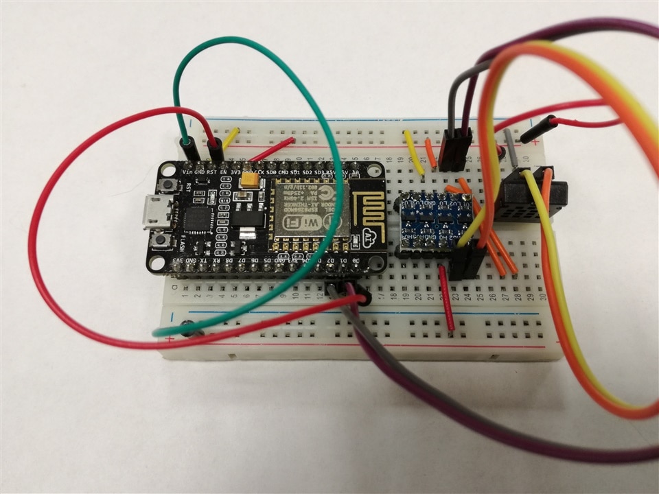

 First, proof-of-concept sensor was NodeMCU board based and looked like this:
It worked, but the power consumption was unacceptable. As expected duty cycle of the sensor is like one reading every ten minutes, some power measurement method for systems with uneven energy consumption was needed. As I didn't  own a proper power profiler during the test (it has changed in the meantime - Element14 has granted me one as a prize in Project14 "RFID or NFC" competition), I had to build my own (primitive but sufficient in my opinion).
It turns out that chipset power consumption is one thing, but typical board includes additional components that can also be power-hungry. Those components are usually: USB-to-UART bridge and power regulator (plus internal structure of the ESP module - that usually includes at least external flash memory). Some boards even have always-on LEDs as power indicators...

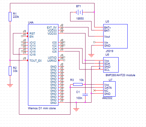

And the last part - sensors. I have decided to use popular DHT22-like sensors (AM2302 with one-wire interface and AM2320 with I2C interface). They can be powered from 3.3V so could be directly interfaced with ESP module.
That have led to sensor module schematics as a below:
It has voltage divider to measure battery voltage (designed for direct ESP8266 connection - with allowed voltage range of 0-1V. Wemos module has additional divider built-in, allowing for 0-3.3V input voltage range - which is somewhat limiting the precision of measurements in my case) and one sensor connected.

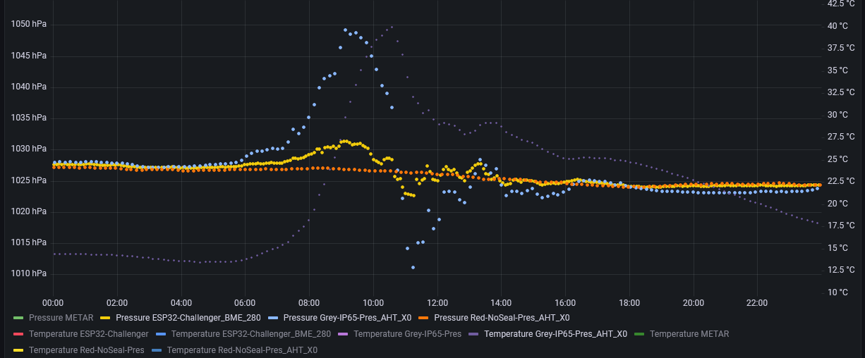

As it seems that temperature and humidity are not only factors worth considering in this project, I have decided to add some additional sensors.
Having some doubts about precision of installed AM2302 modules, I have added BME280 I had in my possession at first. Unfortunately, I cannot check it's originality - original chips have Bosch logo and clones are said to not have it, but it is so small I cannot recognize it using magnifying glass I have - maybe simple microscope would be needed.

Schematics of this sensor board is as below:
In the next step I decided to add BME280 modules to the existing two boards - but considering their recent significant price jump I have selected something cheaper - combined module of BMP280 and AHT20, resulting in final ESP8266 board schematics like this:
One side note - there are forum posts on the Internet that those modules from time to time ship with non-working BMP280 chip. I had such a situation, on one of two modules I bought BMP280 chip returned chip_id of 0x0 instead of correct value (AHT20 was working). Fortunately, the seller promptly sent replacement board when notified about this problem.

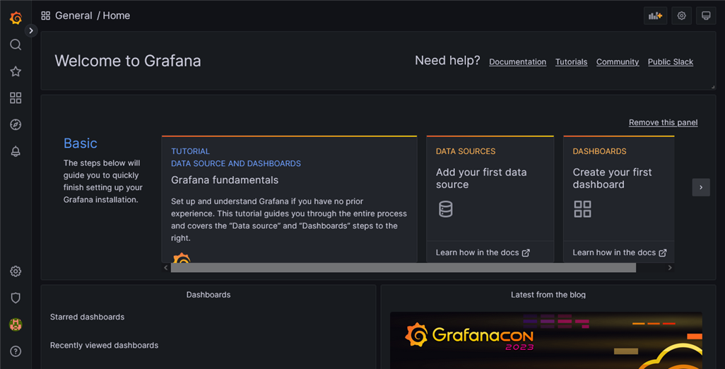

Then, Grafana GUI were accessed at
http://panda_address:3000
(initially log-in using admin:admin)
displaying startup screen

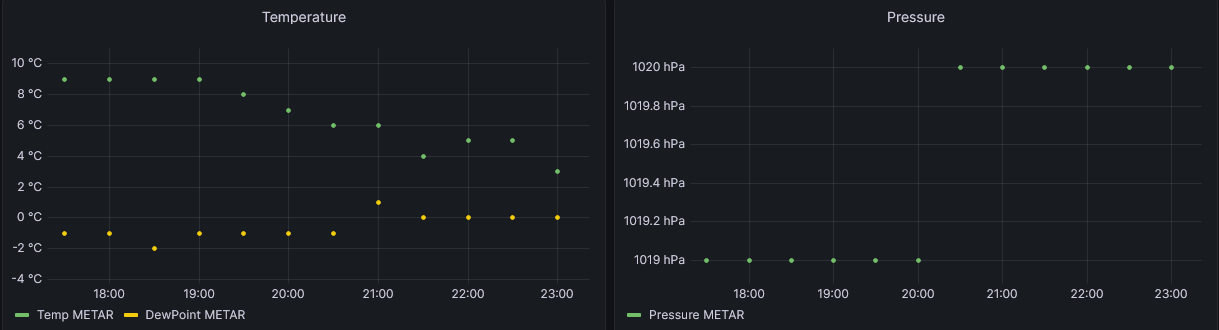

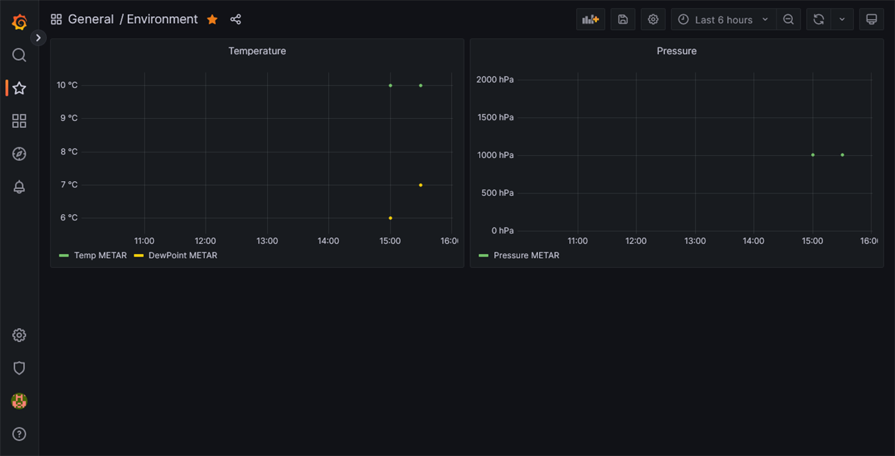

Now, as we have our first data, let's graph it. We will need to create datasource for local InfluxDB instance, then create some graphs. Graphs are created using panels and grouped by dashboards.
And our first graphs will look like this
Now we have created a simple weather station gathering data from METAR reports for an airport nearbly.

First stage of my experiment was to put both of reference enclosures outside and check for moisture buildup (challenge kit didn't arrived yet at this time), hopefully observing condensation during high temperature variations of early spring . As relative humidity changes with temperature, and weather conditions caused daily temperature variations I decided to monitor dew point temperature - it should be constant assuming constant amount of water vapor inside (and dew point temperature change would indicate water vapor migration to or from enclosure). Simple? Well not exactly.
First lesson - do not leave sensor in place with direct sun operation possible:
As can be seen, in the enclosure temperature can easily exceed 60°C (despite overall low external temperature), exceeding - for example - LattePanda allowed temperature range of 0~60°C (reference - data from LattePanda support forum /challenges-projects/design-challenges/experimenting-with-waterproof-connectors/f/forum/52797/lattepanda-v-1-environmental-requirements-found)

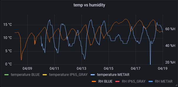

Long term monitoring of my "bad reference" enclosure showed that (assuming wet weather with frequent rain but installation protected from direct rainfall by placing under the roof) mean moisture level inside enclosure without proper sealing (gasket missing) constantly increases:
Taking into account daily temperature cycle (METAR temperature data plotted on the blue graph), it can be observed that internal RH increased from 60% to 69% (measured at points of constant external temperature of 10°C) during about eight days.Unfortunately weather got warmer before I was able to observe condensation inside (as I hoped).

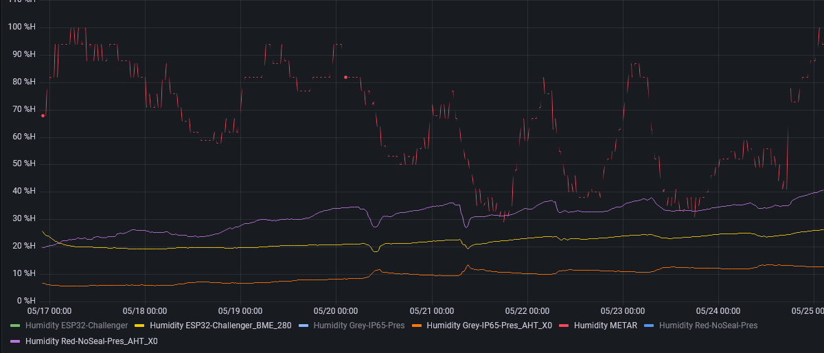

Next phase - install all three enclosures (including our DUT) with dehumidifier bags inside and start measuring:
After brief humidity drop caused by dehumidifier removing resident moisture, [rolling mean value of] humidity in all enclosures started to grow. As expected, with the fastest rate inside "bad reference" enclosure, but also - at lower rate - inside DUT and "good reference". "Good reference" started from lower point through - it seems that because of it's lower volume, dehumidifier was able to work more effectively.
Those results can be confirmed by the appearance of silica gel after the test
It can be seen that "good reference" gel looks like new, DUT is slightly darker and dehumidifier from "bad reference" is the darkest one. When comparing those three bags one should remember that DUT has a volume nearly three times of other enclosures, so it contained more moisture initially.
One can ask if conclusions from examining graph data are correct - temperature variations can influence relative humidity after all - so let's check actual readings at the same temperature level. I have selected temperature of about 15°C because it was present through all the test window - despite overall day-to-day temperature increase.
To take into account different volumes of enclosures, absolute humidity was also calculated (using calculator at https://www.omnicalculator.com/physics/absolute-humidity), then multiplied the air volume to obtain water vapor mass. Enclosure volumes were calculated earlier - in section of this document describing enclosures.
Remark - as temperatures inside each enclosure can be slightly different, not all data points are present in all enclosures.
Date Temperature Humidity "bad" Water vapor mass "bad" Humidity "good" Water vapor mass "good" humidity DUT Water vapor mass DUT
2023-05-17 01:13 15.82°C 20.9% 3mg 6.08% 1mg 22.06% 9mg
2023-05-19 15:56 15.53°C 30.35% 7.82% 21.1%
2023-05-21 03:31 15.44°C 35.71% 9.57% 22.43%
2023-05-23 02:25 15.45°C 36.49% 10.9|% 24.36%
2023-05-25 03:49 15.44°C 41.3% 12.74% 1.8mg 24.36%
2023-05-25 08:50 15.4°C 41.9% 6mg 26.43% 11mg
From this data we see that our Hammond enclosure fitted with six Amphenol connectors behaves even better than fully sealed "good" reference. But why? Trying to explain this phenomenon we will use data from additional sensor we have added.

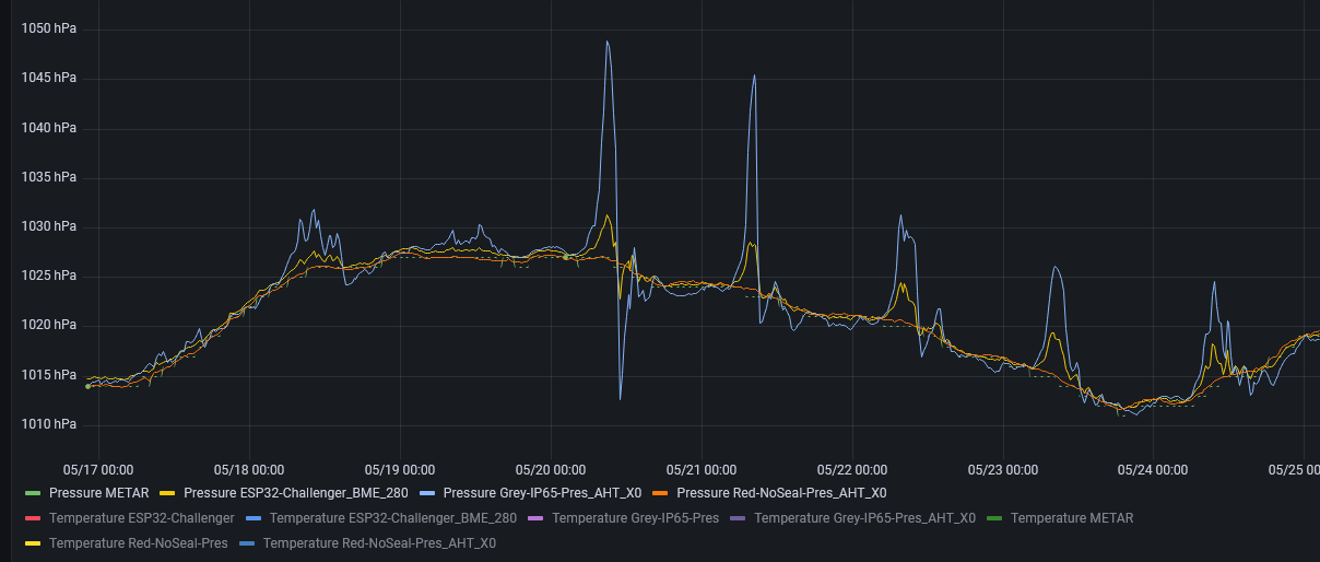

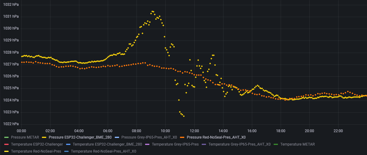

When we graph internal pressure of the enclosures we can see something interesting:
pressure graph
We can see that pressure inside our "bad" reference closely follows external pressure (green line - data obtained from METAR reports), but other two behave different.

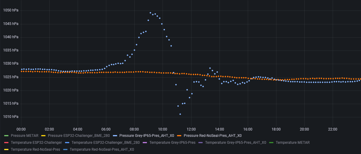

Most interesting is dataset from out "good" reference - when temperature rises, internal pressure quickly goes up (that is something expected - pressure of gas inside closed space increases with temperature rise). When it exceeds external pressure by about 20hPa, gasket fails and pressure lowers - what is interesting, it seems that to the level below external pressure, then starts to oscillate with decaying amplitude. That air exchange process can accelerate moisture buildup when external humidity is bigger than internal. Similar process is observable for my Hammond enclosure, but with far lower amplitude (it seems that one of gaskets fails sooner, preventing big pressure buildup and excessive air exchange).
Below there are graph fragments for the "good" reference (compared to the "bad" reference):
Pressure variations - good reference
then Hammond enclosure (compared to the "bad" reference)
pressure variations - DUT
The same process can be seen but with different magnitude - below those three series on one graph (with addition of temperature curve inside "good" reference enclosure):
good and DUT pressure
As can be seen, pressure drop is not caused by lowered temperature - it happens when temperature is still rising, which is additional point for the theory of failing gasket.
I have spoken with Kradex support about this phenomenon and they suggested installing pressure compensation plug to limit pressure buildup during day-night temperature variations. I have asked the same question to the Hammond support and got confirmation:
Yes, I would recommend trying a pressure compensation plug if there is moisture buildup inside.
We have one available that is rated up to Nema Type 4, 4X (IP66). Part # BDN4XN1
 The 1554VA2GYCL has a max rating of Type 6, 6P which is for submersion. If they need a higher rated plug, they will have to find one elsewhere, since we don’t sell it currently. It sounds like they aren’t submersing the enclosure, so the above plug should work for them.
Such plug looks like this:
pressure compesation plug
and as far as no submersion is expected, it can allow for further limiting of moisture buildup inside the enclosure. There are also third-party pressure compensation plugs rated for IP67/IP68 if required.
