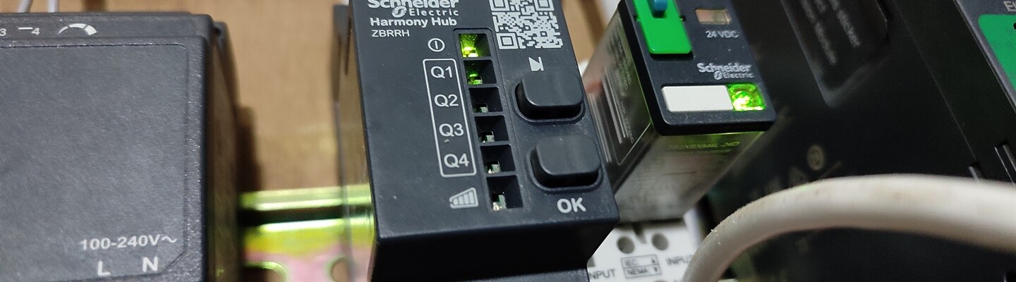

Controlling the relay
The 24V relay(782XBXM4L-24D) can be controlled remotely from PLC using Harmony hub receiver module(ZBRRH). This relay can eventually turn on/off the motor to control the water flow in the respective tank. It is possible to control upto 4 relay modules given that power supply can provide enough power to control these relay coils. The following image shows Q1 output of ZBRRH is turned on that is connected to the relay module.
The question here would be how one can turn ON/OFF respective outputs(Q1.....Q4)? These outputs can be turned ON/OFF by writing to respective Modbus registers.
The following values are possible as per the user's guide
  • 0x00 -- Output off
  • 0x5A -- Output blink
  • 0xFF -- Output on

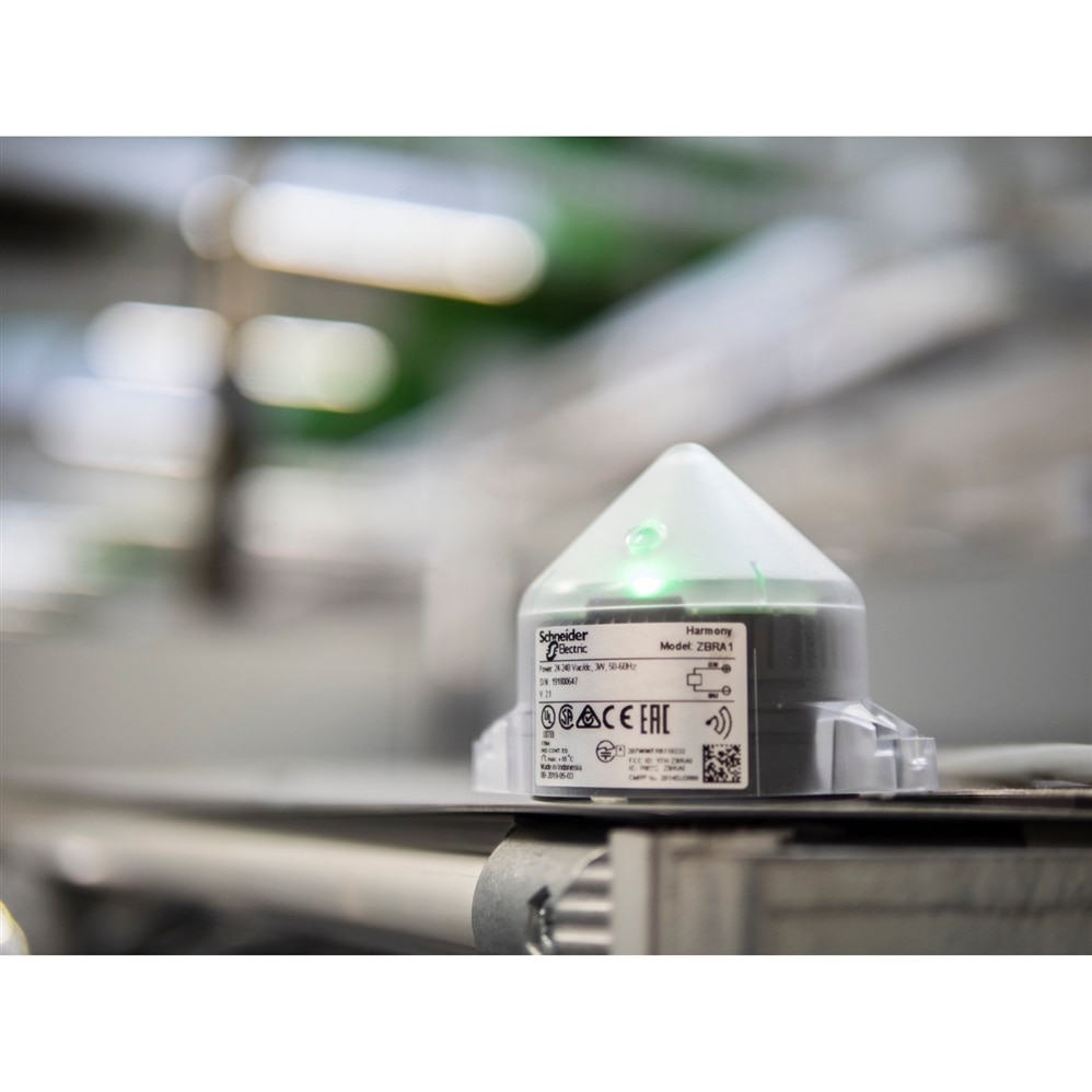

ZBRA1 Antenna
ZBRA1 is the antenna that can be used to increase the signal transmission range. The antenna is capable of handling varied voltage range from 24....240 vDC/AC. It comes with 5 meters of cable wire and can be easily mounted on to surface. Harmony Hub(ZBRN2) has association process to link the antenna to the RF channel.
