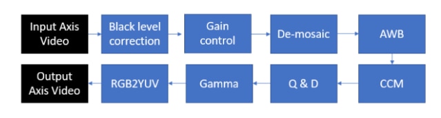

About Image Sensor Processors (ISP)
Images captured by a CMOS/CCD image sensor are monochrome in nature. To generate a color image, three primary colors (typically red, green, and blue) are required for each pixel. Before the invention of color image sensors, the color image was created by superimposing three identical images with three different primary colors. These images were captured by placing different color filters in front of the sensor, allowing a certain bandwidth of the visible light to pass through.
Modern sensors capture images with only one color/pixel called Raw or Bayer Images. To reconstruct the image, Image Sensor Processors (ISP) interpolate the values of the three primary colors (RGB) for each pixel using a Debayer function.
Debayer is also called Demosaic and is the minimum function required of an ISP. Additional ISP image enhancement functions include: noise reduction, stuck pixel correction, 3A algorithm to adjust for light conditions, gamma and color correction.
The Bayer arrangement of color filters on the pixel array of an image sensor. Each two-by-two cell contains two green, one blue, and one red filter (Wikipedia)
ISPs transform raw Image sensor output to a usable picture. All ISPs have tradeoffs according to application: Mobile phone ISPs are designed to enhance human attractiveness in selfies, traditional DSRL ISPs are optimized to produce images for a variety of subjects, automotive ISPs are designed to deal with difficult lighting conditions and PC and tablet ISPs are designed for video conferencing.
Using an ISP intended for another application further degrades performance. ISPs manipulate image data to produce images that appear more suitable for the task: color manipulations, local & global tone mapping, skin smoothing, sky enhancements, etc...
Xilinx Demosaic IP Core
Xilinx includes a Demosaic (Debayer), Color Correction and Gamma LUT useful for reconstructing raw images to RGB or YUV images (PG286 and PG285). It does not include advanced functions such 3A Algorithm or noise reduction. It comes with both Linux and Bare metal drivers.

    @javagoza You, Sir, are a fast learner! :) Glad to see you're making progress fast! Looking forward to your completed project!
    Btw, I do wish there were an IP block with the "3A Algorithms" implemented. I came across this issue last year when I tried to use a RPi v2 camera with the Zybo (Zynq 7020 based).
    Embedded Diaries: Hacking RPi camera for use with Zynq FPGA - Hackster.io
    The PCAM-5C comes with a built-in ISP that handles the auto exposure and color balance. On the other hand, many newer cameras expect the host system's ISP to do the same. This creates an issue when you're using them with an FPGA.
    For now, with the PCAM-5C you don't have to worry about it. Good luck!
