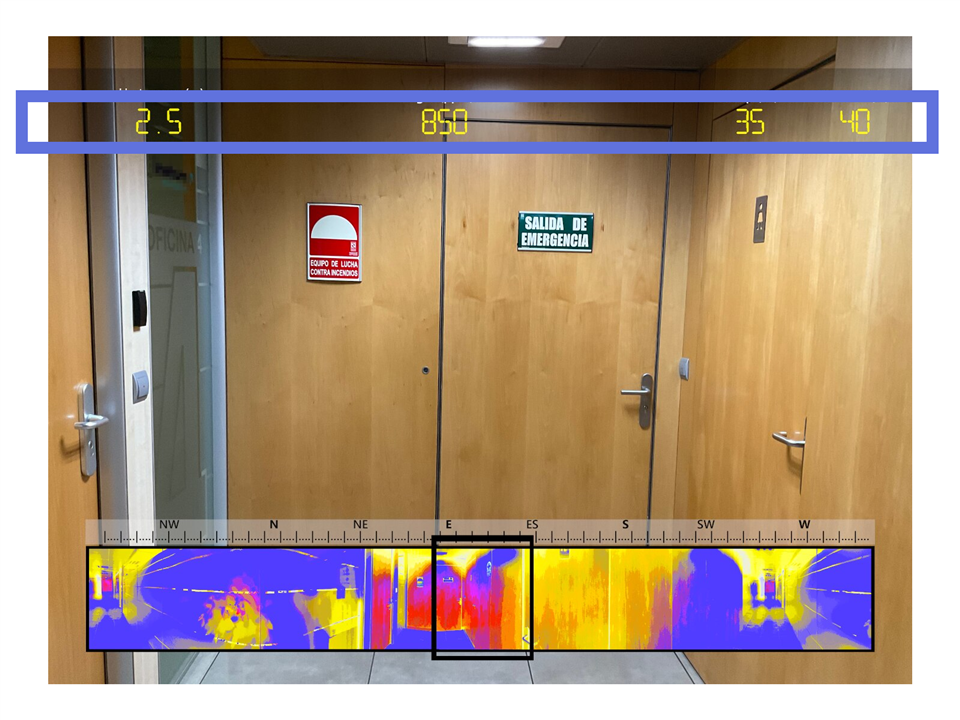

Motivation: Virtual 7-Segment Display
In my work plan I have planned to create a monitor with several virtual 7-segment display modules. In total, the module will have the capacity to display 16 digits of 7 segments in real time, grouped into four different modules, in order to display four different sensor measurements. In addition, this layer will have a graduated linear axis of the magnetic compass that will indicate the current magnetic orientation detected by the magnetometer.
The Spartan-7 SP701 FPGA Evaluation Kit Demo Project designed by Adam Taylor is a good reference to learn about the video mixers and video overlays. I'm going to study the Adam Taylor's example, rebuilding the example from scratch and updating it with the latest version of Vivado and the latest versions of the imaging processiong IPs included in Vivado and Vitis HLS.

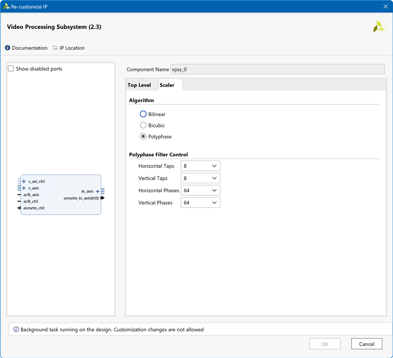

    There are two Video Processing Subsystem blocks. One is in charge of scaling the image for a MIPI DSI display
    Video Processing Subsystem IP. Scaler Configuration
    The example is designed so that you can change the video output to an HDMI monitor or MIPI DSI display, by pre-scaling the image.
    Video Processing Subsystem. Scaler Configuration 2

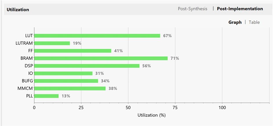

    saadtiwana_int , thanks for commenting and for the suggestions. I will review this weekend what you say about the use of LUTs. During the week it is difficult for me to find time for the project.
    The design I have worked on is the reference example of the MIPI CSI rx block.
    This example already consumes 67% of the LUTs

    Btw, I noticed you're already at 70%+ utilization on your LUTs. I am wondering which IPs are your major contributors to this high resource consumption? My guess would be that your VPSS is taking up a huge chunk. Unless you REALLY need it, you can remove it, or use the minimum configuration for it that you need. It's an HLS based IP, which tend to consume more resources than their pure-HDL counterparts.
    I have experienced that once you start touching 80% utilization, place and route can start to fail as there are no more slices available.
