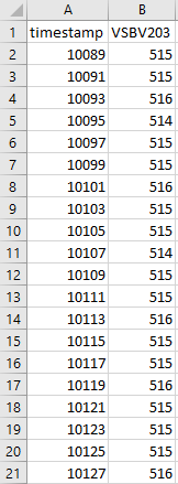

CSV File Idle_0.csv
Timestamps are 2 ms apart - 500Hz.

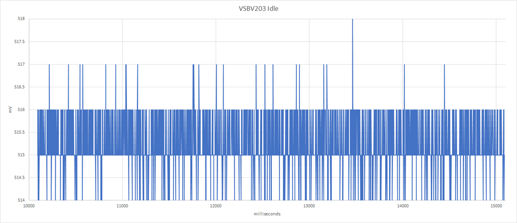

Plot of Data Sample (5 seconds - 2500 points)
Noise floor is around +/- 1.5 mV.
